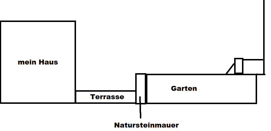

Yes, that is our final height. Our garden will then be fairly level, and then it drops by 1 meter (3 feet) down to our house/terrace.Drops? How should I picture that? How does the water runoff behave when it rains heavily?That’s right, that would be about 10 sqm (108 sq ft), so around 5,000–6,000€!
Here are my basic Paint skills to show the rough cross-section! (at least how it is planned, the terrace and my wall are not finished yet)
Not much happens during heavy rain; I’ve milled everything and planted cover crops to make the clay soil permeable.
