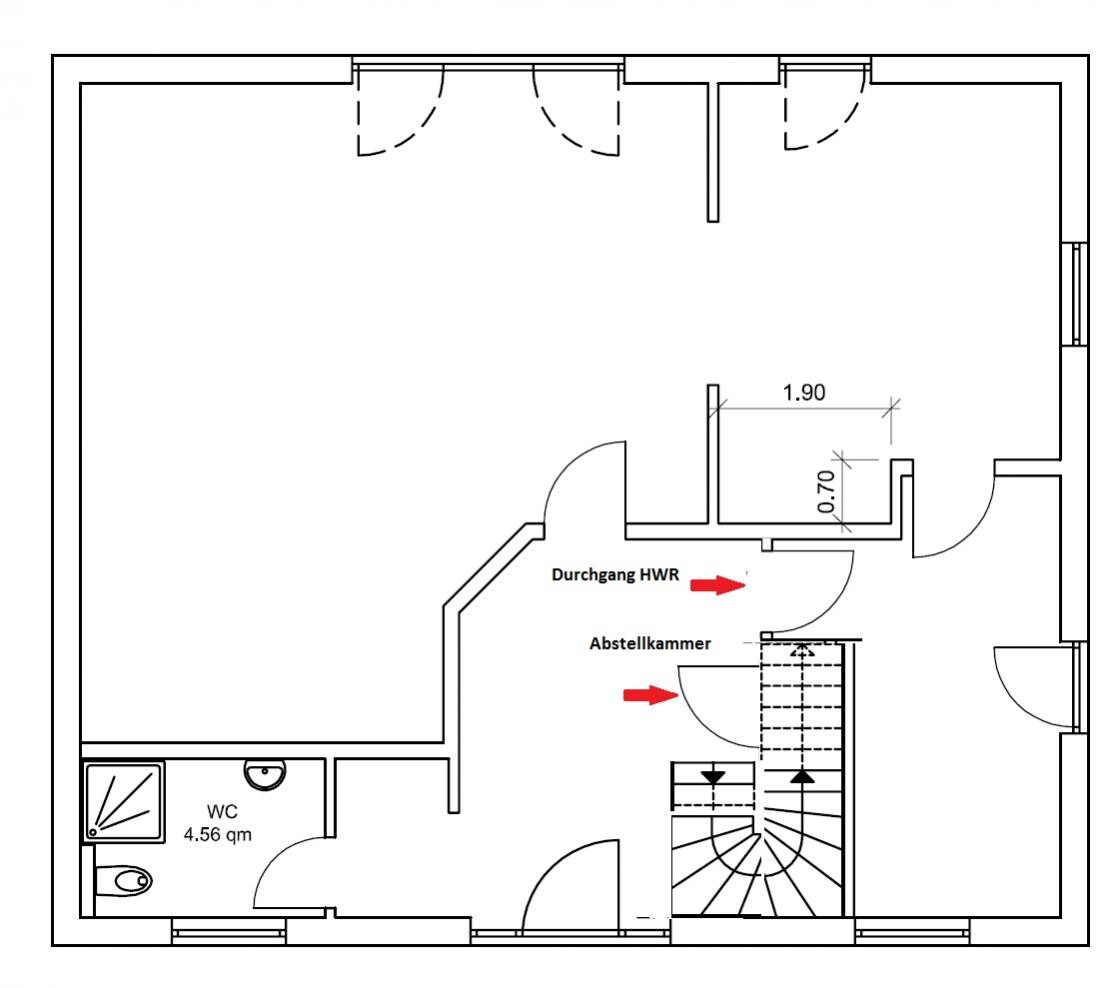

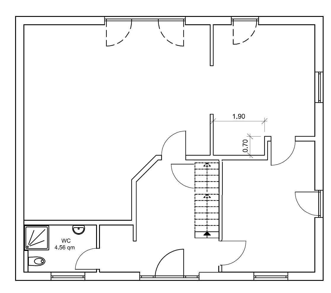

We are building a city villa, 180 sqm (1,938 sq ft) according to residential space requirements, and we are currently struggling with the floor plan for the ground floor. Attached are the first two draft sketches from our builder. Both are almost identical, except that in the second version, due to a larger kitchen, the door from the hallway to the utility room is positioned further under the stairs, which eliminates the planned storage area there.
Would you completely give up the access to the utility room from the hallway?
How advantageous or disadvantageous is the rather square shape of the living/dining area?

aytex schrieb:
Otherwise, I don’t even find it that bad that the staircase is right next to the entrance; I’ve often seen that in show homes...Not everything installed as standard in show homes has to be practical. Having a staircase immediately at the entrance is unpleasant. Expect that dirt from the street will be tracked in near the door and not cleaned constantly. It will then be carried upstairs on socks, and so on. Sloped walls should only be a last resort when no other options are possible. The living and dining area will be difficult to furnish, as it is almost square. You should also consider that visitors may come only for the wife, husband, or child—not the whole family—and then will inevitably have to take part in the rest of family life. Open and spacious living concepts can be designed more effectively, for example with L-shaped layouts or like those in Northern Europe... I generally like this design. But don’t expect your home builder to create a better design for you. Therefore, think carefully whether the design fits your life, also after 5 or 10 years and in everyday situations.
DerBjoern23 May 2013 11:49@aytex
I would definitely skip the door to the hallway. That way, you avoid having three doors in the utility room, which creates a lot of traffic space and reduces the available floor area. Especially if you want to use the utility room as a storage space, you can better place shelves there.

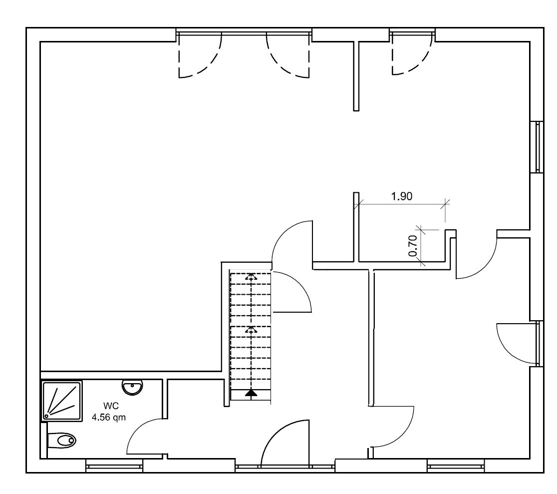

What do you think of these modified versions my wife and I have come up with?
@Bjoern
My wife feels similarly, but I’m afraid I will really miss having that short access later on. This door provides a shortcut to both the utility room and the kitchen. Also, we have a fairly large utility room. Not having a direct entrance to this quite spacious and useful room makes me uneasy…
Another question: Do you think a bay window in the dining area (so, just before the kitchen entrance) would help break up the square floor plan and create a better spatial separation between the seating area and the dining area? Although, of course, that would mean a considerable extra cost :-(

DerBjoern23 May 2013 12:06The question is from where you need this shortcut to the utility room? You can enter directly from the kitchen. From the living room, the route through the kitchen is rarely used and only slightly longer. From outside, people usually enter the utility room through the designated entrance, especially if the driveway is on the right side of the house. So, only the route from upstairs to the utility room remains. How often do you find yourself in the bedrooms and then need something from the utility room? That’s a difficult question. I asked myself the same, as I have a similar layout on the ground floor and came to the conclusion to do without access from the hallway.
