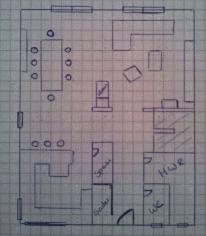

This is probably not quite finished yet, only about 95% of the ground floor of our semi-detached house.
The entrance faces the street, visible between the cloakroom and the guest toilet.
The space under the stairs is planned to be used in the utility room, for example for a washing machine.
The fireplace is just an idea. Most likely, it will be without a fireplace for cost reasons. The house dimensions are about 7.5-8 m (24.5-26.2 ft) by 10.5-11 m (34.4-36.1 ft).
Here on the ground floor, it’s mostly about the layout. Your ideas are welcome, including things we haven’t thought of yet.
I would appreciate your feedback. Thank you.

With all due respect, I agree with ypg. This really should be drawn to scale, using graph paper with millimeter (mm) grids. The interior doors are only minor obstacles compared to the front door, and if the dining area is about 3 meters (10 feet) wide, that leaves around 3.5 meters (11.5 feet) for the living room. The furniture shown would not have nearly that much space in reality.
An open floor plan like this is a matter of taste, but at least a vestibule door is practical to prevent the whole house from cooling down in winter whenever someone enters. The staircase as shown is not suitable.
As a very rough sketch, it’s okay, but not more than that.

Bauexperte5 Jun 2013 01:07Hello,
If you want to realize your desired layout, you need a minimum width of 11.00 m (36 ft 1 in).
Regards, Bauexperte

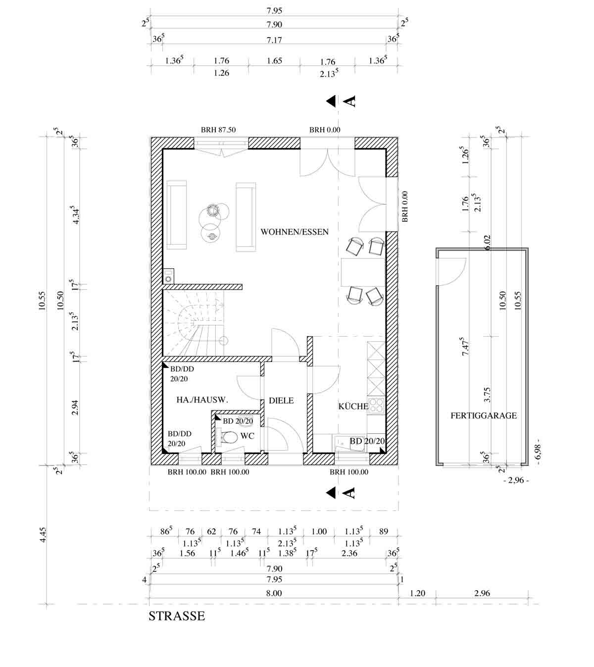

Alex80 schrieb:It’s less about convincing someone. More about the fact that one person—in this case me again—has to play the bad guy. I attached a ground floor plan 8.00 m x 10.50 m (26 ft 3 in x 34 ft 5 in); you can already see that your ideas for the entrance don’t work. Even here, the utility room is actually too small—I know what people put in there nowadays; it was really a matter of centimeters. And this semi-detached house is planned for 2 people; no more will be added :-)
Alex80 schrieb:Somewhere the weight of the upper floor has to be supported; this is quite difficult if there is no wall on the ground floor. Therefore, a beam—visible or concealed—must be installed to carry the load of the upper floor. The structural engineer will explain that to you soon enough :-)
Unfortunately, I don’t know what I’m supposed to understand by "beam".
Regards, Bauexperte

Hello ypg. I don’t understand. What won’t work? Do you mean we will have too many interior walls? RegardsIt’s not the number of interior walls, but their thickness. You planned the pantry to be 1 × 2 meters (3.3 × 6.6 feet). However, you have to subtract at least 30 cm (2 × 15 cm) (about 12 inches) from each side. That means you don’t have 2 sqm (21.5 sq ft) of pantry space anymore, but only 1.19 sqm (12.8 sq ft)! That is a huge difference and won’t work like that.
You also can’t just draw it 50 cm (about 20 inches) larger because it “roughly fits.” Walls make rooms narrower. It’s just how it is.
For those without background knowledge (structural engineering) and a basic plan sketch:
40cm (16 inches) exterior wall
60cm (24 inches) kitchen unit
120cm (47 inches) workspace
100cm (39 inches) deep counter corner
120cm (47 inches) passage
15cm (6 inches) wall
100cm (39 inches) room (cloakroom, pantry)
160cm (63 inches) corridor
130cm (51 inches) toilet
150cm (59 inches) utility room niche width
= 10.80 meters (35.4 feet) total width for the house frontage

@ Bauexperte and ypg and others. Thanks a lot. This sketch was just a rough draft—I had to start somewhere. But now, through your contributions, we are getting closer to the right room and house sizes. This means we will probably have to rethink the plan, possibly consider a side entrance...
We will only be able to build approximately 8 x 11 m (26 x 36 ft), and if I stick to the preferred rooms, it will be tight—I realize that now. Any ideas on how I could solve this differently? 😕
