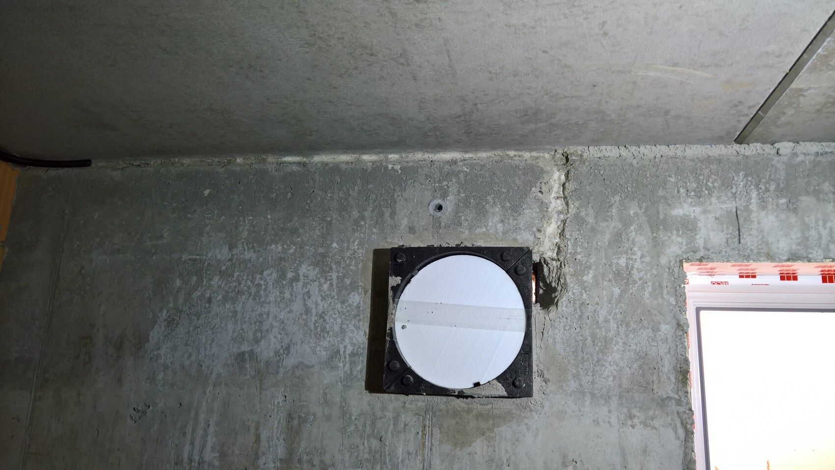

DReffects19 Jun 2017 01:12
Until now, fans were not really on my radar before the conversation with the Building Owners’ Protection Association, as I had assumed that the fan units, including the power supply, had been embedded in the structure… but that is not the case. Only the fan housings were embedded. During a site inspection today, the following became apparent:

Alex85
19 Jun 2017 06:26
Well, whoops.
It’s time to focus less on electrical outlets and more on identifying defects.
