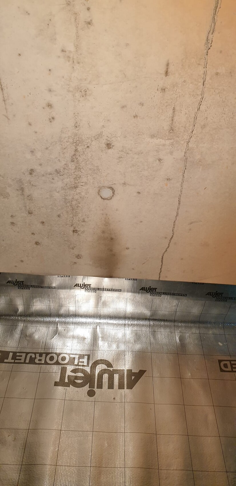

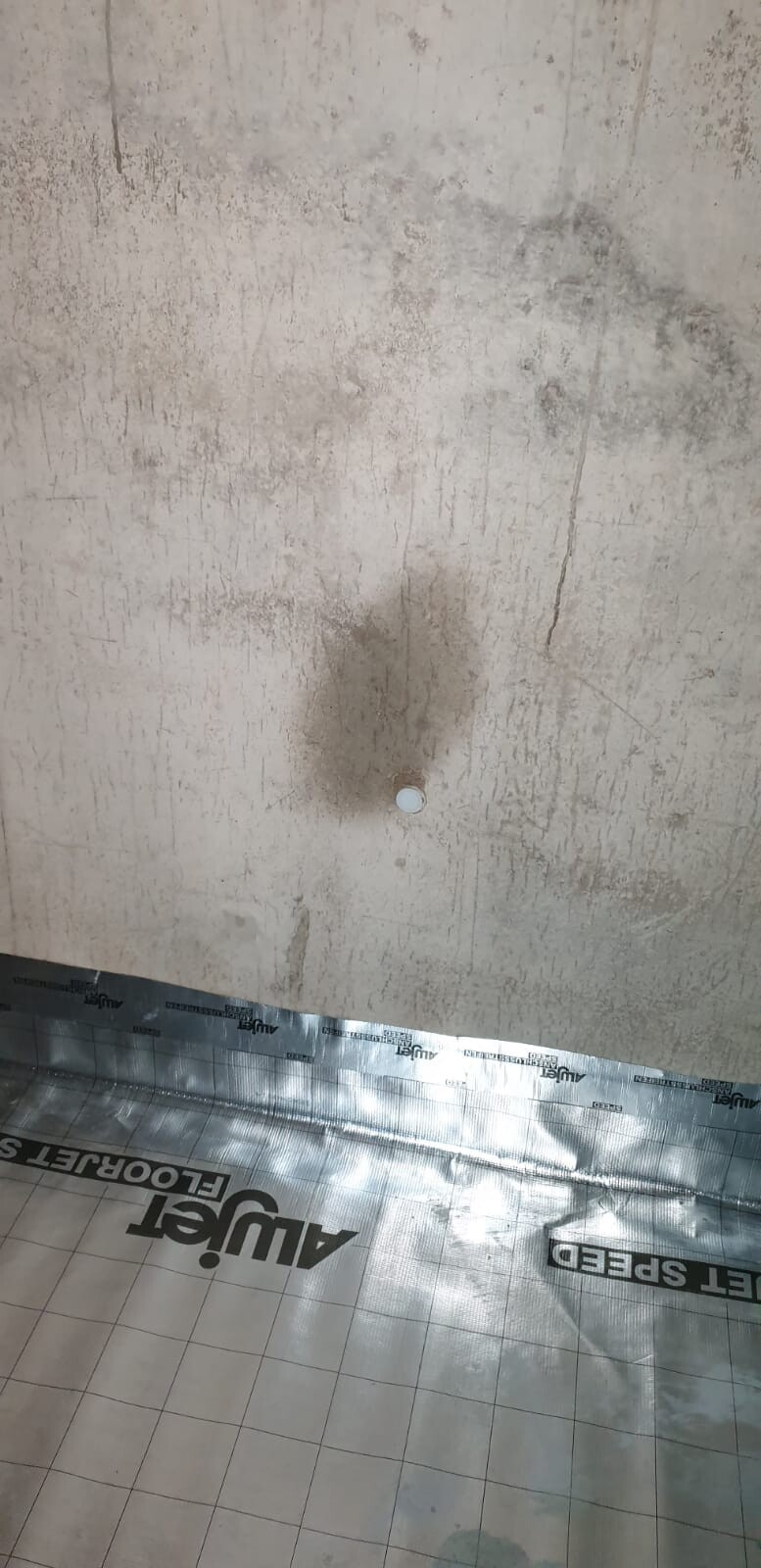

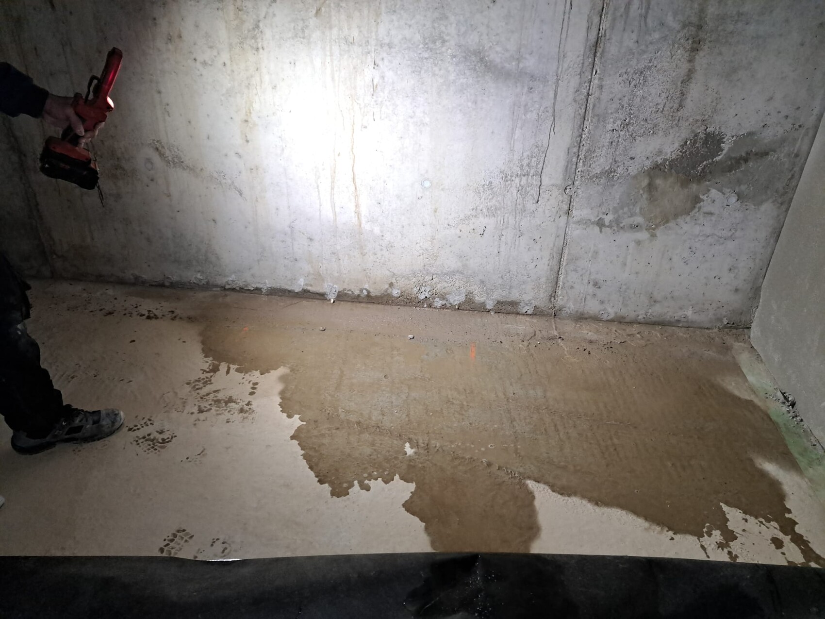

Now, the site manager and we have noticed damp spots on some walls. In one area, water seeped in slightly between the floor slab and the wall, causing a small puddle on the floor. In another area, water penetrated the wall itself (photos attached). Fortunately, the site manager acted quickly and has been following up to ensure “everything is in order.”
These spots were generously injected with sealant by a company responsible for supervising the white tank installation (one site about a month ago, the other about 2–3 months ago) and currently appear to be sealed. In one case, water leaked out during drilling of the wall; according to the employee, they had to drill through the joint protection or membrane (warning: not an expert) to ensure it was fully sealed.
During a recent site inspection, we found new damp areas and are now concerned whether it is normal that multiple injections are needed in different places so early in a new build with a white tank basement. Unfortunately, the basement has already been fully backfilled, and a “foil” (vapor barrier?) has been installed inside the basement, which, however, is only adhered to the wall.

Nasse Betonwand in einer dunklen Ecke mit staubigem Boden.
Kellerraum mit nassem Betonboden, Pfütze und feuchter Wand; Person hält rotes Akkuwerkzeug links.
Betonwand mit Riss, Bohrloch und darunter Aluminium-Isolierfolie.
Betonwand mit Flecken; kleine weiße runde Abdeckung; darunter Folie auf Fliesenboden.

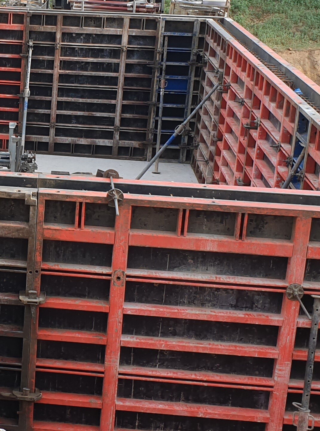

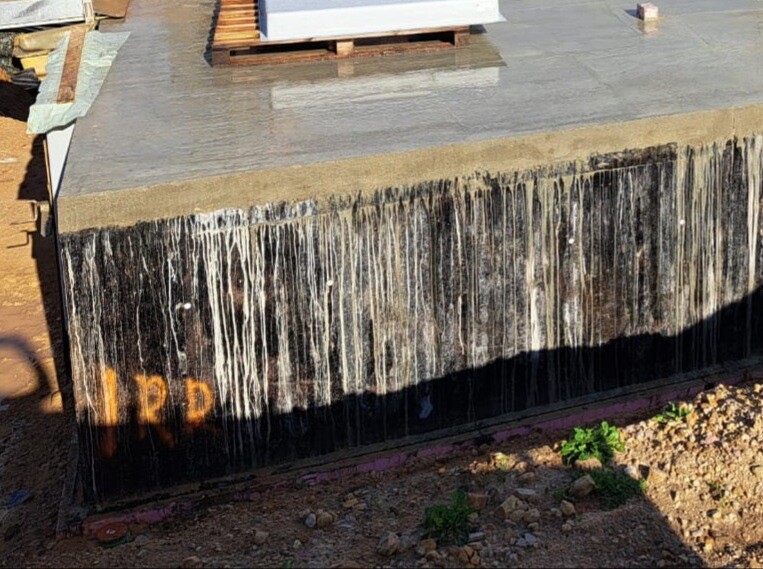

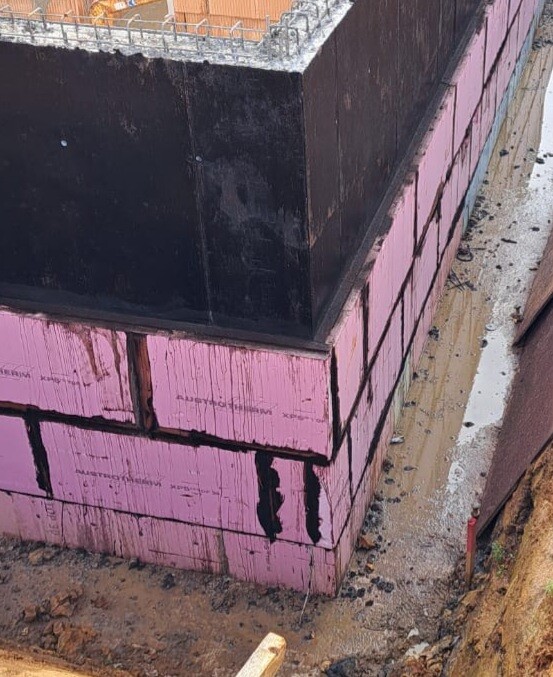

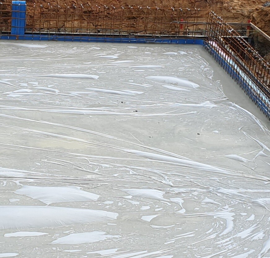

Attached are some photos.
Rote Stahl-Schalung und Gerüst rund um eine Baugrube; Stahlrahmen, Bolzen und Seile.
Baustelle: Betonboden bedeckt mit Plastikfolie, Baugerüste am Rand.
Fundamentbau mit pinken Styropor-Isolierblöcken, schwarze Oberabdichtung, Baugrube
Betonblock mit abtropfendem Wasser an der Seite und orange Markierung 12D auf einer Baustelle.

In one of the photos, I notice a blue tag attached to the steel reinforcement inside the formwork. These tags from the fabrication plant or steel mill should be removed before concreting or placing the reinforcement. Nobody noticed this during our work either. I ended up removing all of them myself (climbing around on the flatbed truck between crane lifts). A 12cm (4.7 inches) long plastic tag acts like a highway for water inside the wall. This issue is often downplayed because it “has always been done that way.”
