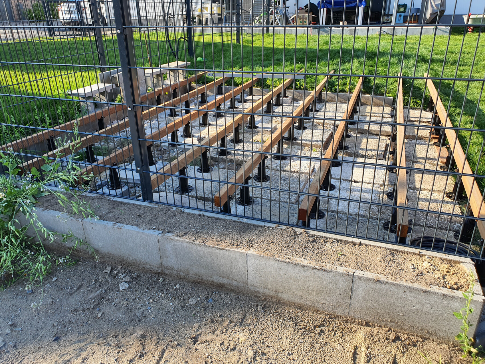

That works perfectly. I did something similar, but I first had to install exposed aggregate concrete slabs on the existing ground.
For a terrace about 4x4m (13x13 ft) in size, I used around 70 pieces. I believe fewer would have been sufficient (each pedestal has a load capacity of 2 kilonewtons), but I bought about 100 as a lot on a classifieds site for just over one euro each instead of around four euros. Great for adjusting the height. Most of the work was mixing and laying the slabs. You don’t even have that, so the rest will be very easy.
The pedestals themselves compensate for slight unevenness. I laid the slabs into the water as well as I could on short notice, but it wasn’t perfect. I also think that with WPC, rubber pads aren’t as important because of the plastic content.
