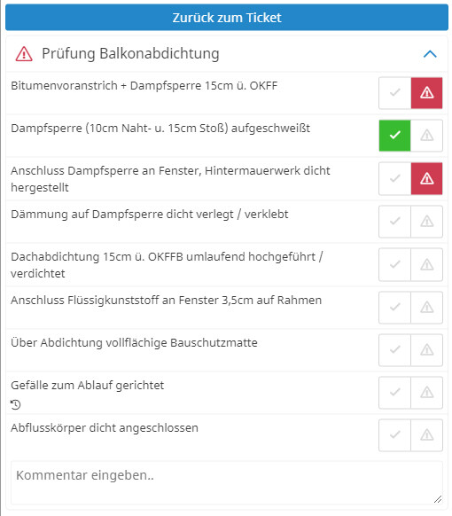

I am considering creating checklists and quick guides for "homebuilding novices" to provide a framework for basic questions about construction technology and expected quality levels, enabling people to form their own understanding.
Therefore, my question is whether this would be helpful to you and what scope such a resource should have in your opinion.

And what if the craftsman chooses a different (approved) type of balcony waterproofing?
Is the relevant standard linked for each point with minimum and maximum tolerances?
So basically, you want to summarize what tradespeople learn during years of training into simple checkpoints or workflows that a layperson can just check? I remain skeptical for now and will keep playing the role of the complainer here 😉
This was an example and refers specifically to this particular design.
In general, I would phrase it more broadly, but connection heights, for example, remain the same.
Criticism is always a prompt for a productive comparison 😉
However, I have noticed in my work that many do not possess this years of technical expertise, and changes in standards are not always learned.
