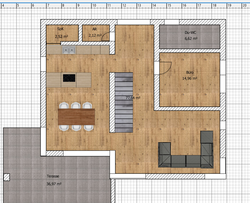

Additional wishes / special features / daily routine, also explanations why something should or should not be included
Who Designed it: Architect from a construction company
What Do You Like Most? Why? Side driveway to garage, direct access from garage to house, separate apartment concept, open ground floor design, upper floor is perfect in our opinion, gallery
What Do You Like Least? Why? Living/dining area is somewhat too large (wife worries it may be hard to arrange cozily), bedroom window position in the separate apartment is tricky, (north entrance → long access route for guests)
Preferred Heating System: Air-to-water heat pump + photovoltaic system + battery storage
If You Have to Cut Back, On Which Details / Extensions
- Can be cut: Office on upper floor, a few square meters in living/dining area
- Cannot be cut: Remaining room program
Why Has the Design Turned Out As It Is Now?
The room program was provided by us. Furthermore, many requirements and the plot itself influenced the design.
Why Was the Drawing Created in Sweet Home 3D?
The architect’s design is drawn to scale but not dimensioned, so I transferred it to SH3D.
What Is the Most Important / Fundamental Question About the Floor Plan, Summarized in 130 Characters?
What do you think of the floor plan? Any ideas on how to make the large living/dining area feel cozier?

I once visited a villa where the dining and living areas were open up to the roof ridge. On the upper floor, there was a library gallery. This feeling of spaciousness creates a real wow effect.

haydee schrieb:
Ypg, you are the floor plan expert, not me.
It does get quite dark. However, when I think about the “apartments” I was offered 15 years ago in Augsburg, this one is luxurious and bright.[emoji2]
As I mentioned earlier, try arranging dining and cooking areas in a clockwise flow.
There is far too little information for me to create a sketch.
I said it several times: elevation details!
Honestly, considering the rear windows of the secondary unit as well, a sketch doesn’t really make sense without those.

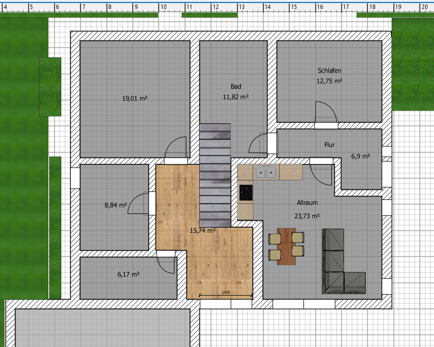

Small update:
We have decided not to build a granny flat / accessory dwelling unit, as this causes too many restrictions and we cannot accommodate all the desired features.
Thank you very much so far; your well-founded criticism has prompted us to rethink, and we are now glad to have made this decision.
I will get back to you as soon as we have a new plan.

ivenh0 schrieb:
We decided not to build a secondary suite because it would impose too many restrictions and we couldn't accommodate all our wishes.What kind of restrictions did you experience?With this sloped site, I inevitably see so much basement space being created that after allocating rooms for technical equipment and storage, there is still too much left unused. The design wasn’t optimized yet, but there is potential to improve it.
