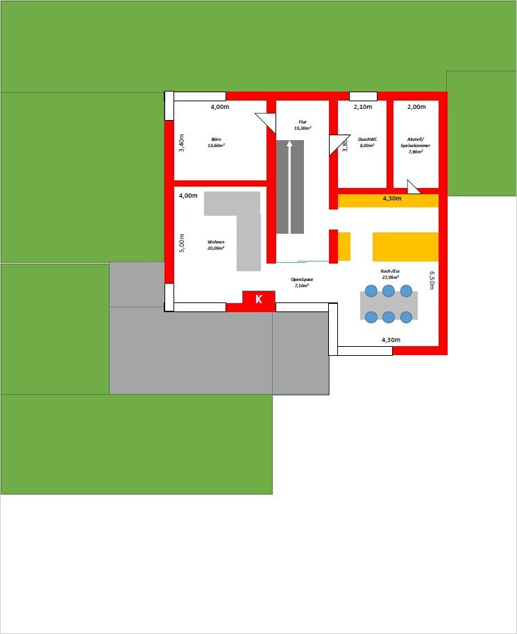

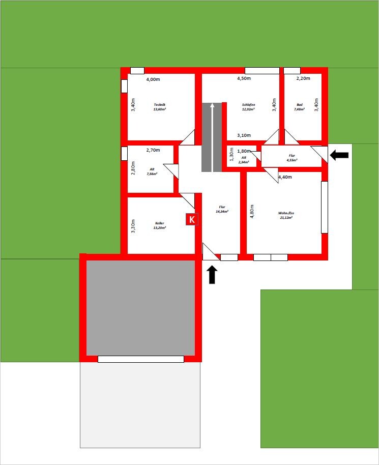

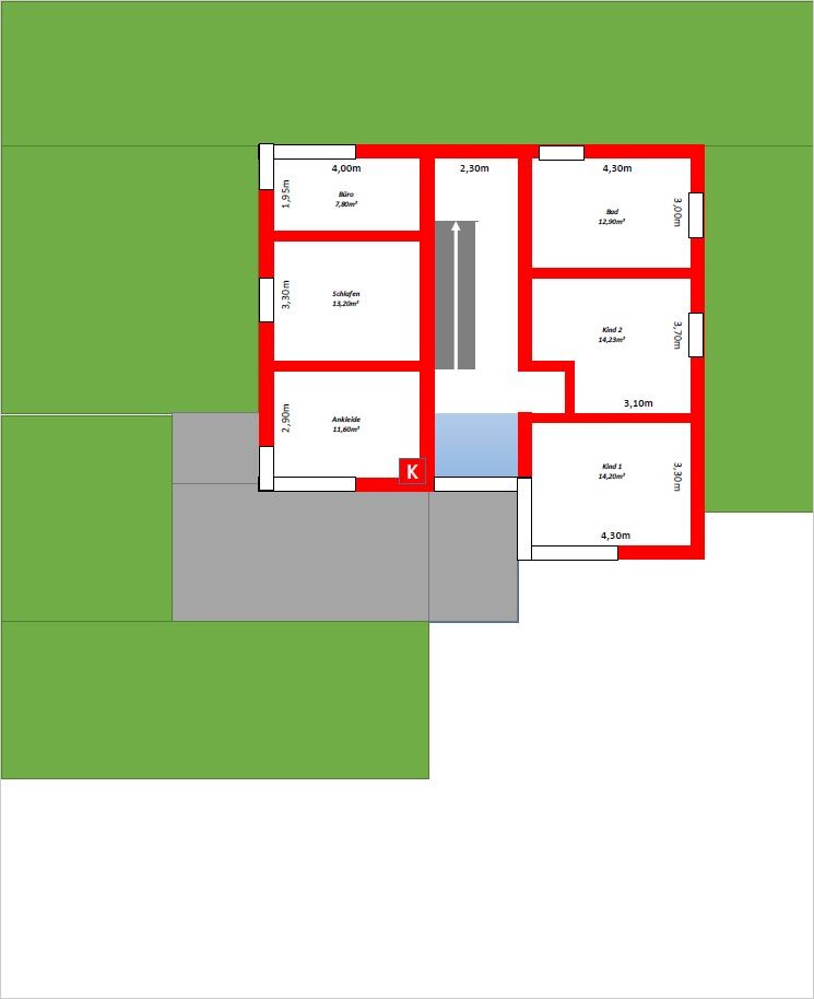

Why Was the Drawing Created in Sweet Home 3D?
The architect’s design is drawn to scale but not dimensioned, so I transferred it to SH3D.
What Is the Most Important / Fundamental Question About the Floor Plan, Summarized in 130 Characters?
What do you think of the floor plan? Any ideas on how to make the large living/dining area feel cozier?

ivenh0 schrieb:
Thanks in advance for the feedback. We are still not 100% satisfied with the entrance situation, but it is definitely much better than before. As shown in the sketches in #21, I already find it much more successful than before.
ivenh0 schrieb:
It would help us more if there were concrete suggestions for improvement along with the feedback. In that case, larger images would be helpful, I think.
As shown in the sketches in #21, I find it already much more successful than before.
Having the images a bit larger would be helpful for this, I think.Here you go:
As shown in the sketches in #21, I find it already much more successful than before.Entrance to the secondary apartment is not separate, but through one main entrance.
Small vestibule.
Straight ahead is the hallway/coat room area,
to the right is the entrance to the secondary apartment.
The cellar wall of the front room is shifted to the left. This way, you can create a coat area to the right in front of the stairs.
The living area of the secondary apartment is a bit larger as well. Not sure if it will be easier to furnish. The apartment will be quite dark; will it be approved as living space?
On the ground floor, kitchen, pantry, and office swap places, as well as living and dining areas. Possibly align the living room-wall to end flush with the stairs.
Upper floor:
I haven’t come up with the right solution yet. Is there a reason why the walk-in closet is so large?
I think there’s an imbalance if the bedroom plus walk-in closet are larger than a child’s bedroom.
Does the staircase need to be straight?
I would place a child’s bedroom where the walk-in closet is now. Then both children’s rooms would have nice, bright, and sunny spaces.
Remove the gallery.
Left side: children’s room and bathroom.
Right side: children’s room, walk-in closet, and bedroom.
Both children’s rooms slightly larger.
The gallery becomes an office.
Upper floor:
Remove the gallery.
haydee schrieb:
Entrance to the granny flat is not separate, but one main entrance
Small vestibule
Straight ahead is your hallway/wardrobe area,
Entrance to the granny flat on the right
Basement wall of the front room moved to the left. This way, you can create a wardrobe area to the right in front of the stairs.
The open living space of the granny flat is also slightly larger. Not sure if it’s easier to furnish though. The apartment will also be quite dark; not sure if it will be approved as a living space like that.
On the ground floor, the kitchen, pantry, and office swap places, as well as the living and dining areas. Possibly let the living room wall align flush with the stairs.
Upper floor
I haven’t found the right solution yet. Is there a reason why the walk-in closet is so large?
I feel it’s disproportionate if the sleeping area plus the walk-in closet is larger than a child’s bedroom.
Does the staircase have to be straight?
I would place a child’s bedroom where the walk-in closet is now. That way, both children’s bedrooms have nice, bright, and sunny rooms.
Remove the gallery.
Left side: children’s bedroom and bathroom
Right side: children’s bedroom, walk-in closet, and master bedroom.
Both children’s bedrooms slightly larger.
The gallery becomes an office.Yes, that’s an idea, at least parts of it. You shouldn’t lose sight of other options just because last week’s design was satisfactory; rearranging can eventually be considered good to very good.
However, I still see the issue with the light in the granny flat. The ceiling heights are unknown.
