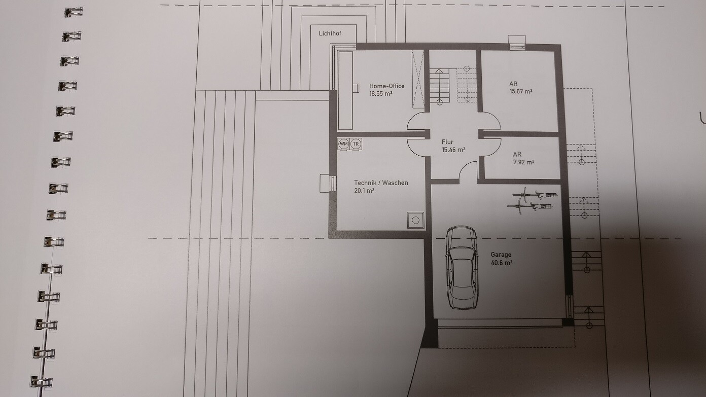

Basement, Floors: Basement with separate apartment + 2 floors

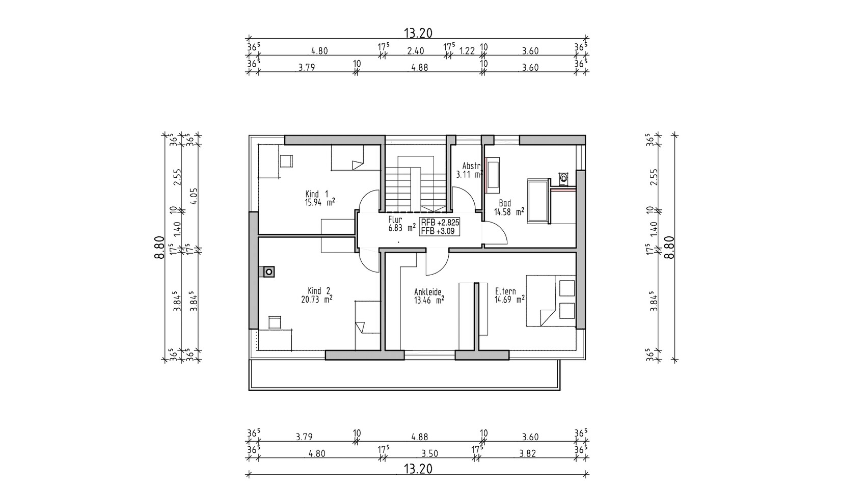

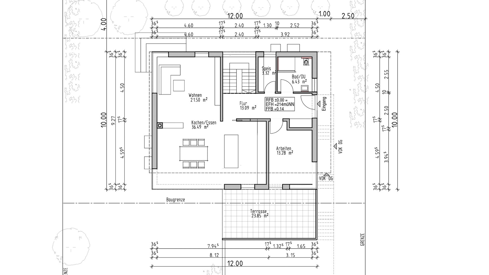

Room Requirements on Ground Floor and Upper Floor: Ground floor (office, living/dining/kitchen, shower-toilet, storage) Upper floor (2 children’s rooms, office, bedroom, bathroom, dressing room)

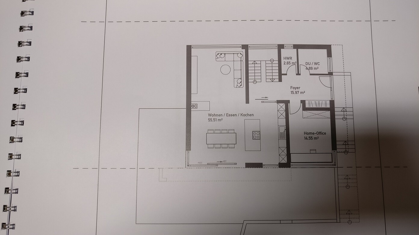

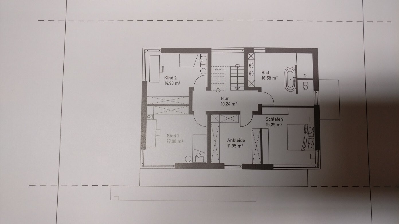

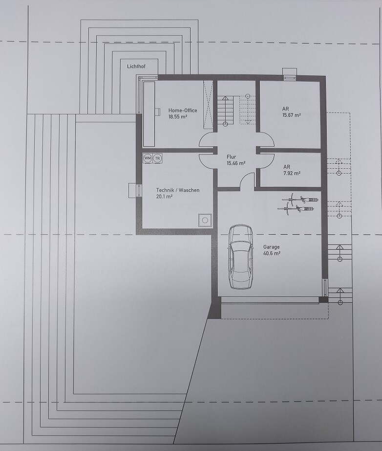

Additional wishes / special features / daily routine, also explanations why something should or should not be included
Who Designed it: Architect from a construction company
What Do You Like Most? Why? Side driveway to garage, direct access from garage to house, separate apartment concept, open ground floor design, upper floor is perfect in our opinion, gallery
What Do You Like Least? Why? Living/dining area is somewhat too large (wife worries it may be hard to arrange cozily), bedroom window position in the separate apartment is tricky, (north entrance → long access route for guests)
Preferred Heating System: Air-to-water heat pump + photovoltaic system + battery storage
If You Have to Cut Back, On Which Details / Extensions
- Can be cut: Office on upper floor, a few square meters in living/dining area
- Cannot be cut: Remaining room program
Why Has the Design Turned Out As It Is Now?
The room program was provided by us. Furthermore, many requirements and the plot itself influenced the design.

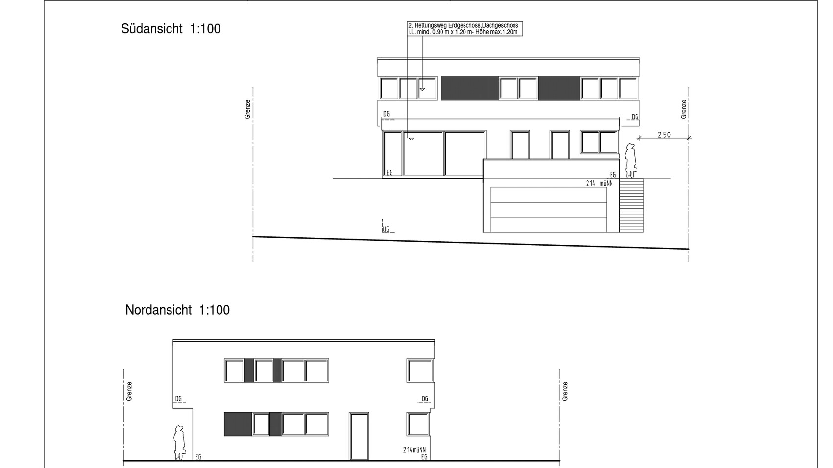

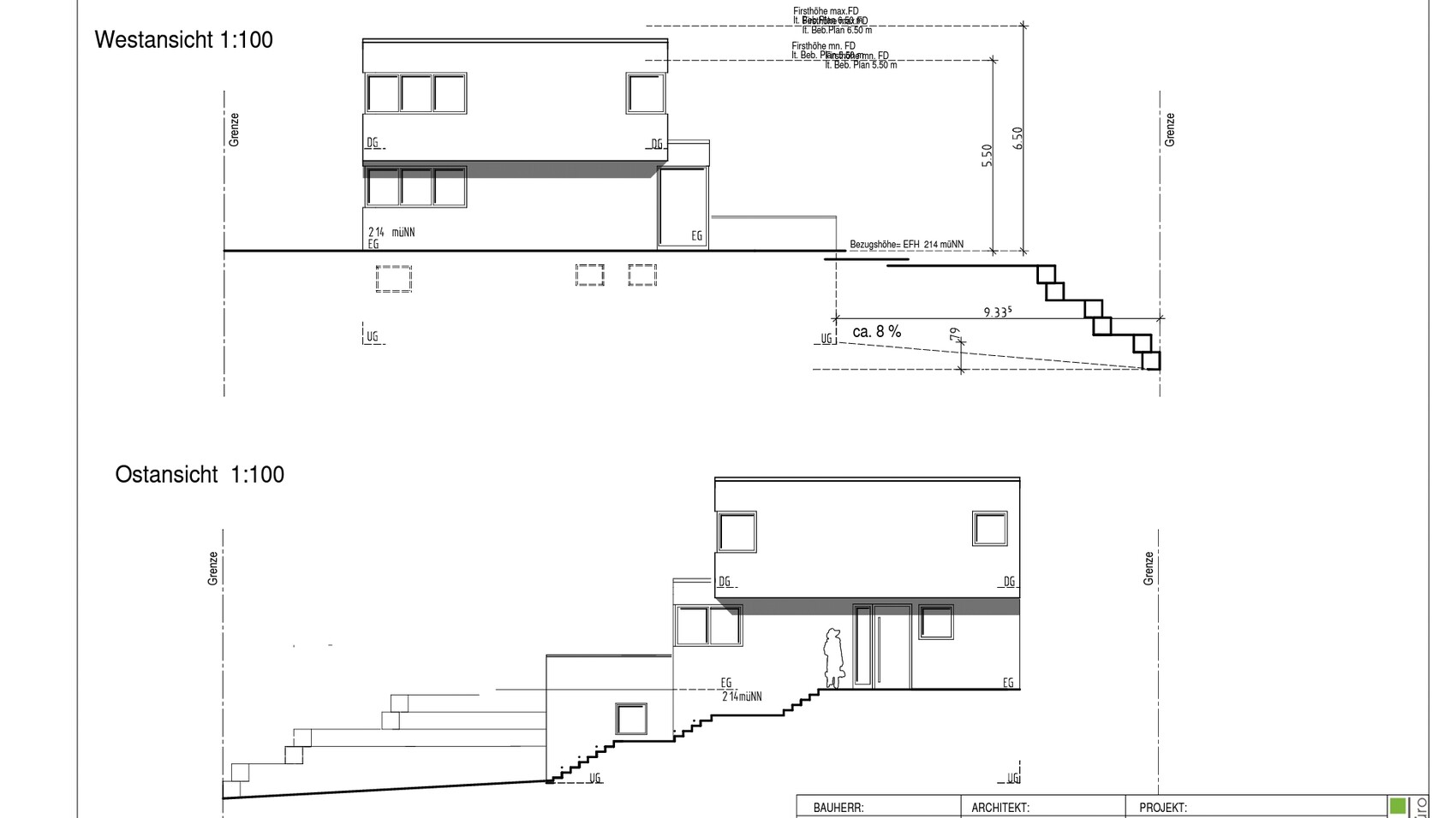

Why Was the Drawing Created in Sweet Home 3D?
The architect’s design is drawn to scale but not dimensioned, so I transferred it to SH3D.
What Is the Most Important / Fundamental Question About the Floor Plan, Summarized in 130 Characters?
What do you think of the floor plan? Any ideas on how to make the large living/dining area feel cozier?

ivenh0 schrieb:
We are currently considering adding a children’s bathroom on the upper floor. This means the existing bathroom would be smaller, and a children’s bathroom (shower, toilet, single washbasin) would be added.
What additional costs should we expect?Just estimate around 8,000–10,000...
Why have a children's bathroom upstairs at all?
There is already a shower on the ground floor. If you are planning for only two children, that should be enough.
I would rather invest the money in wood-aluminum windows.
My sister-in-law also has only one bathroom upstairs and a shower on the ground floor, with four children!
It seems that this is sufficient, at least for now.
As long as the children are small, I think it’s not a problem. Only later, it might become a bit challenging.
