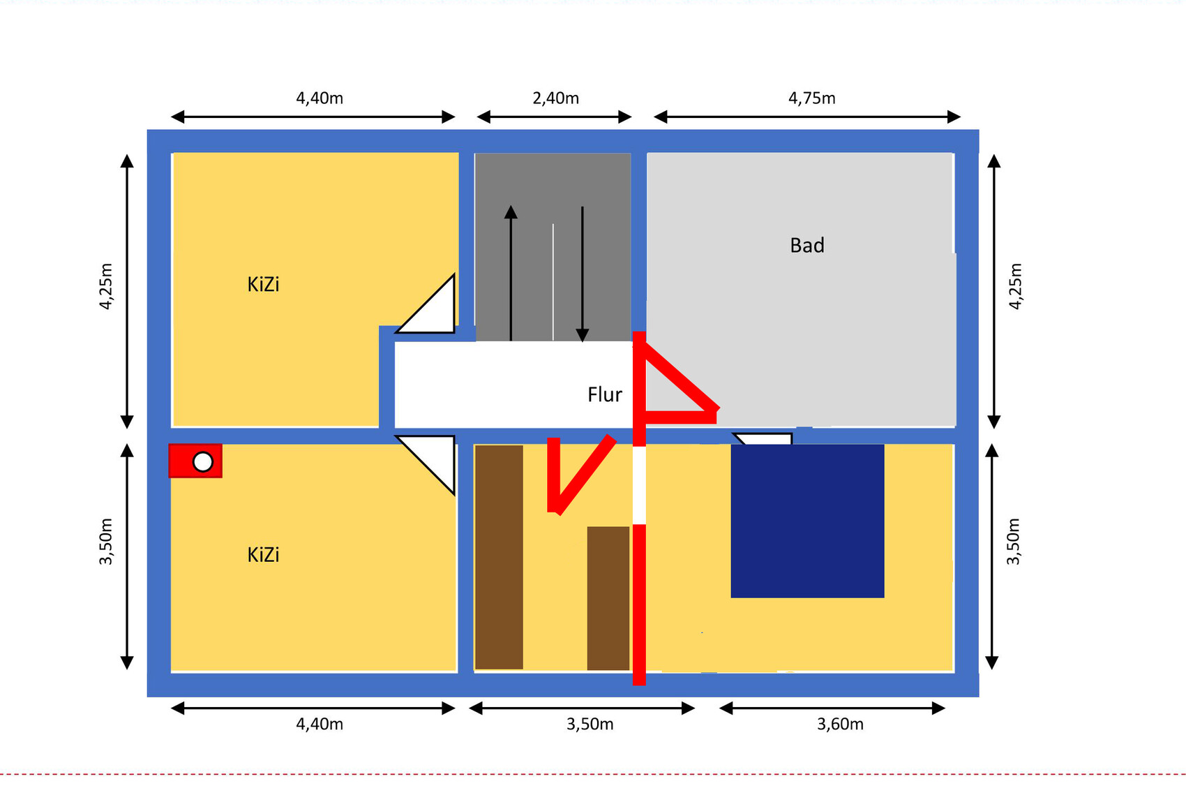

kaho6742 Jan 2018 11:55
Definitely an improvement, I would say. The walk-in closet and bedroom still need to be swapped, although I would also reduce the size of the walk-in closet and allocate more square meters to the bedroom. Then, of course, the corridor could be reduced as well, resulting in a very large bathroom. (Sketch(!)) This raises the question of whether the square meters could be rearranged differently so that there would be a master bathroom and a kids’ bathroom. However, with a house width of 7.75m (25.4 feet), this is not an easy task.

kaho6742 Jan 2018 12:15
Do we have an overhang on the right side according to the plan? Is that intentional? Some views would be helpful.

2 Jan 2018 14:42
kaho674 schrieb:
Definitely an improvement, I would say. The walk-in closet and bedroom still need to be swapped, although I would also reduce the size of the walk-in closet and allocate more square meters to the bedroom. Then, of course, the hallway could be made smaller, resulting in a huge bathroom. (Sketch(!)) This raises the question of whether the square meters could be allocated differently so that there is a master bathroom and a children’s bathroom. However, given the 7.75m (25.4 feet) house width, that’s not an easy task.
The hallway on the ground floor is a bit too narrow, in my opinion. Plan the kitchen cabinets – then you can see how many centimeters remain for the hallway.
Bedroom and walk-in closet will be swapped. The bathroom would then be approximately 20m² (215 sq ft) – somehow very, very large.
If the home office on the ground floor is used as a guest room or second bedroom, I would swap the utility/storage room with the shower on the ground floor so that you don’t have to go through the entrance vestibule to reach the small bathroom.
The measurements refer to clear distances between walls. Exterior wall thickness is 36.5cm (14 inches), interior walls 25cm (10 inches). We basically do not need a children’s bathroom. The hallway on the ground floor is 1.30m (4.3 feet) wide, in the entrance vestibule 2.50m (8.2 feet).

I
ivenh0
28 Jan 2018 20:47
Small update:
Tomorrow we will receive the offer for the latest floor plan from our currently preferred general contractor. Additionally, a second general contractor will also prepare an offer based on the floor plan.
Alternatively, we have a meeting on Wednesday with an architect through whom we would realize the house using a contract package system. The more I research and study the topic, the more I lean toward using a contract package approach. Let’s see how the discussions go.
