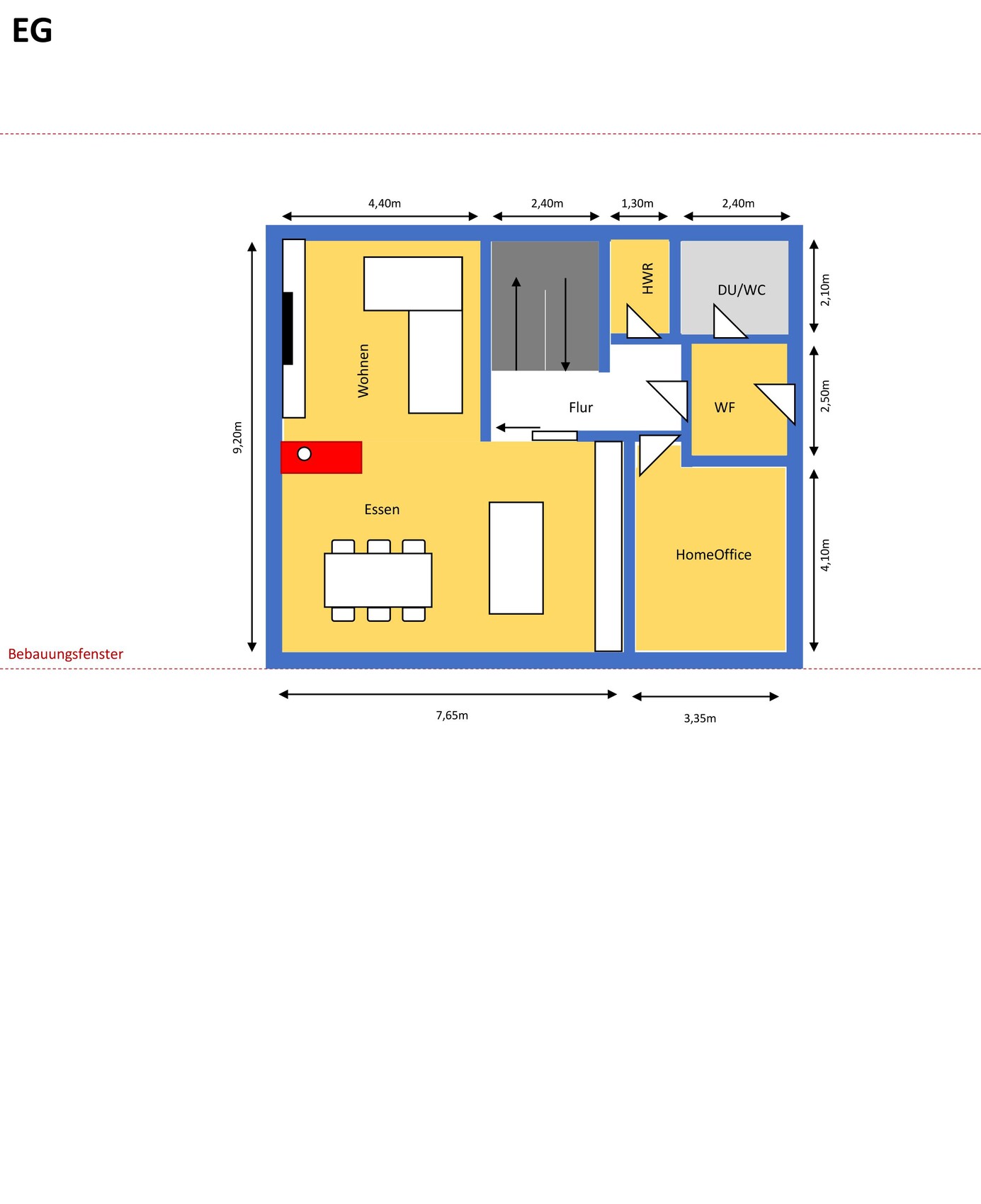

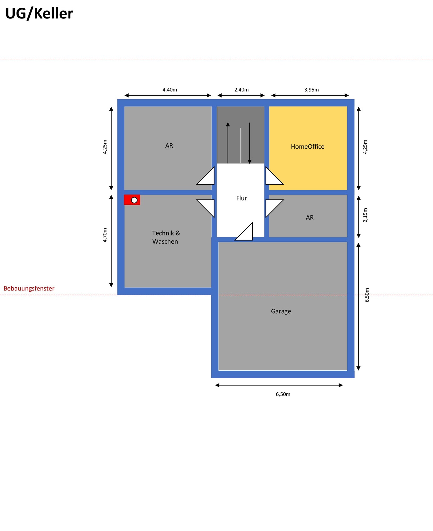

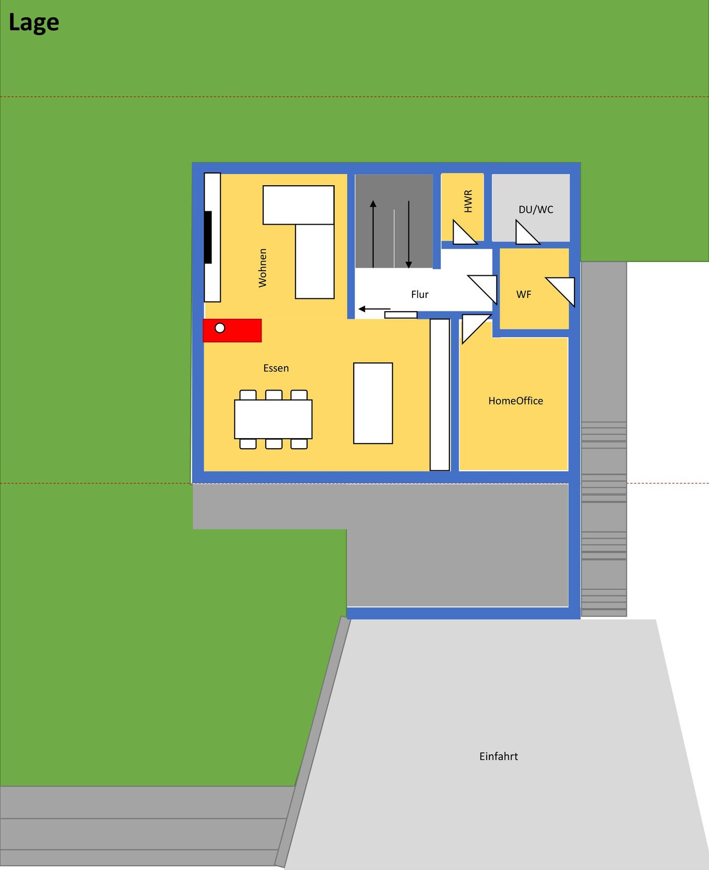

So, we have reset the design and tried to maximize the usable living space from the building footprint. Naturally, this led us away from a straight staircase and the open gallery.
Since we still want the staircase to look nice, we chose a reversing staircase with a landing. Just to mention upfront, the upper floor is set back and cantilevers to the right over the entrance area.
I’m looking forward to your feedback. (Windows are intentionally not included yet but should not be an issue.)

11ant1 Jan 2018 19:15
First of all, congratulations on taking this bold step. I find the doors placed directly against the wall in the children's rooms unfortunate, as this leaves no space equivalent to wardrobe depth between them. I can also imagine that perhaps the north child might prefer the home office, or otherwise there could be too much jealousy compared to the south child with the valley view.
ivenh0 schrieb:
Straight away, yes, the upper floor is set back and cantilevers to the right over the entrance area.
So, in front of the south child / bedroom / dressing area, is there still a roof terrace or at least a roof overlook? I think the cantilever is very much a matter of personal taste.
I
ivenh0
1 Jan 2018 19:39
First of all, congratulations on taking this bold step. I find the doors positioned directly on the walls in the children’s rooms inconvenient, as there is no clearance for wardrobe depth between them. Also, I could imagine that the child in the north might prefer the home office, or otherwise there could be too much jealousy towards the child in the south with the valley view.
So, in front of the south child / bedroom / dressing area, there is still a roof terrace or at least a roof overlook? – I think the cantilever is really a matter of personal taste.
Thanks for the feedback. We can easily swap the office and the north children's room in practice, no redesign is necessary, so I don’t see this as an issue. The point about the doors is valid; I see no problem shifting the door slightly in the northern children’s room. For the southern one, the dressing room would need to be shortened a bit and the children’s room widened, which is also doable.
Yes, on the south side there is about 1.20m (4 feet) of roof overlook. We consciously chose this for aesthetic reasons, since otherwise the house, due to its considerable height from the street, would look very block-like.
If that is the only criticism, we are quite relieved and hopefully on the right track.
11ant1 Jan 2018 19:48
ivenh0 schrieb:
Yes, in the south there is about 1.20m (4 feet) roof overhang. We chose this deliberately for aesthetic reasons, as otherwise the house would look like a block from the street due to its great height.
First of all, the room layouts have to be right. If the building’s appearance becomes "tamer" as a side effect, that is gladly accepted—but nothing more. I wouldn’t make any contortions for that.
From my side, so far yes.
ivenh0 schrieb:
then we are already very relieved and hopefully on the right track.
Yes, I see this as a positive step forward.

I agree with the praise for the new design, great job!
I don’t think a north-facing room is a problem since the sun won’t shine directly in, which could make it more comfortable for sleeping than a south-facing room. So, it doesn’t have to be a disadvantage.
I might consider swapping the dressing room and bedroom to provide better sound insulation between the master bed and the children’s room.
