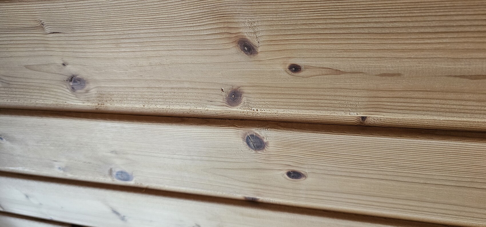

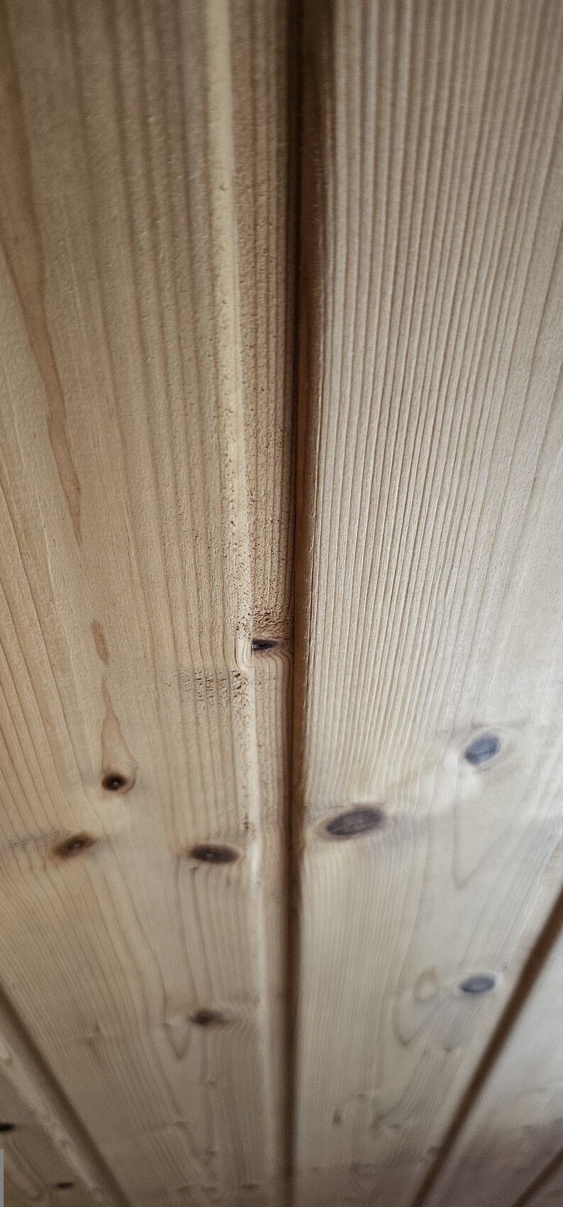

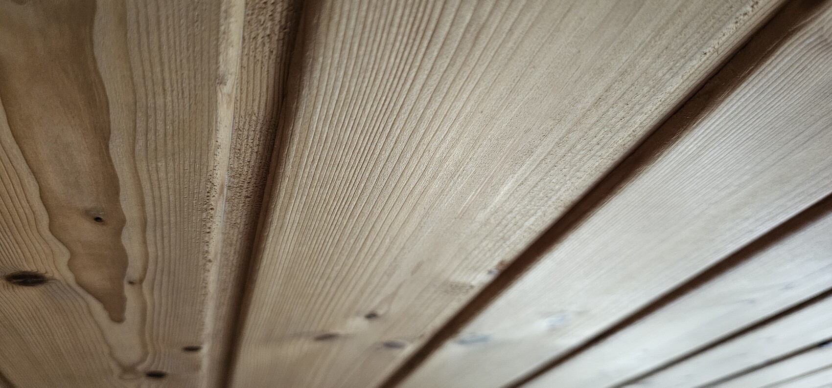

SpeedyGam16 Aug 2025 20:14Thank you for your responses.
We want the ceiling completely white, so unfortunately glazing is no longer an option.
I would choose the Jäger 319 Kronen.
I am attaching a photo of the panels.
Now my question is, how smooth does the wood need to be sanded? In some areas, especially in the grooves, the wood is quite coarse. Does it need to be completely smooth, or will the paint fill it enough so that it is not visible from below?
