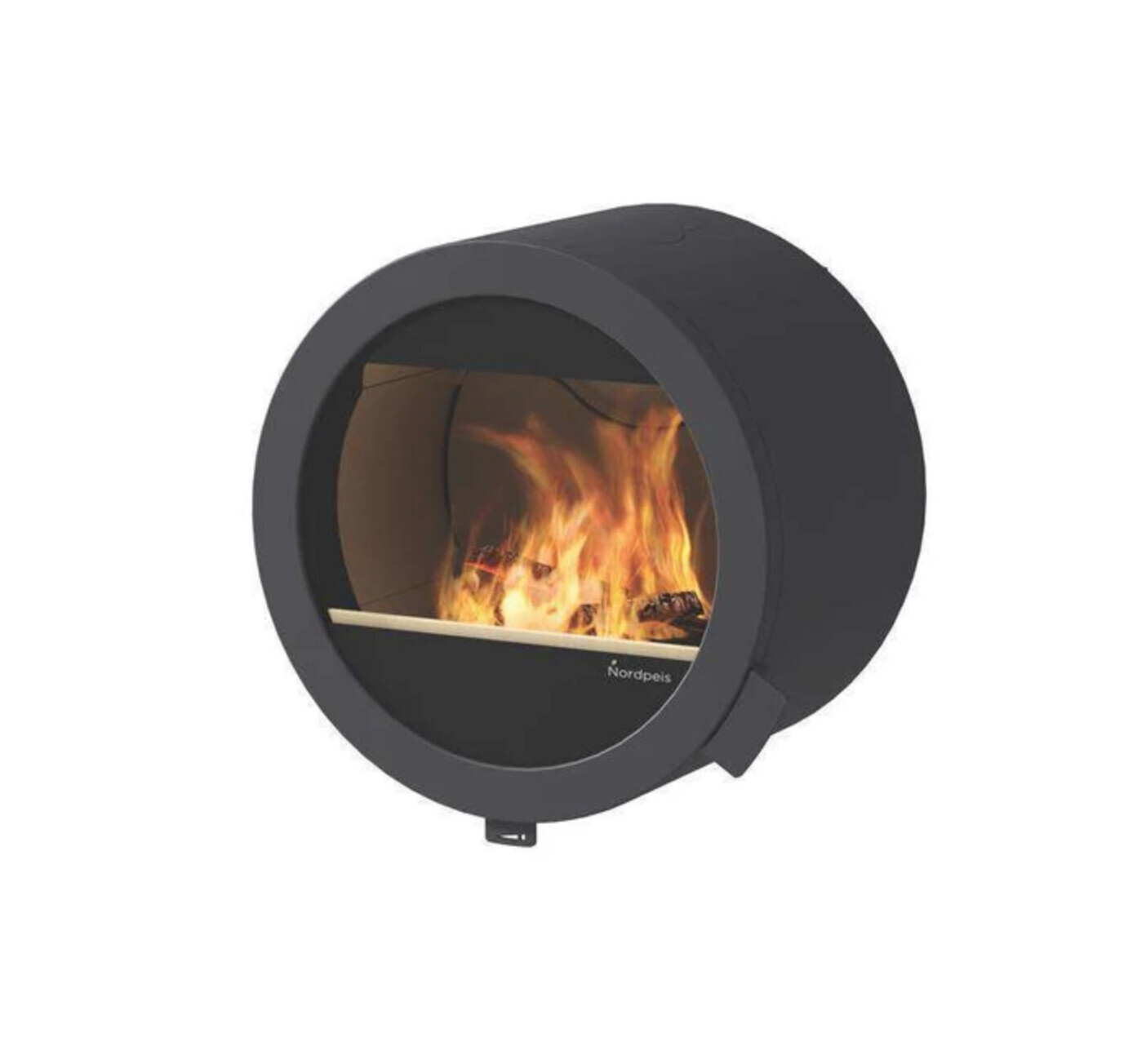

But now we will probably get this stove: Nordpeis ME Wall
Round dark wood stove with glass front, fire burning inside
… and then we'll see if it burns just as poorly with the same wood.
