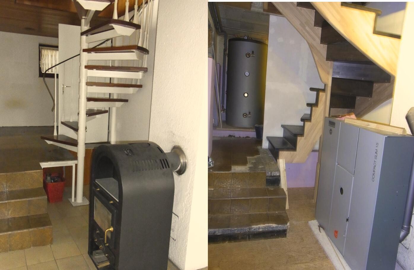

Elina schrieb:
A photo to illustrate (before/after). By the way, the staircase will also be covered on the side with gypsum fiberboard, so the stringers won’t be visible afterwards. Would you like to upload the picture here as well? I’m curious after your description, but I don’t see any image (the upload server doesn’t seem to work).
