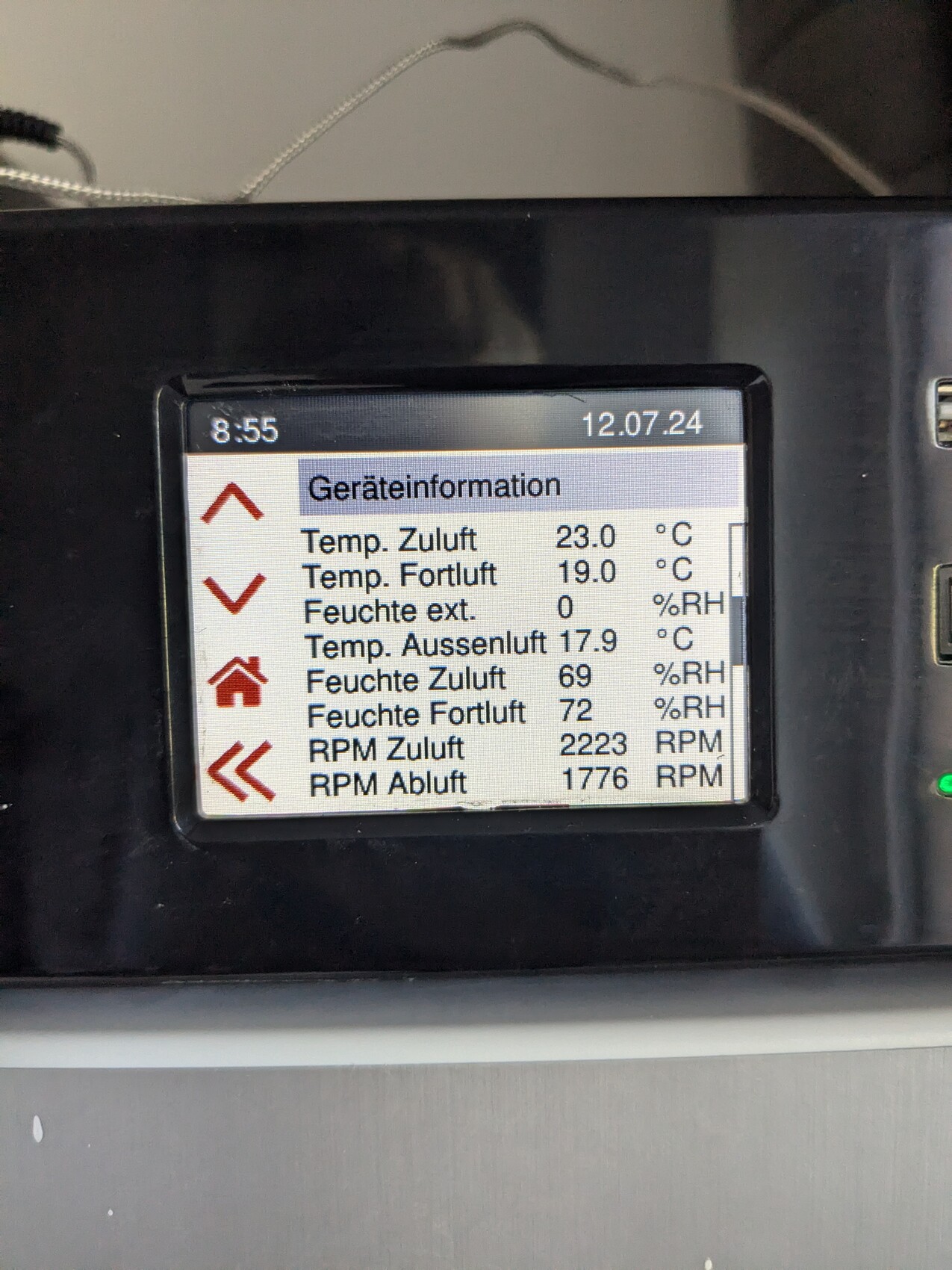

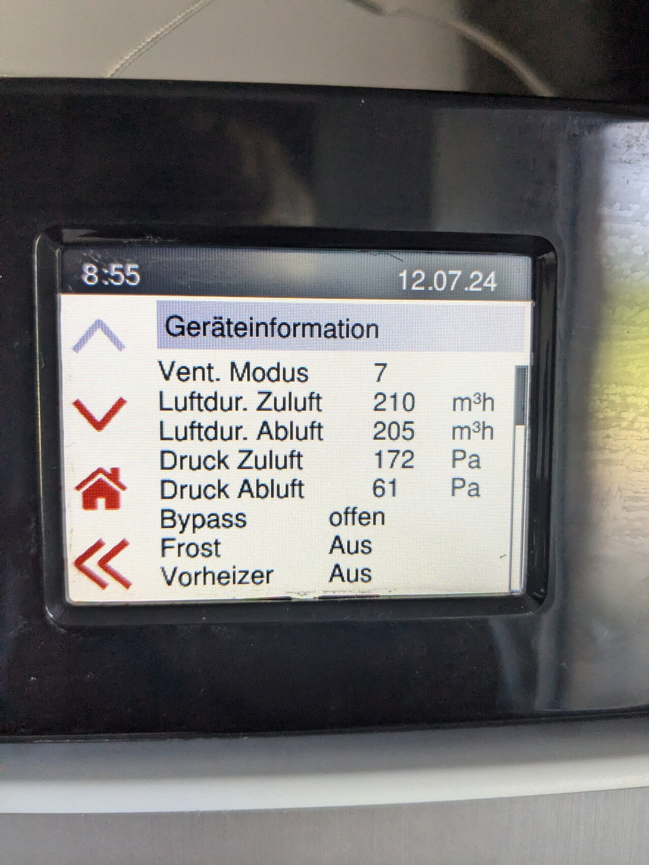

I believe the bypass was open; it was actually open the whole summer when I checked. Attached are photos from another day when the bypass was definitely open. What measurement values would be typical for an open bypass?

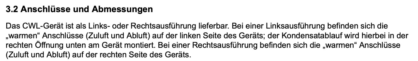

Do you have a CWL-2 325 in the left- or right-handed version? We received the wrong version, so the supply and exhaust air connections were swapped. I noticed this before the final acceptance. The specialist company installed it exactly according to the plan but did not check its functionality. They wouldn’t have noticed the mistake otherwise.
I have the left-handed version (identifiable by the "L").
From the manual:
Regarding temperatures:
When the bypass is open (i.e., no heat exchanger), the supply air temperature is almost exactly the indicated outside temperature.
When the bypass is closed (heat exchanger active), the exhaust air temperature is close to the outside temperature.

Paradiddel5 Sep 2024 21:19Hello Sysrun80,
Great, that was my big hope—to find someone here with the same device 🙂
I had already suspected the left and right versions when I looked at the manual.
We have the following unit:
CWL-2-325 4/0 L - LN, so the left version as well, and on the left side, the air continues into the individual rooms or back again. That should be correct.

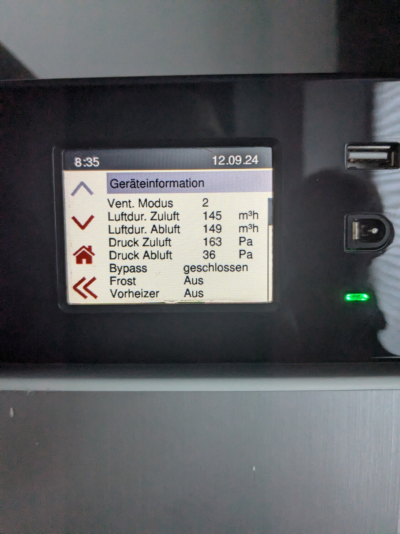

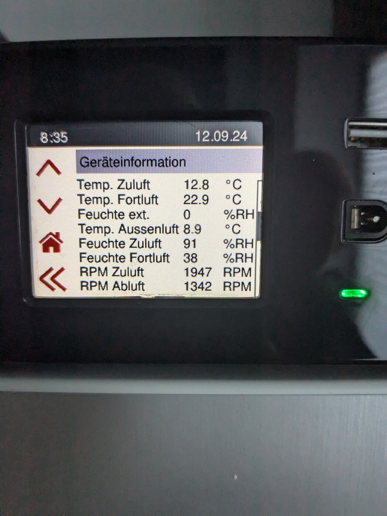

Paradiddel13 Sep 2024 21:56Good evening,
I have now also run the ventilation system with the bypass closed. The exhaust air temperature is around room temperature rather than outside air temperature; I have attached some pictures. It seems that something is not quite right with the device, if I am seeing this correctly.
I wonder if this could be the reason why the system has a lower airflow rate than expected, or if perhaps only the sensors are swapped?
