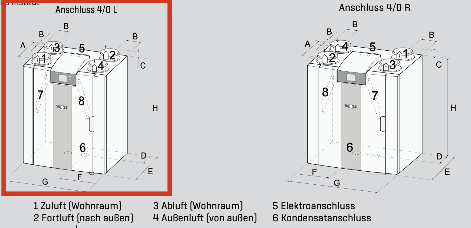

Good evening,
a quick question for those interested. I had a Wolf "CWL-2-225 4/0 L" (according to the nameplate) installed.

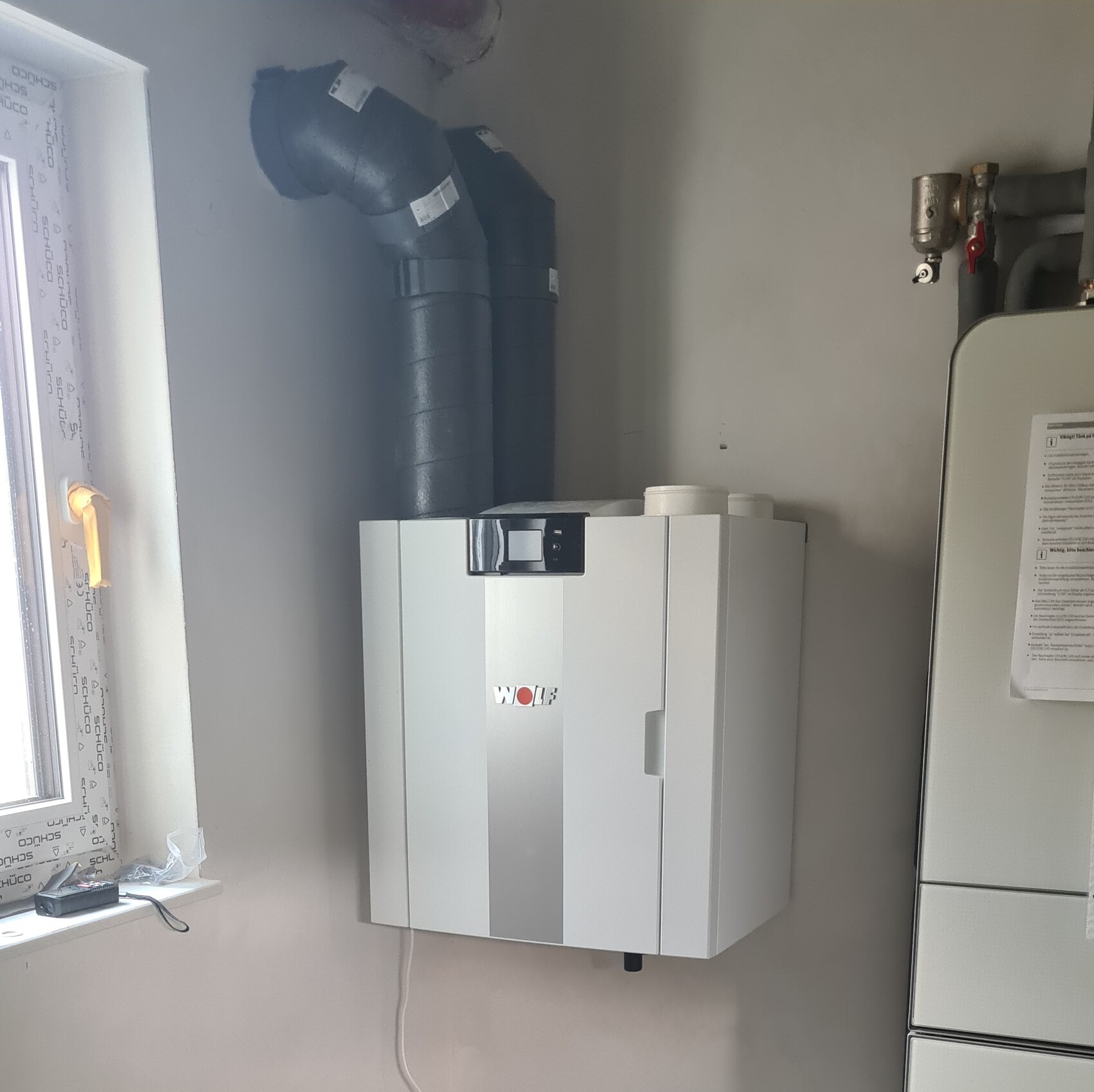

Wall-mounted heating system in the basement with pipes and outlets
The documentation shows the following:
Ventilation unit with 8 connections, two views: left 4/0 L, right 4/0 R
Am I missing something, or should I promptly inform the general contractor? 😉

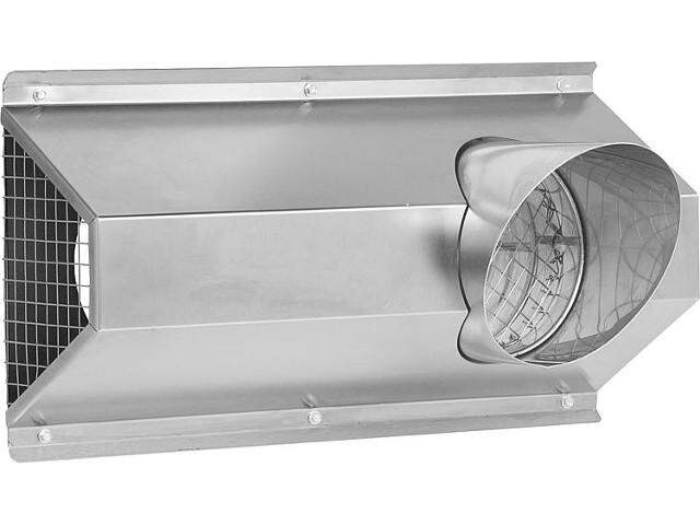

I believe replacing the device should be the least of the problems (even though I waited exactly 1 year for my [I]system). A bigger issue is probably that there is not enough distance between the exhaust air and the outdoor air. 🙄 [/]
sysrun80
30 Aug 2023 11:16
This is installed on the exterior. I have seen it many times, and two acquaintances have been using it successfully for years.
Metal ventilation unit: rectangular housing, round air inlet with wire mesh

The general contractor has confirmed the "problem" and will fix it. When I asked if it would be a R device now: No.
Well, then I am curious. I have no desire for a pipe-juggling, makeshift disaster...
