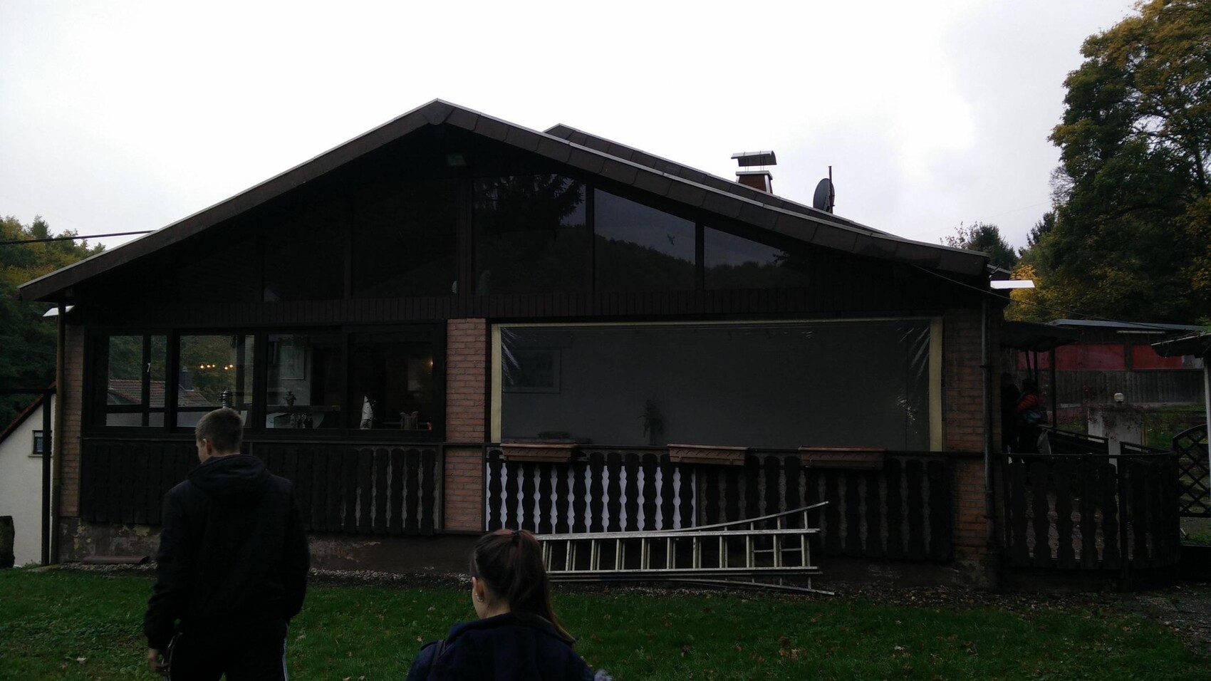

Bungalow with approx. 142m² (about 1530 sq ft), of which 120m² (about 1290 sq ft) is on the ground floor.
Usable floor area approx. 116m² (about 1250 sq ft)
Plot size approx. 5600m² (about 1.38 acres)
The house is partially (one quarter) basemented.

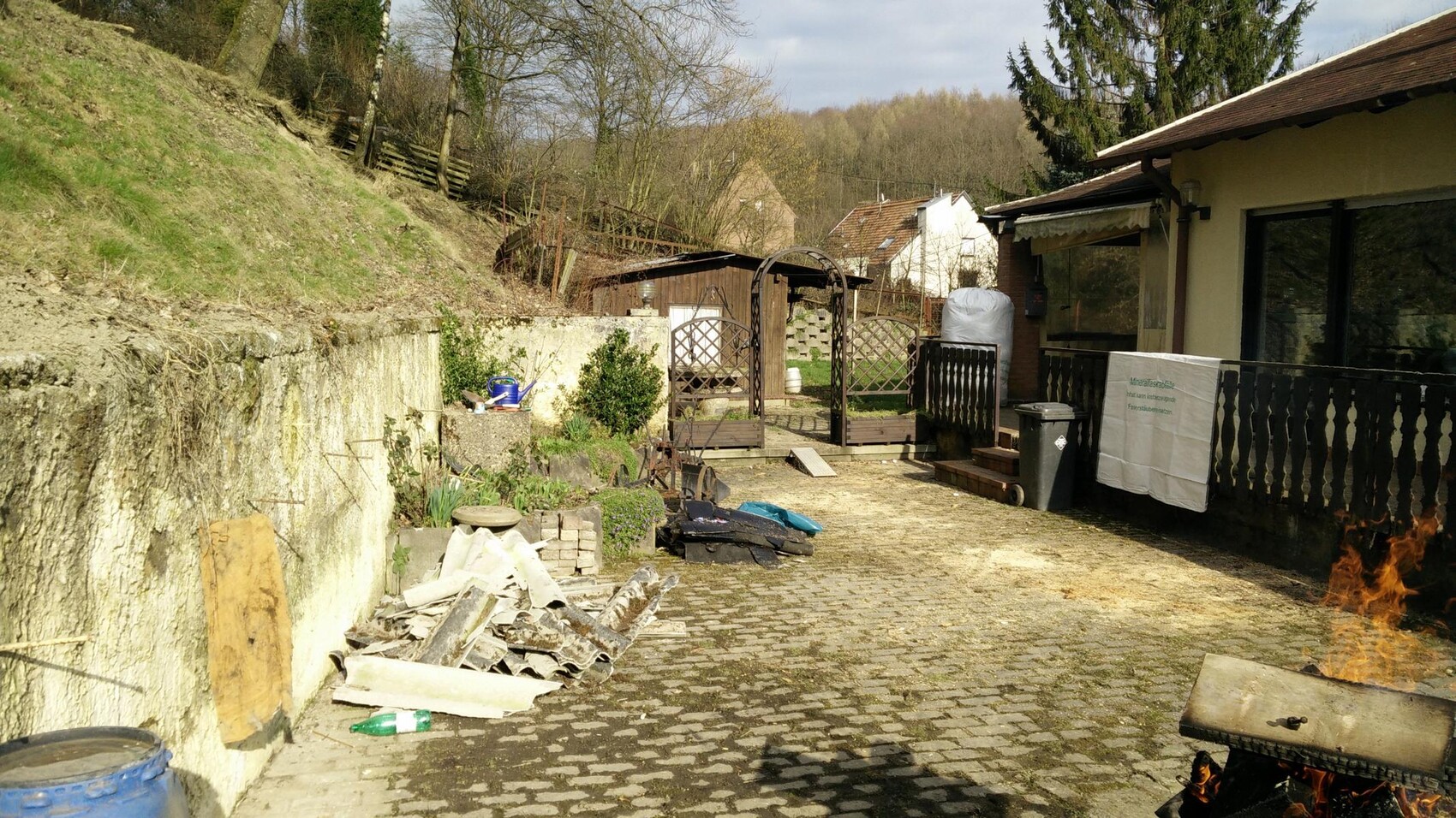

There was an outbuilding and some stables, which have since been demolished.

Initially, the plan was just to replace the roof, add some new paint to the walls, and do a few small things.
What it turned into:

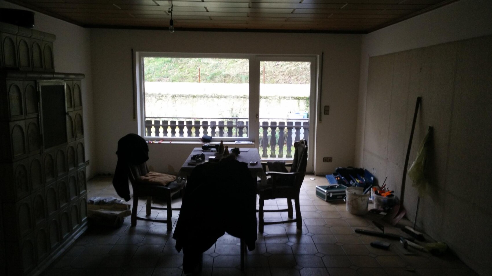

Old floor plan
New floor plan
Attic floor
Overall, I made the house more open.

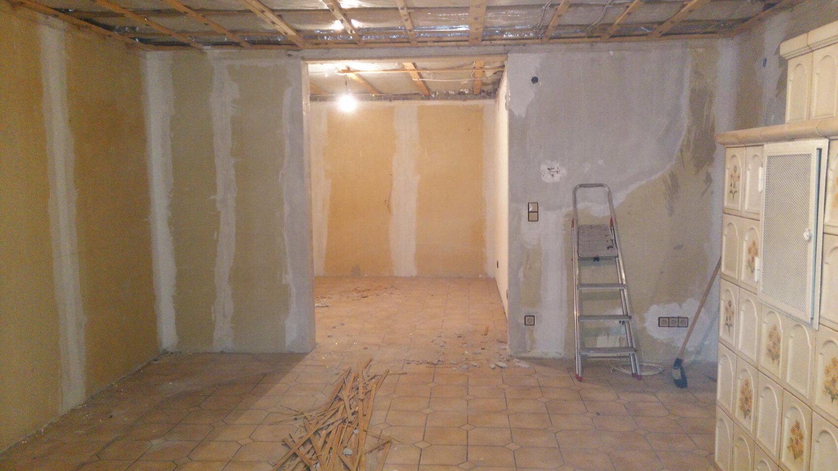

For rooms 1 and 2, I removed the suspended ceiling, giving a room height of 4.5m (15 feet).

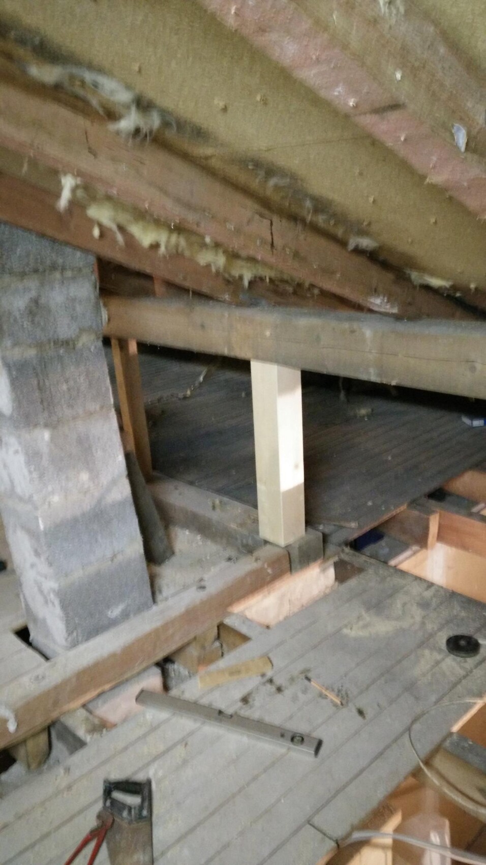

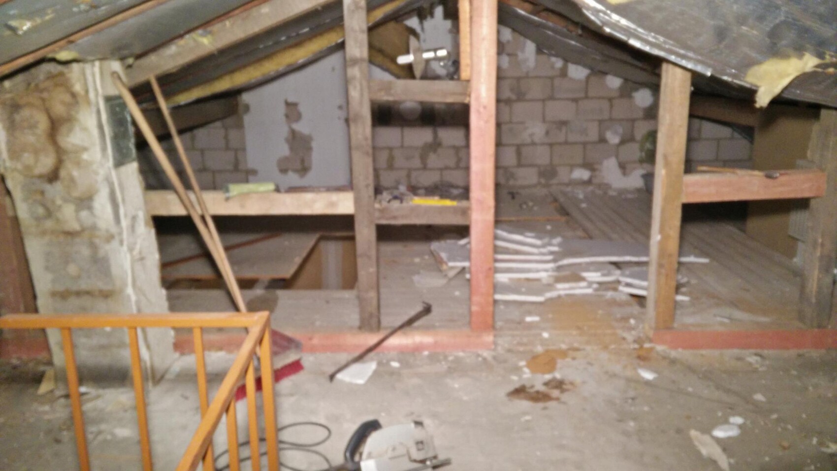

Since I replaced the roof and switched from bitumen shingles to tiles, I also had to reinforce the roof structure.
For this, I had a new structural calculation done and reinforced the main beams with steel, installed new posts, and doubled the rafters.

So far, everything has been done by myself, except for the roof, where I had help from a roofer.
