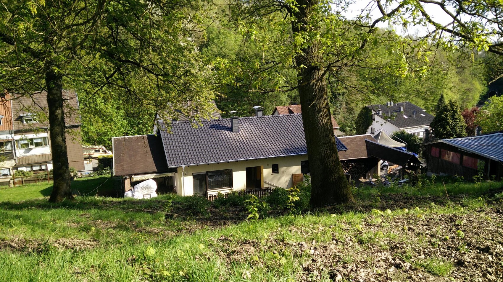

The House:
Bungalow with approx. 142m² (about 1530 sq ft), of which 120m² (about 1290 sq ft) is on the ground floor.
Usable floor area approx. 116m² (about 1250 sq ft)
Plot size approx. 5600m² (about 1.38 acres)
The house is partially (one quarter) basemented.
There was an outbuilding and some stables, which have since been demolished.

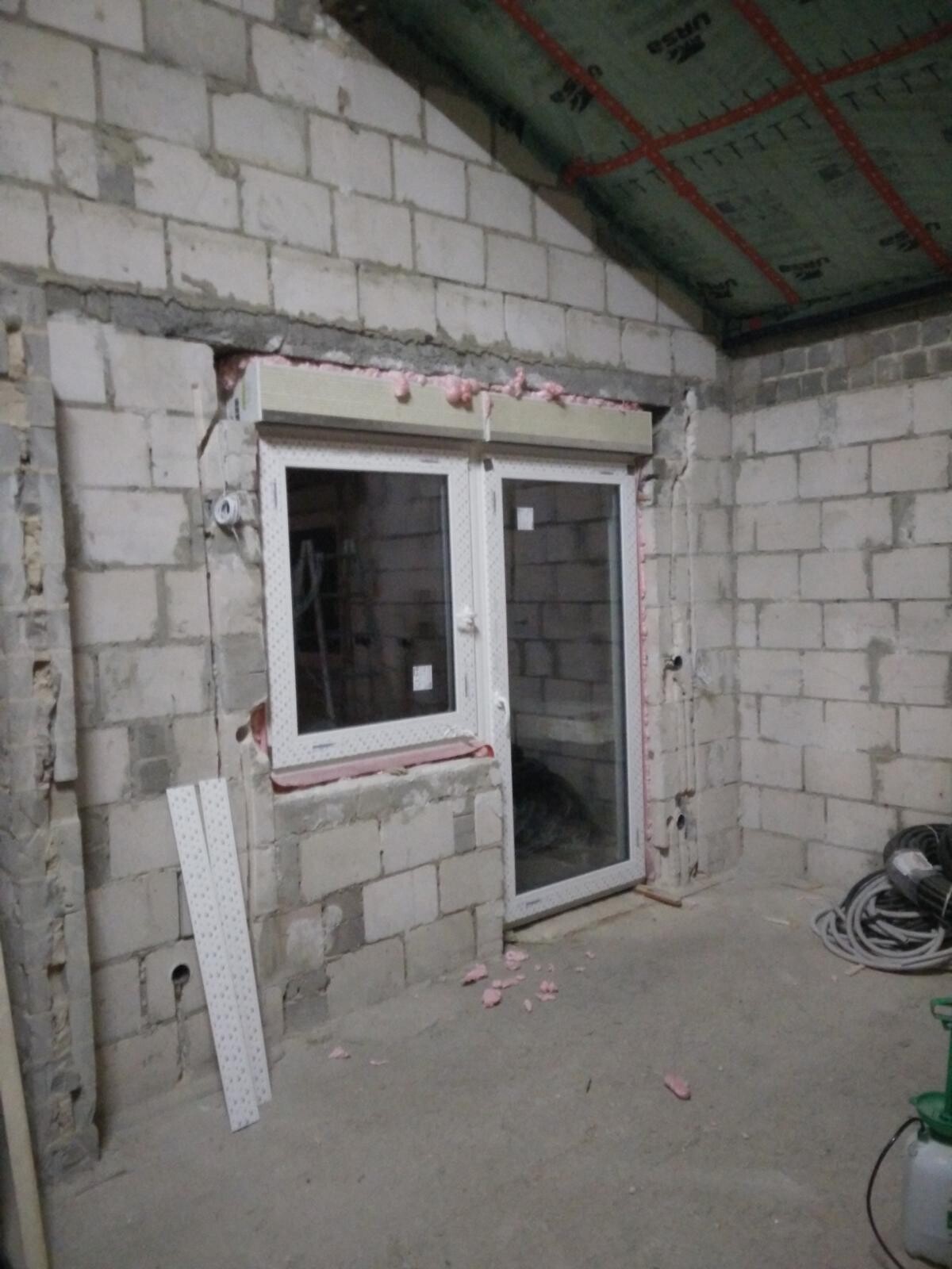

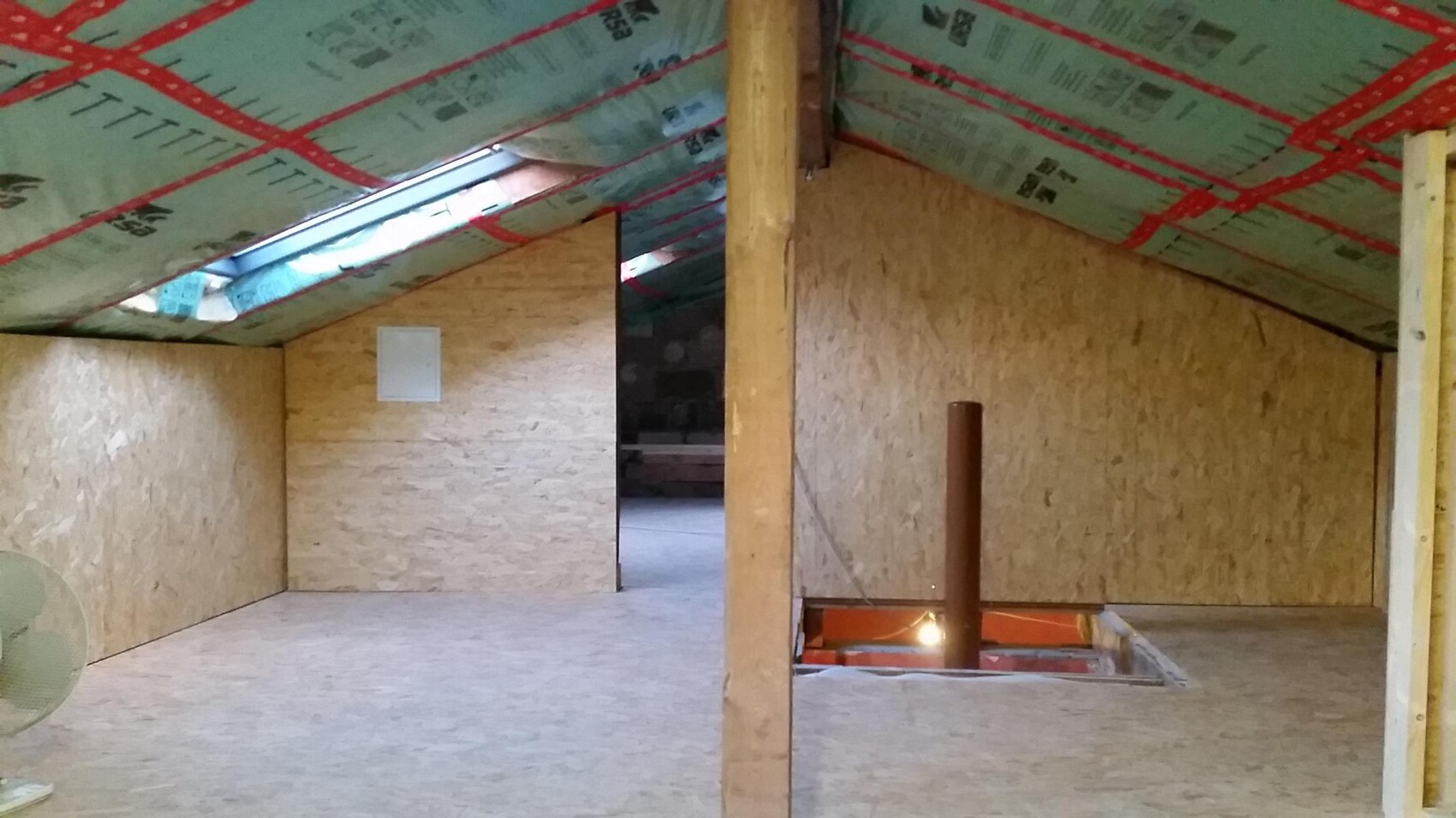

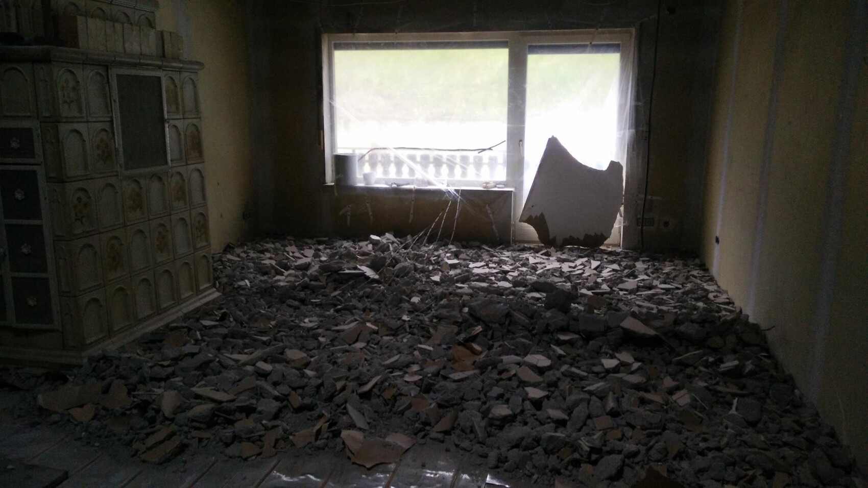

Initially, the plan was just to replace the roof, add some new paint to the walls, and do a few small things.
What it turned into:
- Roof replacement
- Bathroom renovations
- Completely new floor plan

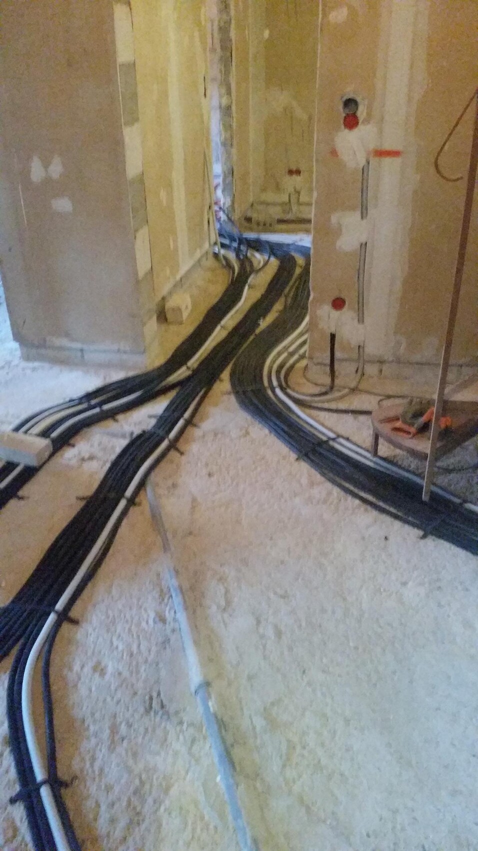

- Electrical system renewal with home automation via Wago

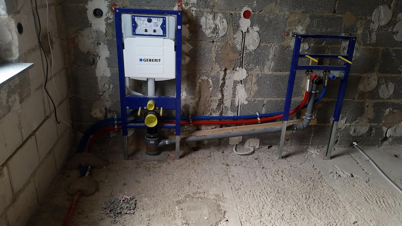

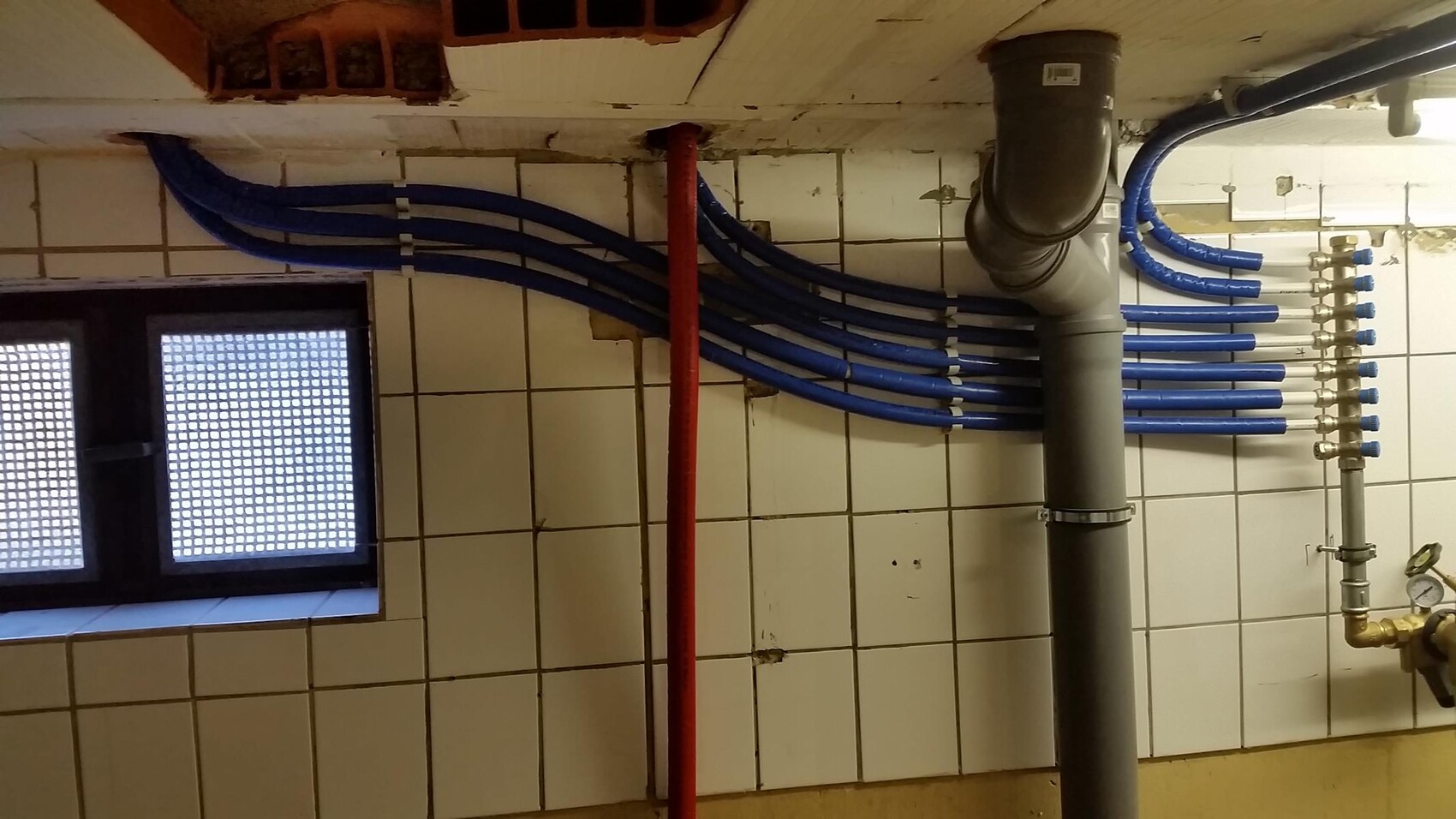

- Water/sewage system

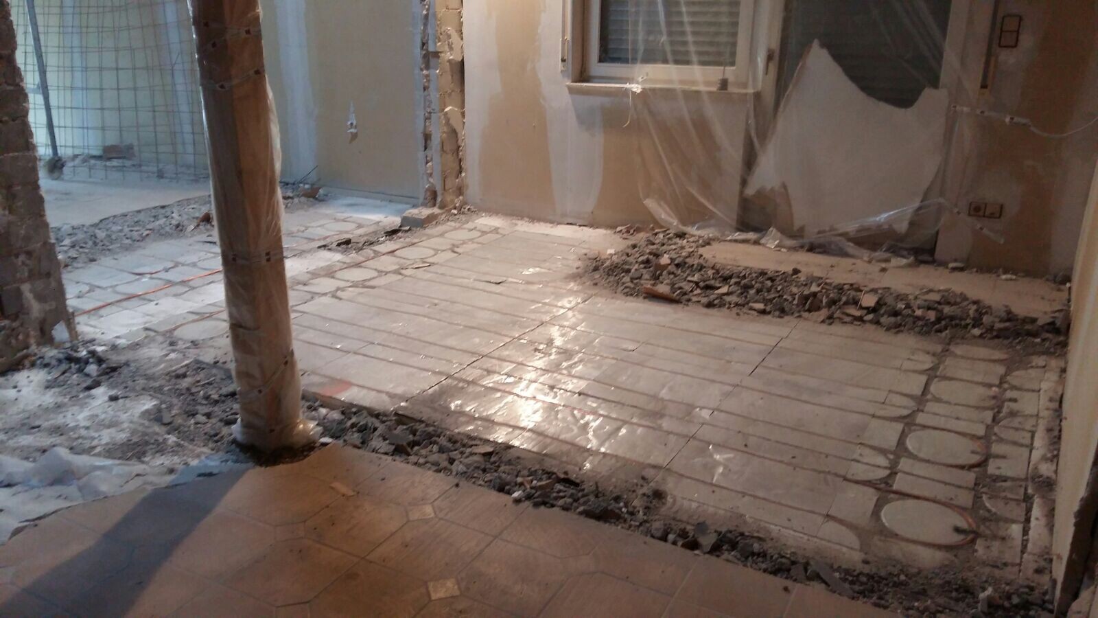

- Underfloor heating
- Windows
- Insulation
- Floor, wall, and ceiling coverings
- Everything else inside that was still needed

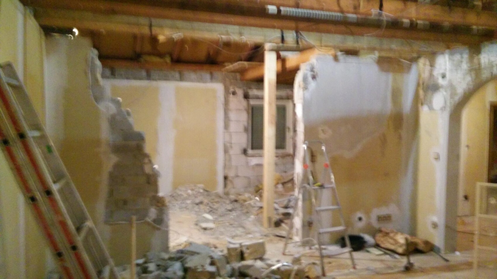

Old floor plan
New floor plan
Attic floor

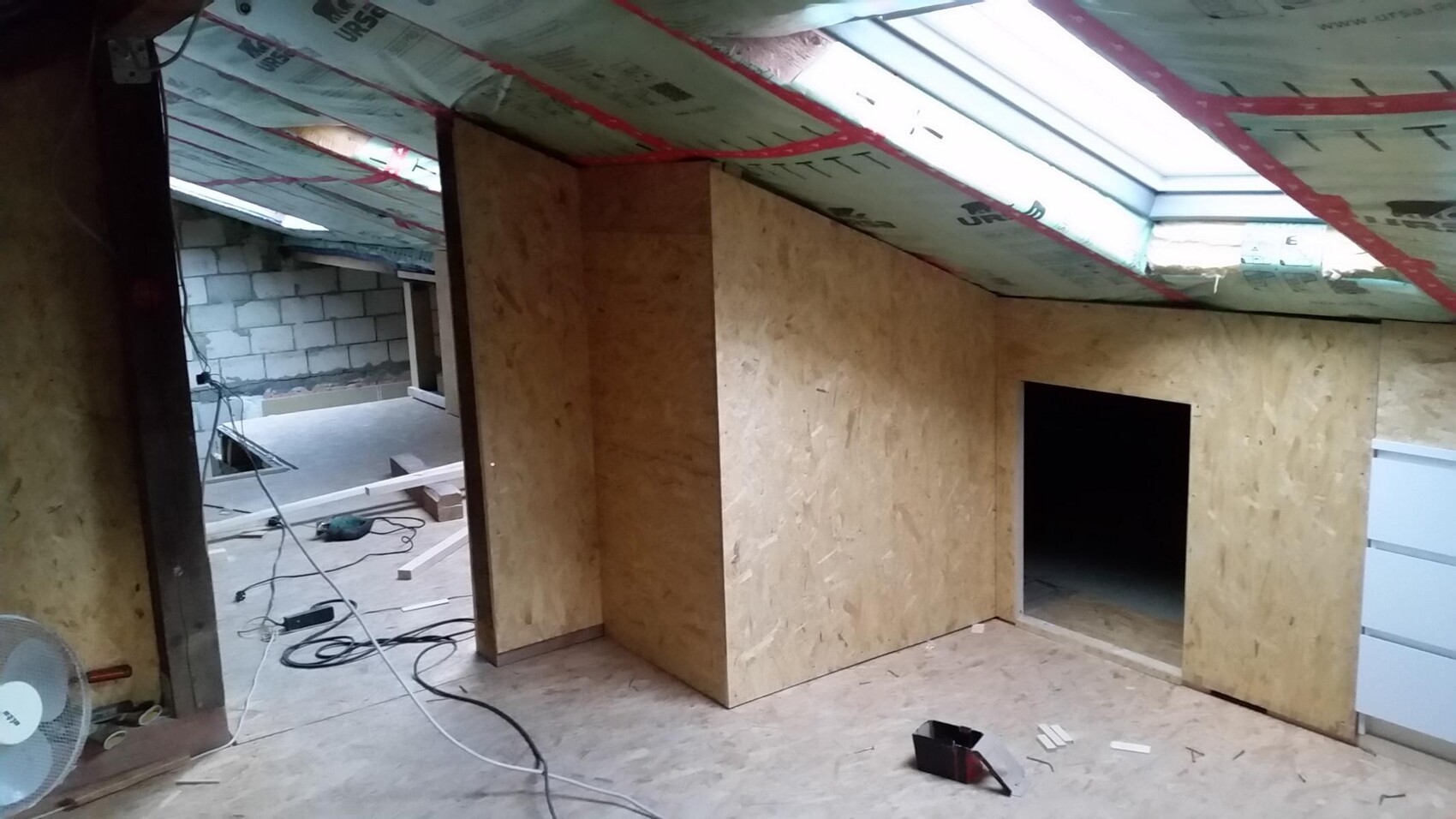

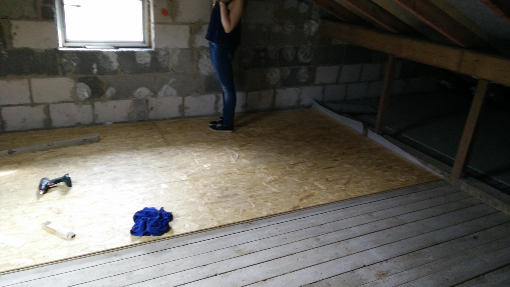

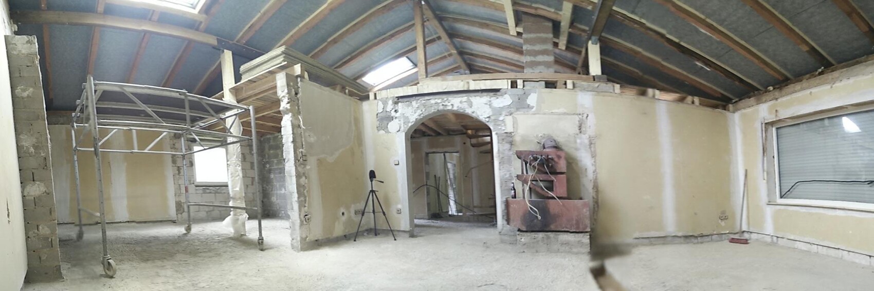

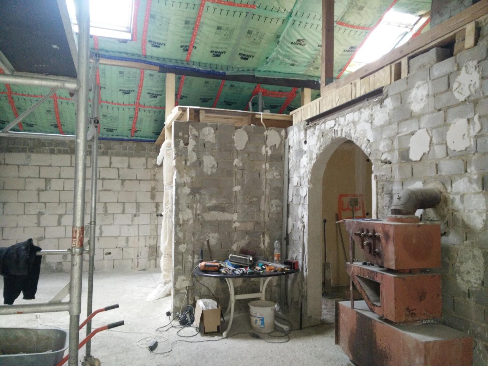

Overall, I made the house more open.

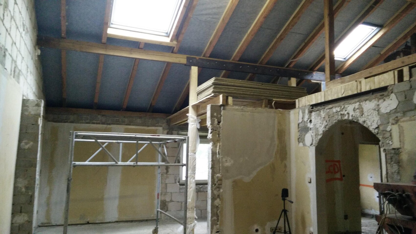

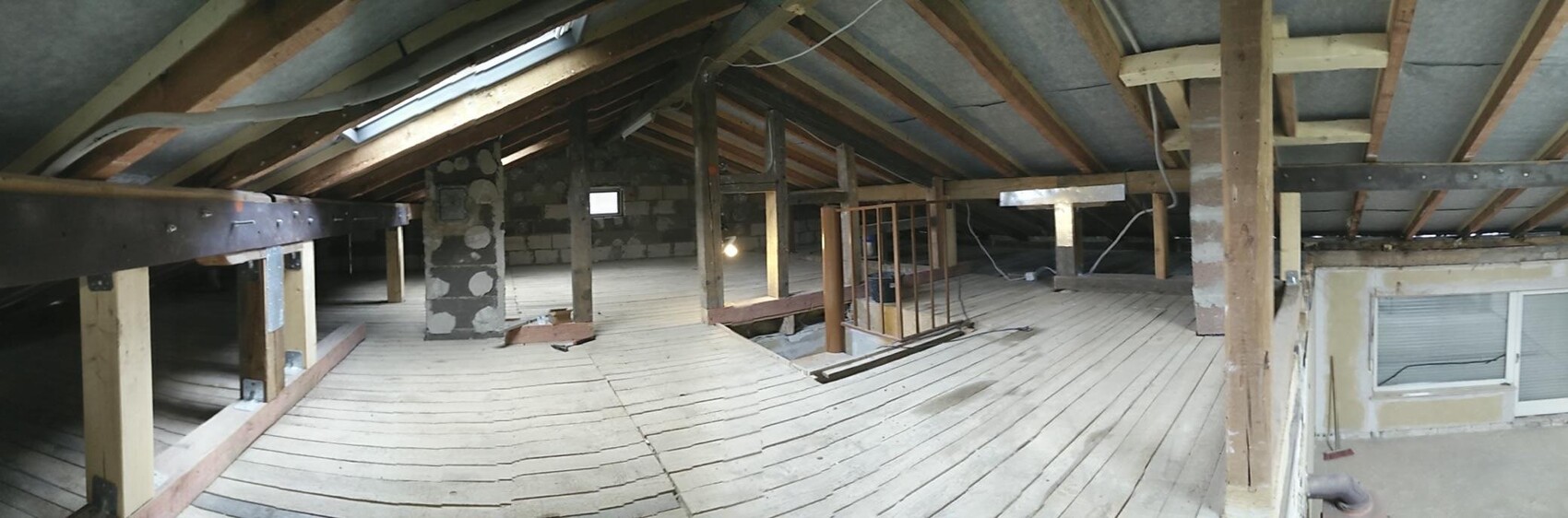

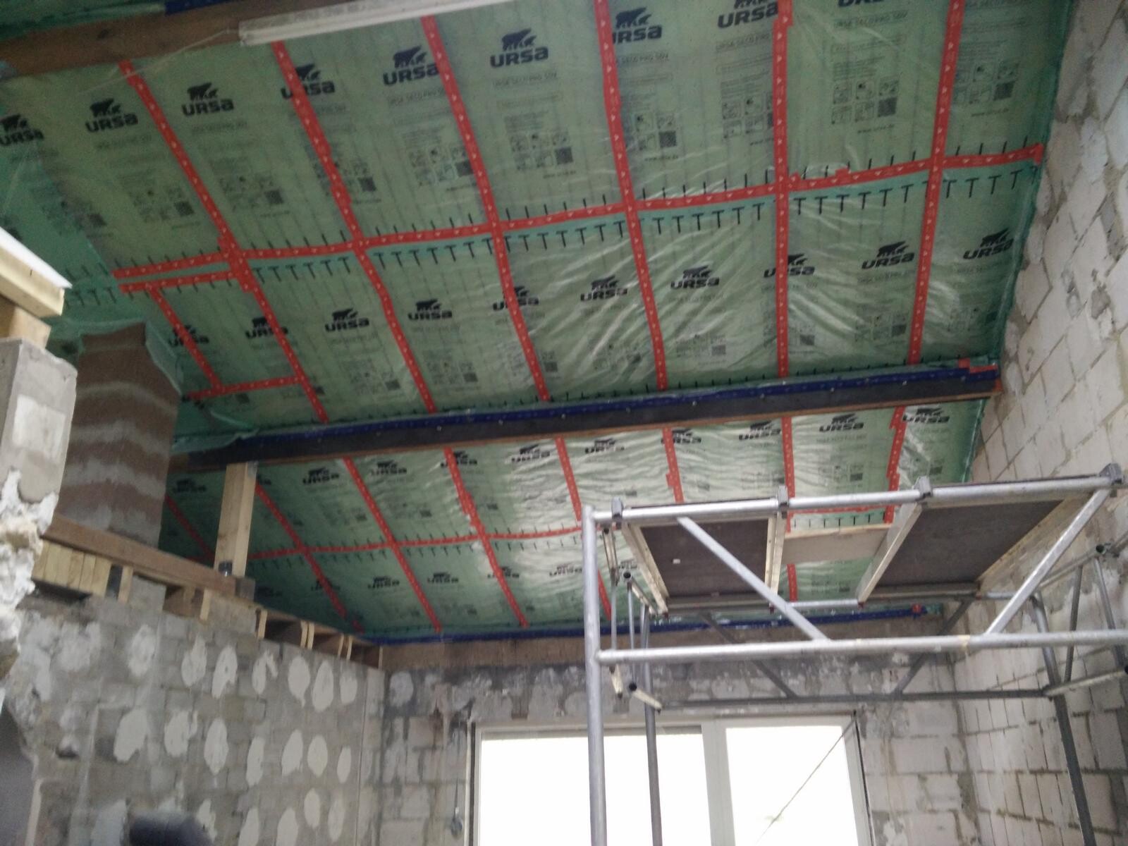

For rooms 1 and 2, I removed the suspended ceiling, giving a room height of 4.5m (15 feet).

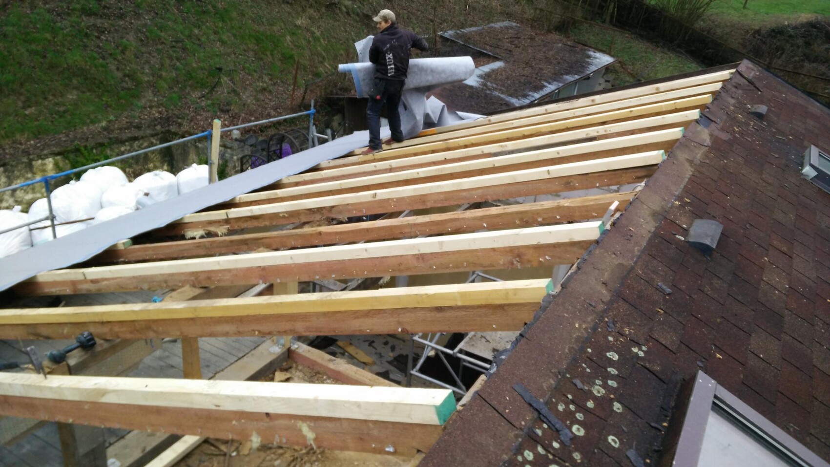

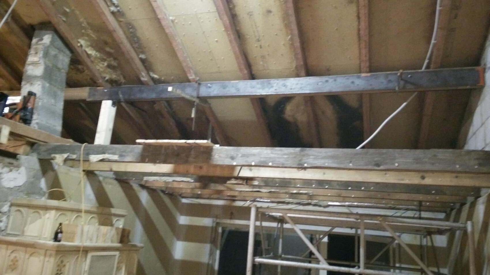

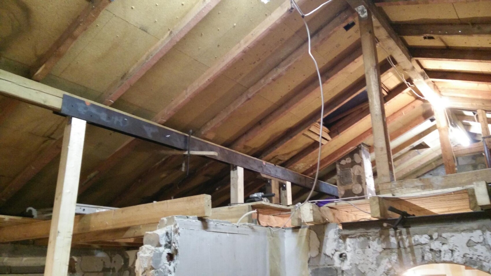

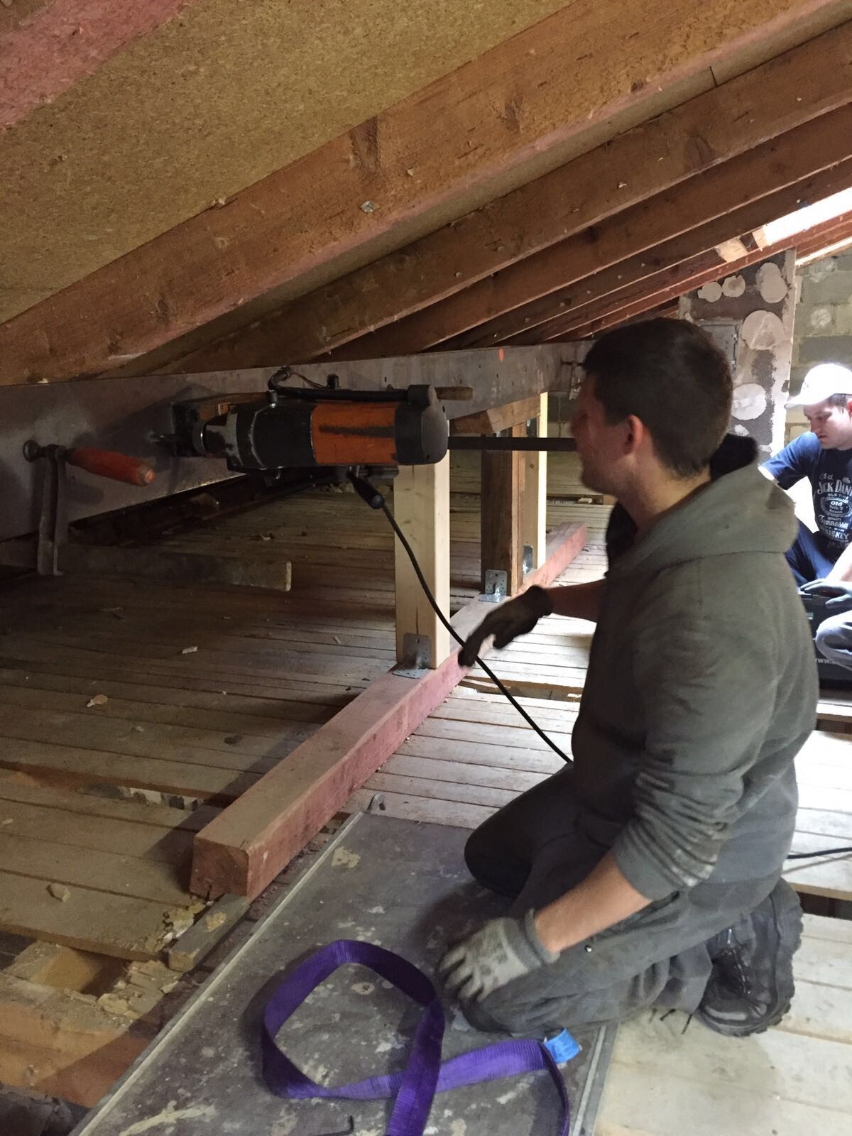

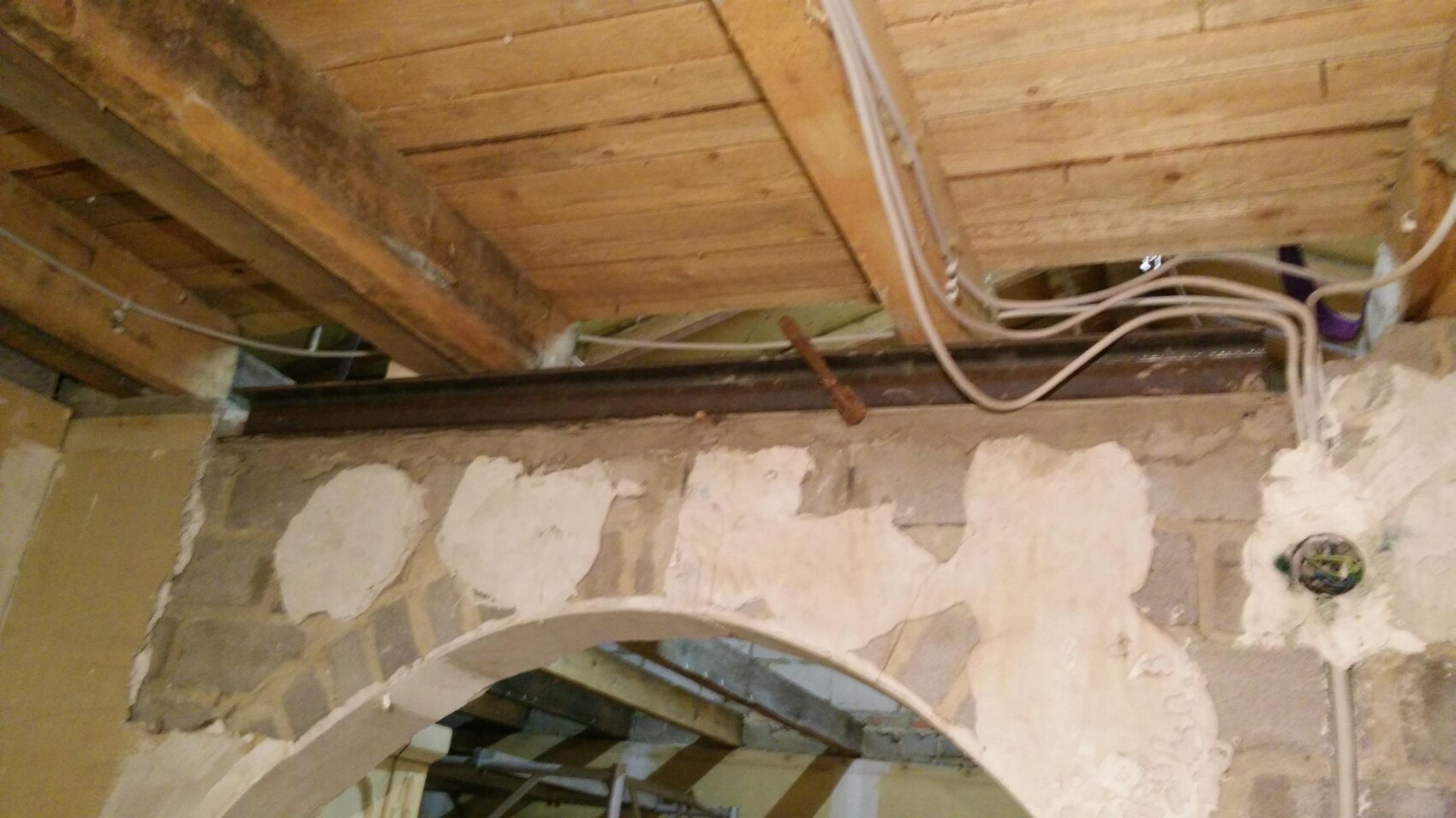

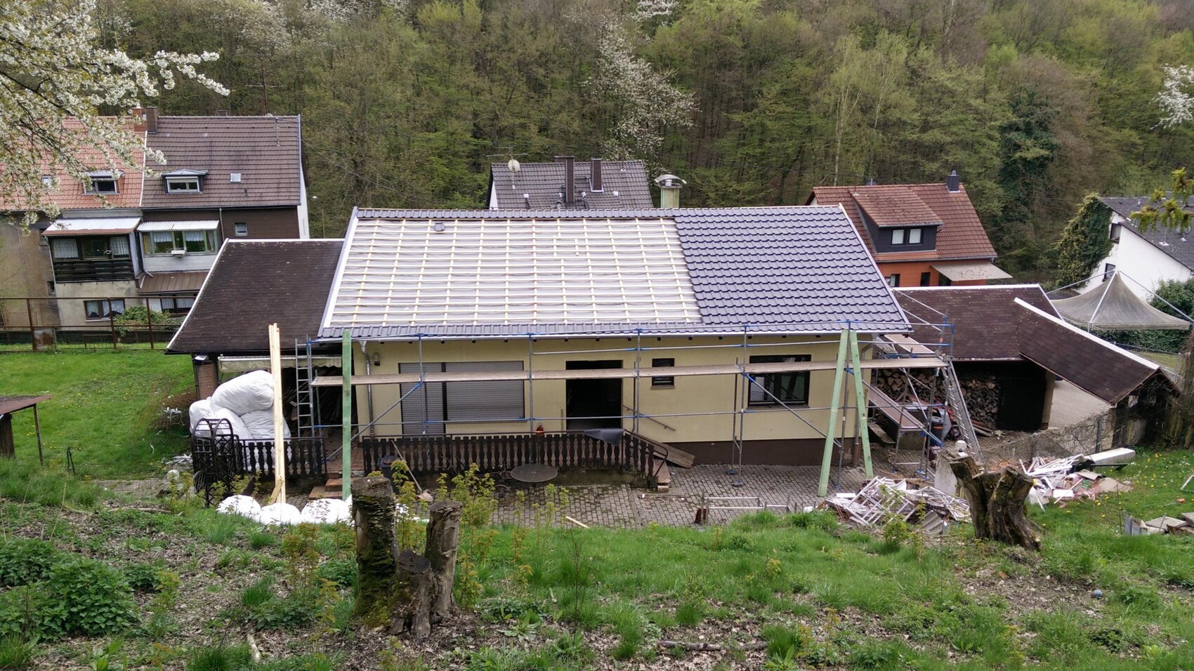

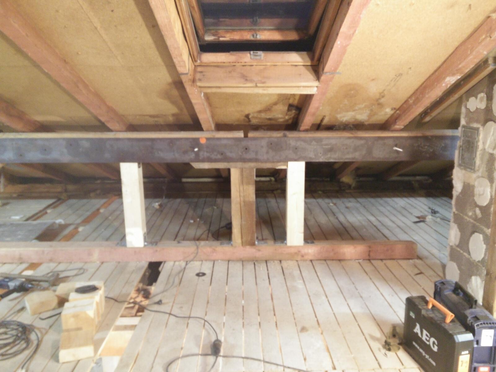

Since I replaced the roof and switched from bitumen shingles to tiles, I also had to reinforce the roof structure.
For this, I had a new structural calculation done and reinforced the main beams with steel, installed new posts, and doubled the rafters.
I was actually going to write more, but I’m feeling lazy, and pictures say more than a thousand words. Feel free to ask if you have any questions.

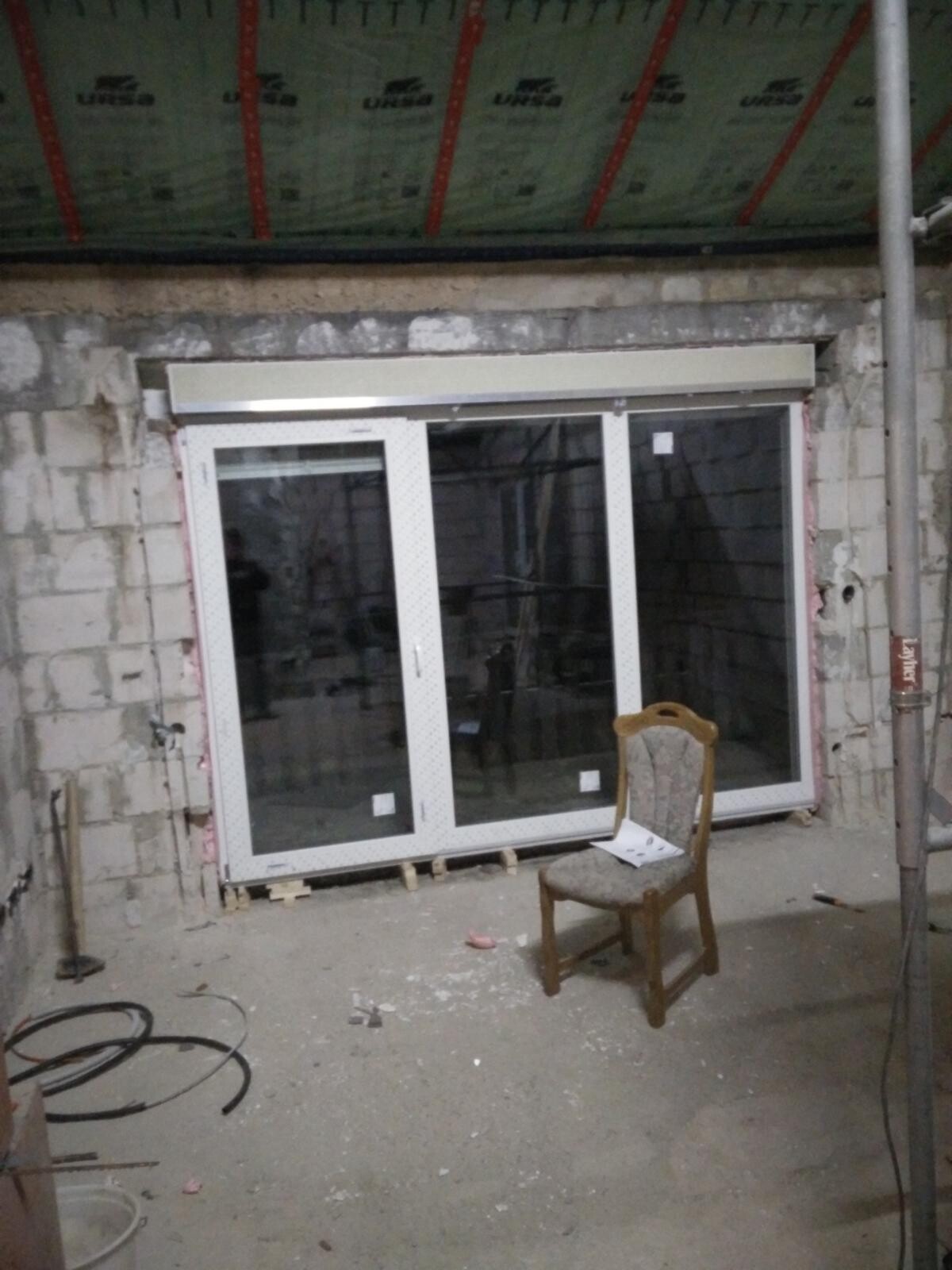

approx. €8,000 windows with built-in roller shutters and motors (triple-glazed safety glass SK2)

So far, everything has been done by myself, except for the roof, where I had help from a roofer.
