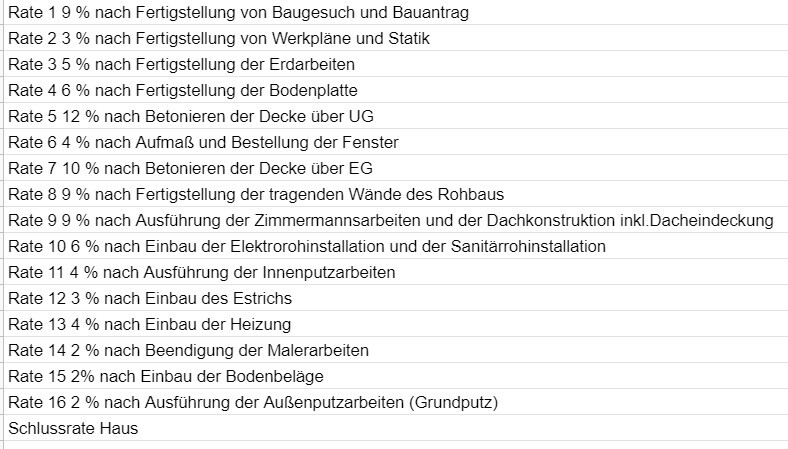

The ceiling above the ground floor has just been concreted on our site. According to the payment schedule, a partial payment of approximately €30,000 is due.

A ceiling above the ground floor??? That's quite intense. You have an absolutely terrible payment schedule.
