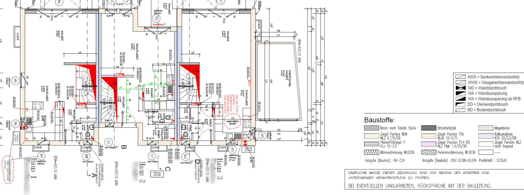

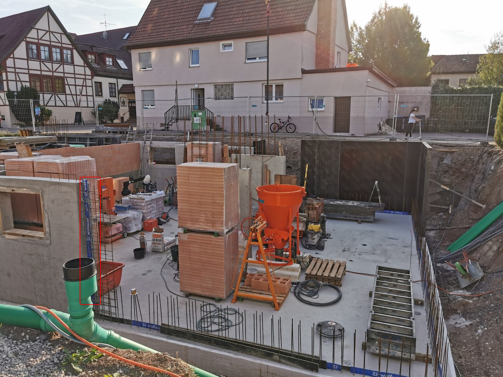

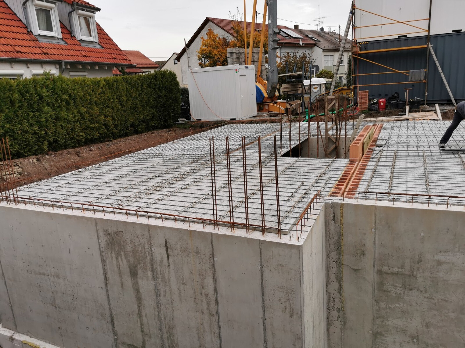

Kishihmen11 Feb 2021 11:18icandoit schrieb:
Is this a developer or a contractor?
I’m asking because the basement was built by a different contractor.
Is there photo documentation of the partition wall in the basement and ground floor (especially the insulation in between)? There are photos of almost everything 🙂
Separation from the “inside”
