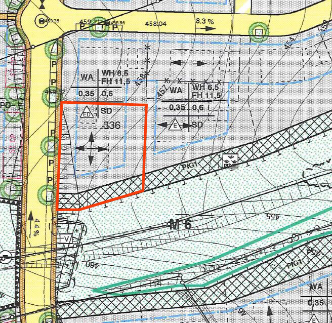

I don’t know if it makes sense for this thread to fill in the data, but just in case, here are the details.
Plot size: 791 sqm (8509 sq ft)
Slope: yes
Site coverage ratio: 0.35
Floor area ratio: 0.6
Building envelope, building line & boundary: see attachment
Number of parking spaces: 2 (double garage planned)
Storeys: 2–2.5 (garden level/partial basement, ground floor, and possibly half attic as a gallery with an open space above the ground floor)
Roof style: gable roof (35–42° specified)
Orientation: open
Maximum heights/limits: ridge height: 6.5 m (21 ft 3 in); full height: 11.5 m (37 ft 9 in)
Other requirements: distance from house to street approx. 4.5 m (15 ft); (site slopes downward from street)

Zoning/building plan with red plot polygon, yellow road, and blue lines.
