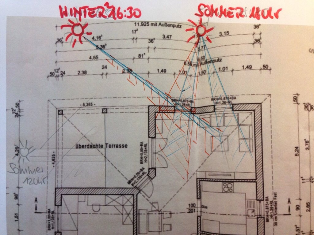

The window under the sofa has the disadvantage that you will get reflections on the TV. However, in winter this won’t be an issue: the sun sets in the southwest, so at that time of year it won’t shine through these two windows significantly.
Just to give you an idea, here’s a rough sketch: blue shows sunlight coming through your windows, orange through a 2-meter (6.5 feet) window to the left side of the plan.
Try searching for “sun position” on Google, there should be a simulator available.

I have read through it carefully. Here is my humble opinion:
- I would only cover half of the terrace.
- On the left side (assuming this is the south), I would not just use the small casement window but rather a much larger one facing the terrace – this would bring in enough light (right now it gets quite dark).
- At the top (assuming west), the left window should definitely be floor-level and significantly larger.
- On the right side (assuming north), I would add a floor-level window where the sofa ends: this will brighten the room noticeably despite the north-facing position – and the sofa can still be positioned properly. I would leave out the second window facing west and instead install a larger window to the left of the sofa.
winnetou7811 Jul 2017 08:35Thanks for the help.
But then I really don’t know where to put my furniture anymore.
If the patio door is even bigger, there’s no space left.
In the upper left on the west side, bigger and floor-to-ceiling, that means no more furniture either.
In the end, I would only be able to fit the couch.
