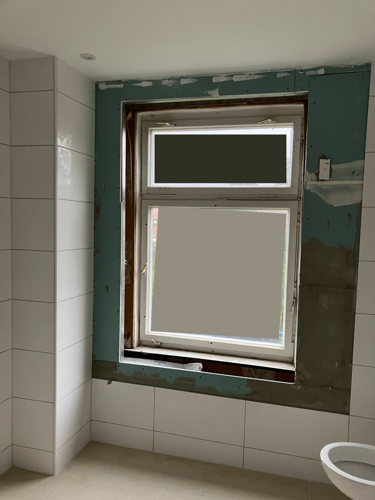

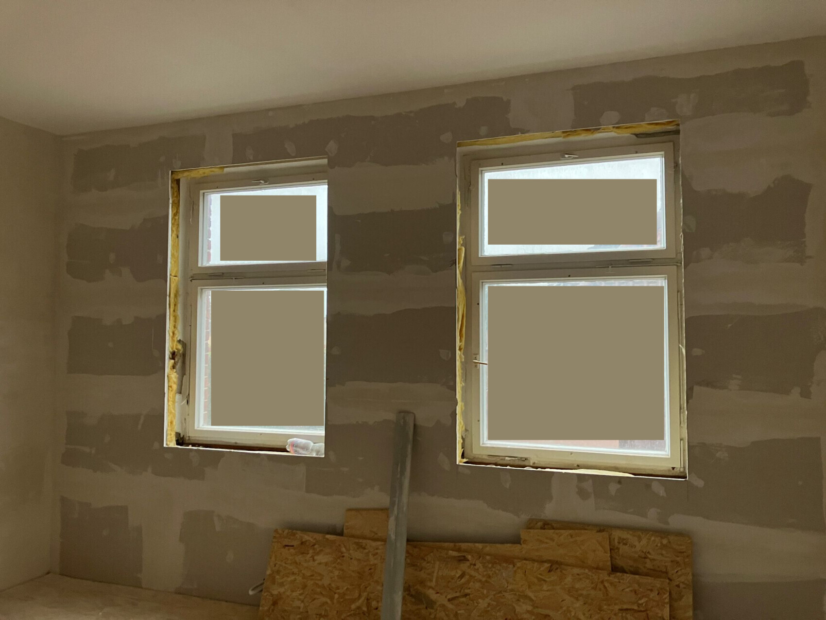

we are currently renovating a house. The old windows all have a top transom and also a tilt window at the top. The house is going to be rented out and will be divided into two apartments.
Questions:
- Is the transom in the window purely an aesthetic feature? Could you simply install one large window instead? (Cheaper) Dimensions vary from height: 1820 - 1600 millimeters (72 - 63 inches), width 1150 - 1080 millimeters (45 - 42 inches). Maybe these are just too large and a transom makes sense?
- If we want a transom: The old windows have a tilt window in the transom. You can tilt open the transom. Is it advisable to order the transom with a tilt function? I’m unsure if tenants will actually use or notice this. Could you just fix the transom in place and order the lower window with a tilt-and-turn function? (Cheaper)
I know everyone wants to save money, but there are quite a few windows, and in my opinion it is worth considering whether some features are really necessary. We don’t have an energy consultant or subsidies, etc. The house received its first insulation during this renovation. Previously it was only a brick wall. Now interior insulation has been added between a double wall.

KarstenausNRW17 Oct 2023 23:05The windows are not so large that single-pane windows would look odd. However, you would also need to see the exterior appearance for that.
Such windows—whether multi-pane or divided by muntins—were common in older buildings (with a nice look: tall windows due to high ceilings, which then influenced “standard” houses) and offered a ventilation function that didn’t let cold air directly enter at body height.
Personally, I like this style because it conveys a cozy atmosphere. But that is purely for aesthetic reasons.
If you do choose that, then as a fixed top window. Cleaning is not a big issue, as it is still relatively easy to reach. But you definitely don’t need the ventilation function (opening is also too inconvenient—for an office, automatic openers work much better).
My conclusion: Do what you like. There are no significant advantages or disadvantages between single-pane or multi-pane windows. Tilt windows have mostly disadvantages compared to fixed glazing—they are more expensive and harder to operate (be honest, if you stand in front of the window, what would you open? The sash or maybe get a chair to open the tilt window?). I rule out cleaning as a drawback because, with windows of the same height, you’d be standing on a ladder or step stool anyway.
Lastly: Please post a photo from the outside. Maybe then opinions will lean towards “divided,” because a single pane might look awkward from the outside!?
