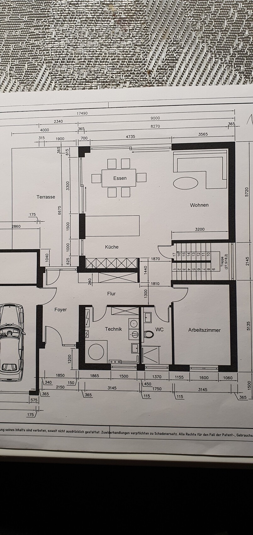

It concerns our floor-to-ceiling aluminum windows in the open-plan living area. Both are designed as lift-and-slide windows. Clear ceiling height is 270cm (106 inches), window height 240cm (94 inches). We don’t want a corner window—the structural engineering would be too complicated. It has been agreed with the structural engineer that a 24x24cm (9.5x9.5 inches) concrete support column plus insulation will be placed in the corner. (The picture still shows a longer masonry wall, but this will be changed.)

Kati.com schrieb:
It was agreed with the structural engineer that a 24x24 cm (9.5x9.5 inch) concrete column with insulation will be placed in the corner. (In the picture, a longer masonry wall is still shown – but this will be changed). Why would you make a change that creates an installation problem?
Kati.com schrieb:
Do you perhaps have another solution?
@11ant – what is your professional opinion on this? I have never been an expert in corner window blinds, nor do I want to become one; in my opinion, the solution is obvious: don’t make the change that causes the problem in the first place 🙂
Why would anyone want to make a change that creates an installation problem?Because I want to have as little wall bulk as possible in the corner. The planner knew that too. He initially designed the corner with masonry because he wasn’t sure how it would work structurally. It was only after consulting the structural engineer that we got the green light for the narrow concrete support.
