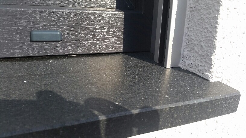

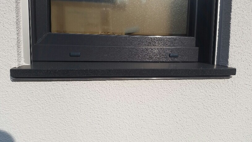

Ours look almost identical. We have Nero Impala.
They match perfectly with the RAL 7016 windows.

[ATTACH alt="fensterbaenke-aluminium-oder-Granit-122989-1.jpg"]8270[/ATTACH] [ATTACH alt="fensterbaenke-aluminium-oder-Granit-122989-2.jpg"]8271[/ATTACH]
The type is Nero India, flamed finish with drip edge.Hello again... I’m bringing this thread back... ^^ We currently have aluminum window sills in color 7016 installed.
