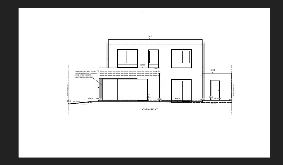

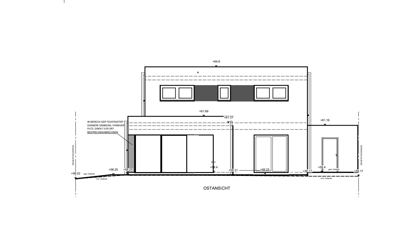

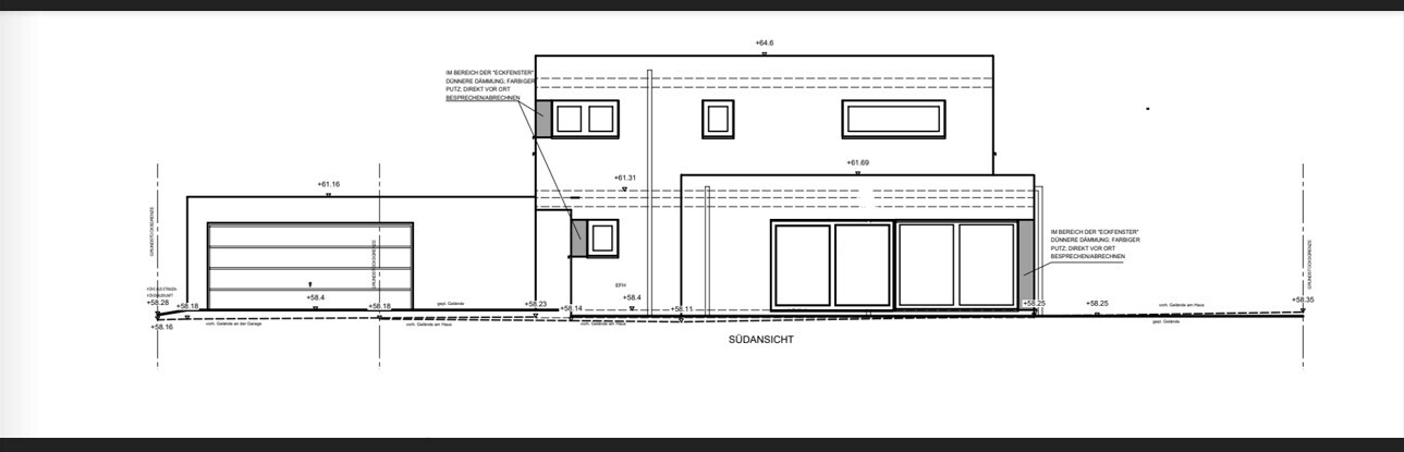

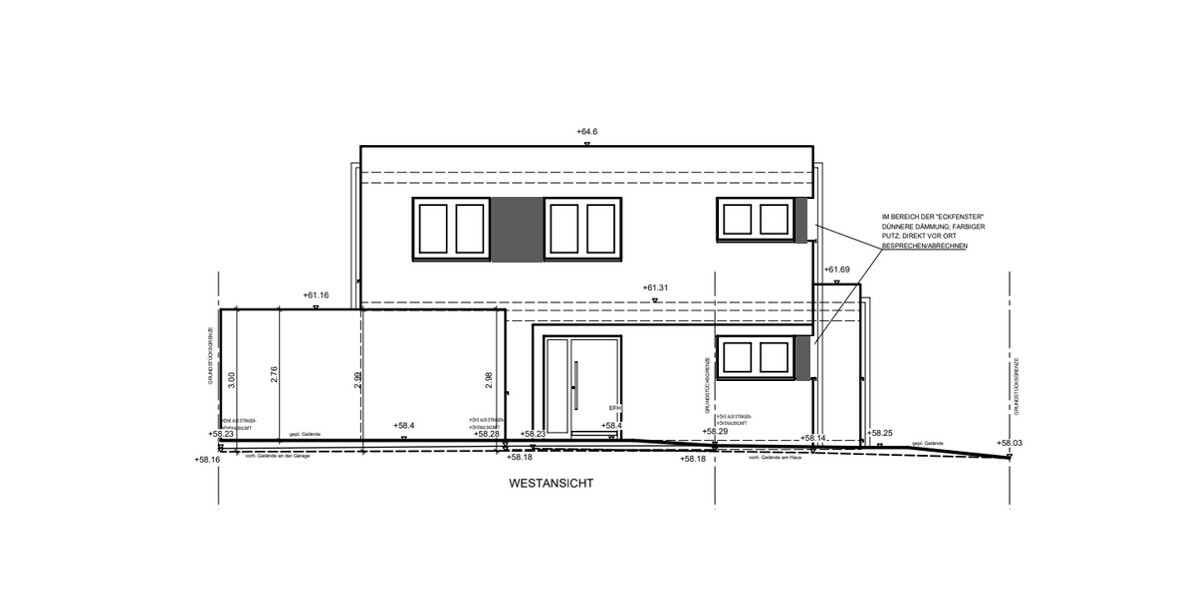

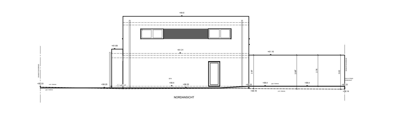

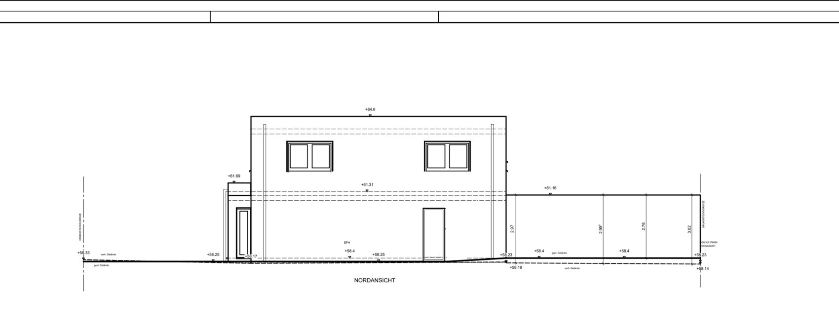

Hello... we have the following issue. Since we donât want too many different window heights in the house and also donât find the transition from a 130cm (51 inches) sill height to a low window in the same room or at the junctions particularly attractive, we are facing the above-mentioned problem. Actually, Iâm not even sure if itâs really a problem.
