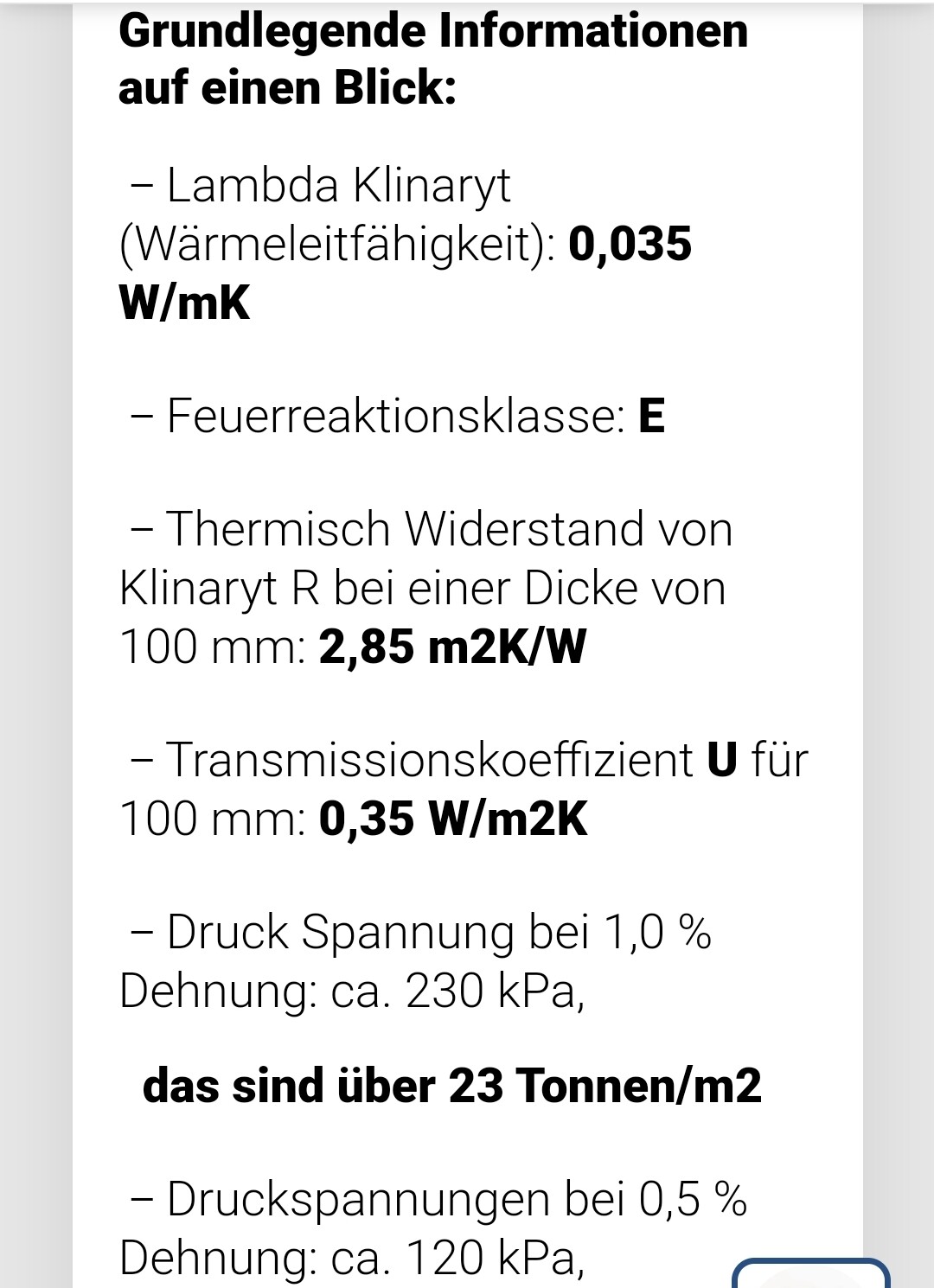

As far as I know, a Polish manufacturer patented Klinaryt. Technologically, it is a very densely compressed EPS. This is what I quickly found online.
There are also Purenit thresholds. They work on the same principle but are somewhat more complicated to handle on site.
Our windows came from Poland, so Klinaryt was installed.
Oops, @11ant – I made a typo in my previous message...
Material data: thermal conductivity 0.035 W/mK, fire rating E, R 2.85 m²K/W, U 0.35 W/m²K.
Tolentino19 May 2023 09:26
But 0.35 is not much better than the standard extension profiles, is it? They also contain XPS with 0.30–0.35...

19 May 2023 12:14
0.35 is neither better than an aerated concrete or porous clay insulation block, nor than the expanding foam that the window sill installer sprays underneath until it starts to smoke.
