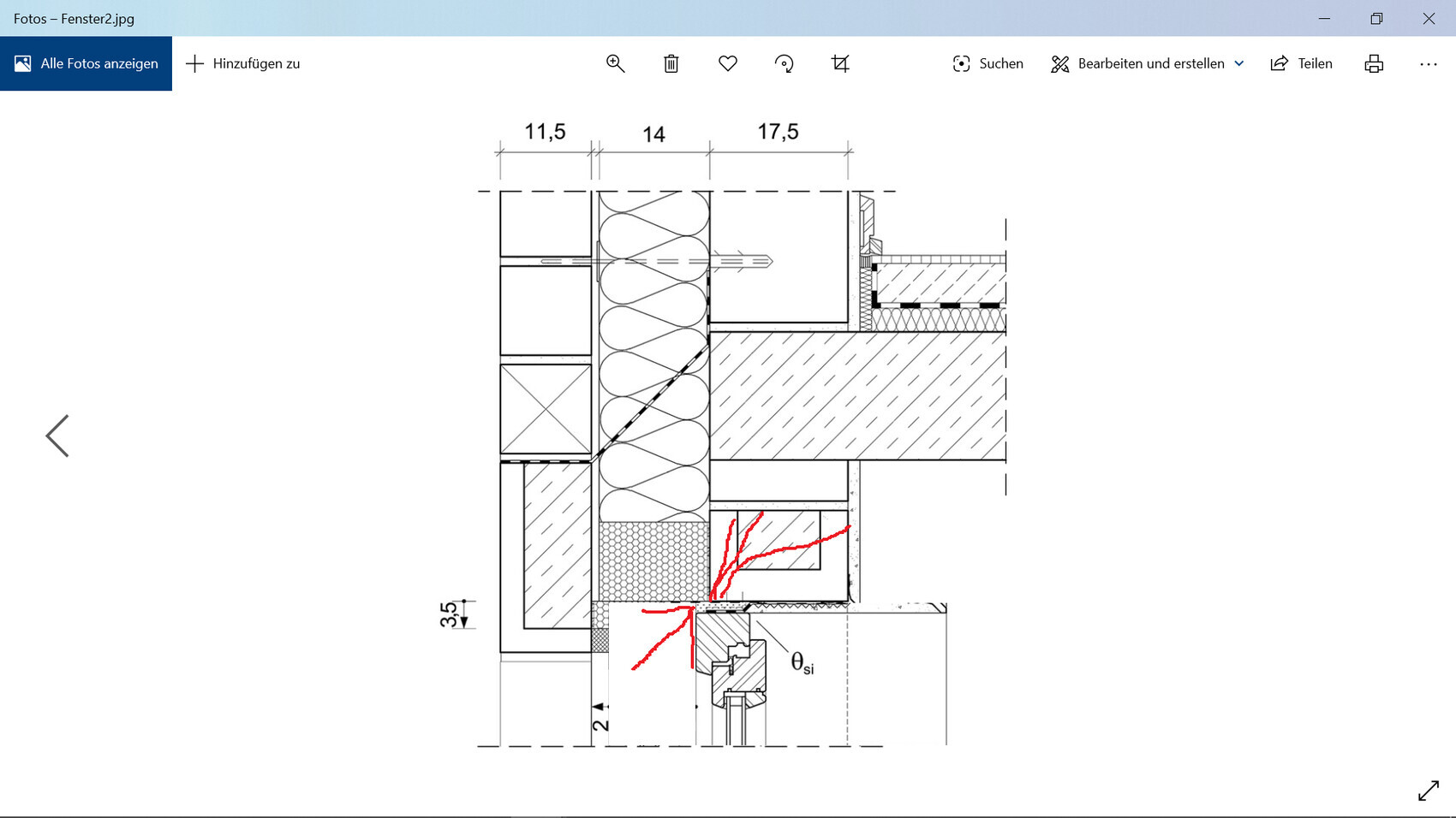

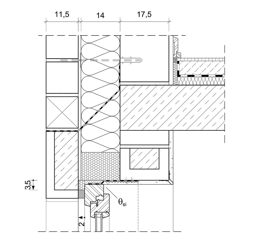

Now I have reached the limit of my knowledge. I will look into it. This is the installation method I know, as shown in "Window 2."
For "Window 3," I moved the window further back to illustrate what I mean; it is always difficult to explain. The masonry is properly insulated, and the window also has a certain U-value to meet the overall insulation requirements.
