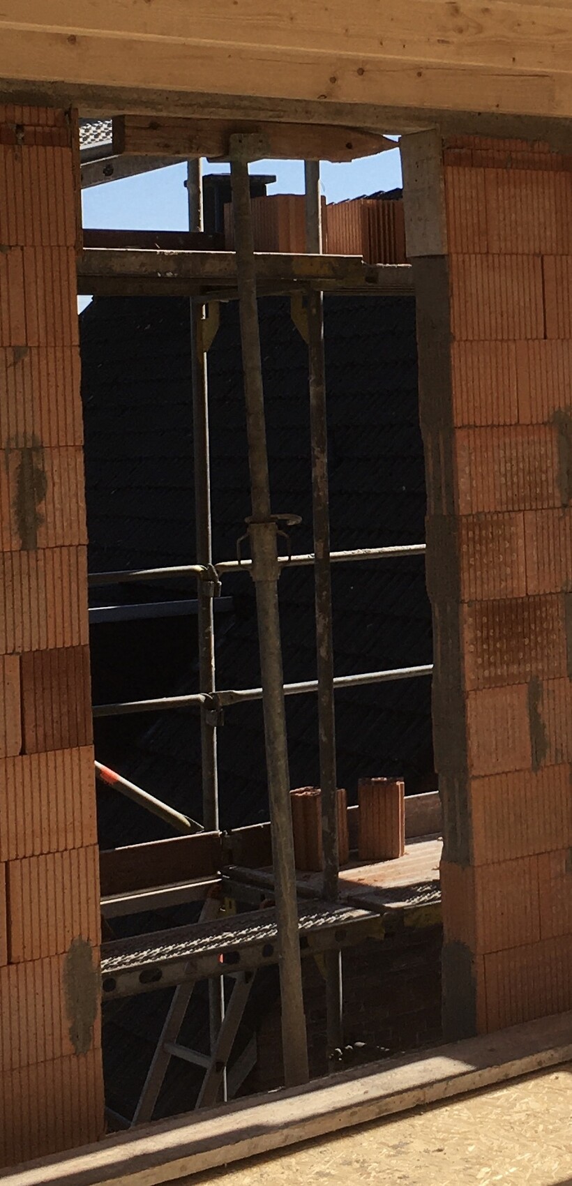

we are now about to install the windows… As far as I know, the window reveal must always be filled before installation. This has been done everywhere, but as a layperson, I’m not sure if this is correct..? My site manager tends to agree with everything and so does not have much expertise (a request for a replacement has been made).
From the picture, it can be seen that this was done only with cement mortar.
The exterior wall structure is: 1cm (0.4 inches) plaster (interior), 17.5cm (7 inches) Poroton brick, 16.0cm (6.3 inches) insulation, 1.5cm (0.6 inches) plaster (exterior).
Friends who have recently built their homes say that a smoothing coat must still be applied. Is that true, or would this work as it is (see picture) to ensure airtightness?
Wintersonne29 Apr 2020 21:14Are these black strips on the sides (I’m not sure what they are called)?
Wintersonne schrieb:
Are those black strips on the sides (I can’t remember what they’re called)? Do you mean the compressible sealing tape?
Yes, they are.
