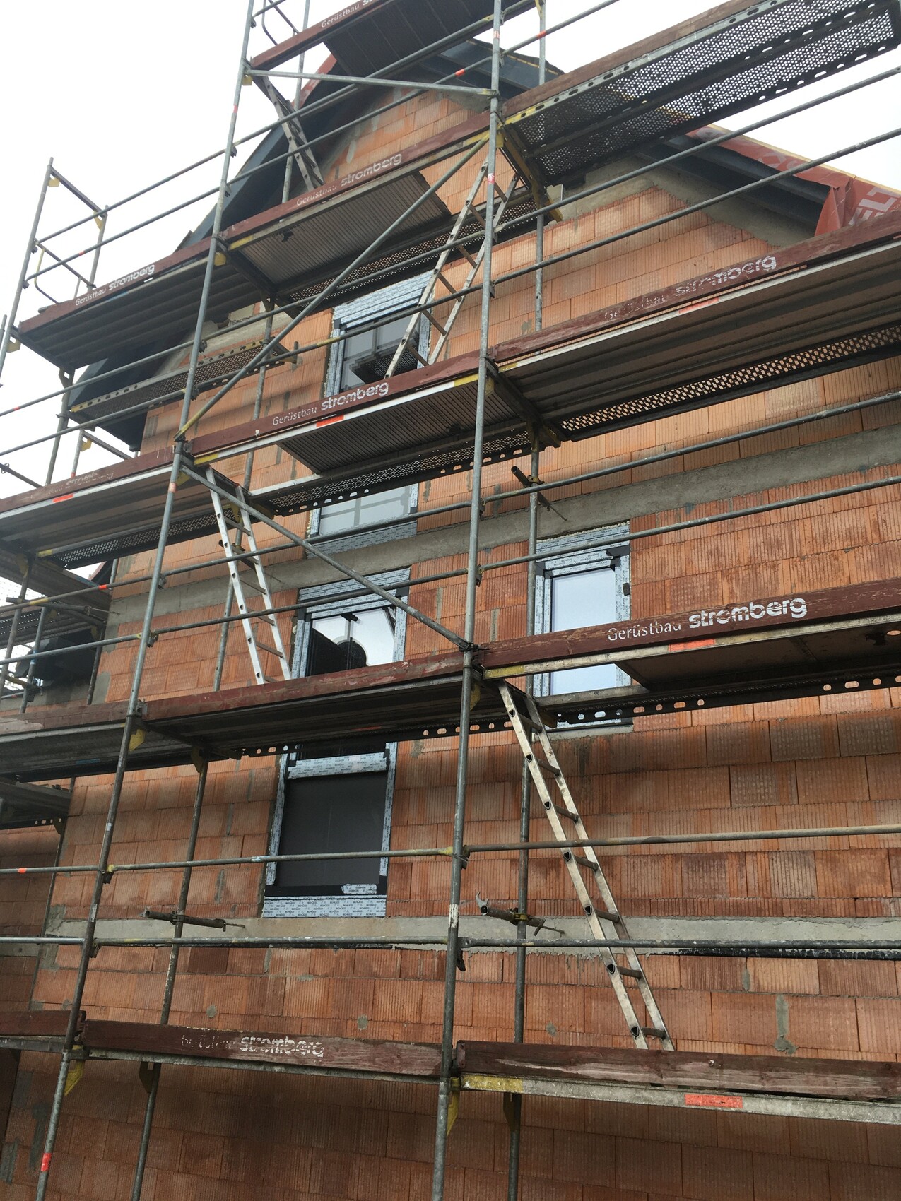

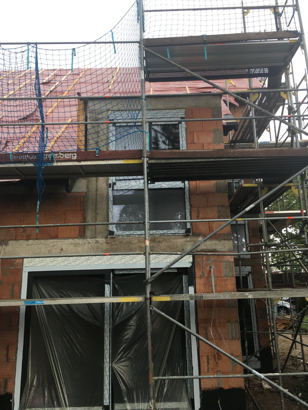

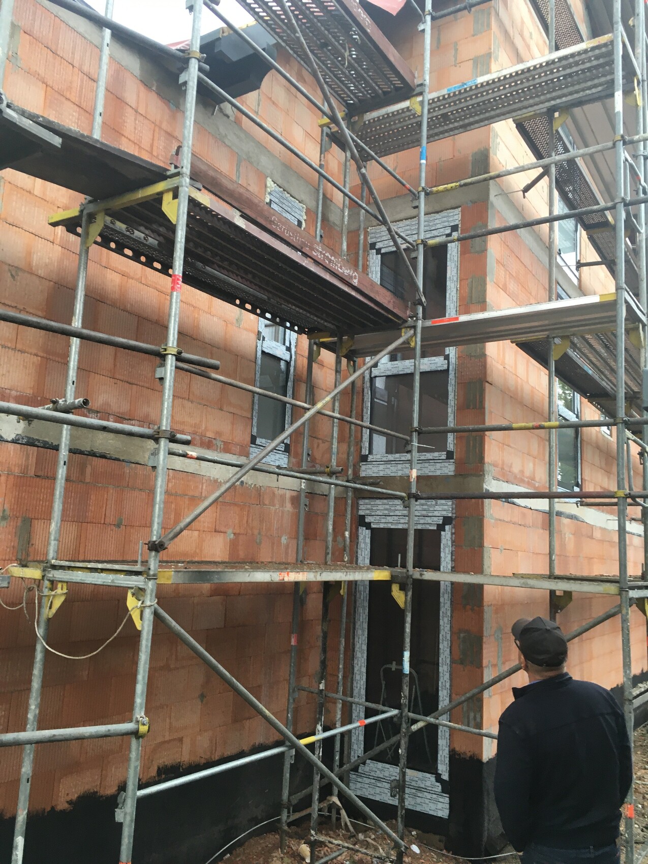

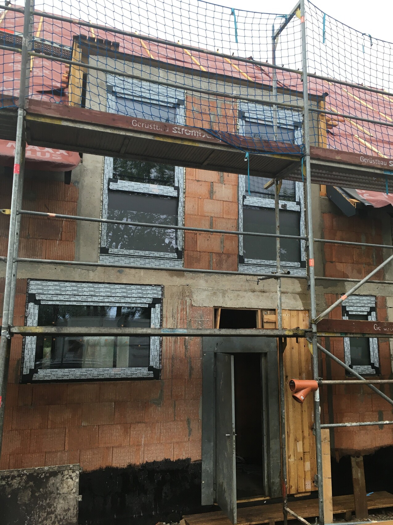

lin0r8729 Apr 2020 14:04
I have an update regarding the window reveals.... Everything seems to have gone well. An inspection took place and it was quite favorable in a positive sense.
The windows have now been installed.
Two-story house under construction with scaffolding, orange brick walls, roofing membrane, and safety netting.
Construction site with scaffolding and orange brick facade; a person is standing at the bottom right.
Construction site: two-story building made of red bricks with scaffolding, safety netting, and open entrance.
Multi-story brick building in shell construction, surrounded by metal scaffolding and ladders.
guckuck2
29 Apr 2020 16:22
It’s hard to see on the phone, but isn’t the external waterproofing layer still missing? I don’t see any membrane, only foam.
lin0r8729 Apr 2020 18:08
guckuck2 schrieb:
It’s hard to tell on a mobile, but isn’t the external waterproofing layer missing?
No membrane visible, only foam.
That’s true!
I just checked with my installer, and he said that a sealing tape on the inside is sufficient, combined with proper foam sealing on the outside.
The reason is that any remaining moisture can escape between the foam and the sealing tape (inside) instead of being trapped.
dab_dab
29 Apr 2020 20:57
That’s why, as far as I know, there are window connection tapes designed specifically for interior and exterior use. The exterior tapes are then more vapor-permeable than the interior ones.
That doesn’t mean it’s impossible otherwise; I can’t really judge that.
