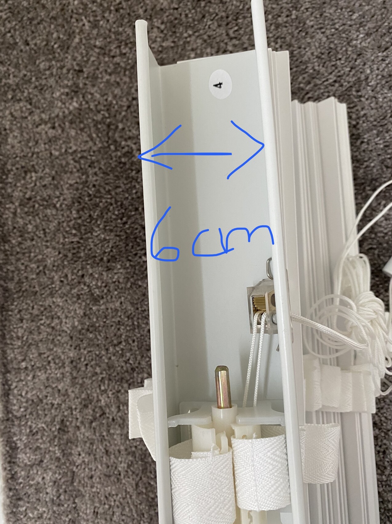

MiCasaEsSuCasa19 Aug 2022 18:33Good evening everyone,
I have a slightly different question, which I hope still fits in this forum:
I have these beautiful wooden blinds. Unfortunately, I realized too late that they can only be mounted on the wall (which is not possible for various reasons). Because the headrail is almost 6cm (2.4 inches) wide, so far I haven’t been able to find any clamp brackets to attach the blinds directly to the window frame. So my question is: Does anyone know of clamp brackets for 6cm (2.4 inches) headrails, or does anyone have other suggestions on how I could fix the blinds to the window?
Thanks in advance, and enjoy the evening and the weekend!

In the picture, the top profile is only moderately visible, but it appears to be bent inward by about 180° on both long sides.
If you insert a block of the appropriate width there, you can attach everything else to it.
This block could be cut and filed from wood or produced by 3D printing, if available.
