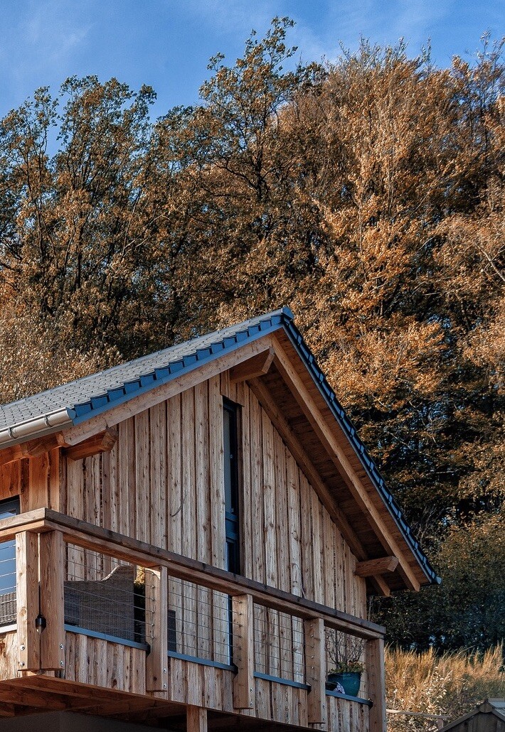

We had a similar discussion, and the muntin solution turned out well. There is an opaque panel that covers the floor of the gallery, which would otherwise have been visible from the side—see the end face in the photo.
