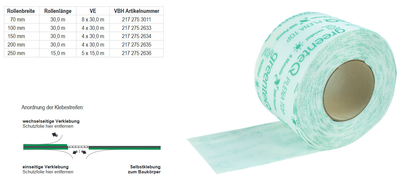

You stick the sealing tape onto the frame, there it is self-adhesive. Then a thick bead is applied onto the reveal, for example an adhesive from Illbruck, and the sealing tape is pressed into it. If you have handled a cartridge like that, you can already tell by the nozzle that a fairly thick layer of adhesive has to be applied; it has nothing to do with the 3mm (1/8 inch) gaps you know from silicone.
Masonry is not a perfectly even surface, so how should a self-adhesive tape ever be airtight there? At best, it compensates for 0.1mm (0.004 inch), if even that. Yes, the sealing tape is definitely self-adhesive even in the reveal area. It is the Greenteq Plena Top, which also has adhesive “reveal surfaces.”
I hope the inventor had a reason for that... but I’m not very familiar with it.
