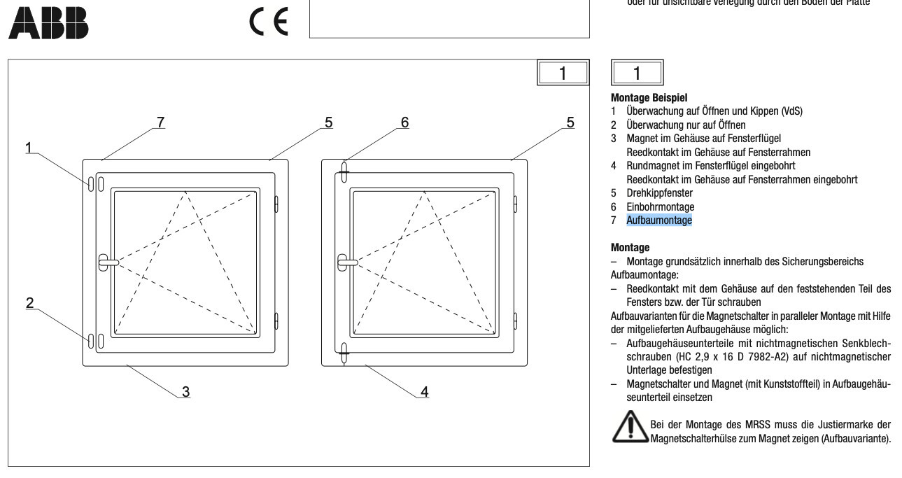

Bayernbors20 Nov 2023 15:09I am considering a similar approach and thought I could bring this old topic back to life.
Have you done this already? The reed switch is surface-mounted, right? How would the cable be routed then?
I am curious about how this would look from an aesthetic point of view.
I have seen this installation and operating manual from ABB for bore installation / surface mounting.
Hamburger2020 schrieb:
And can I install these magnets myself using a screwdriver? Drilling is not necessary?
