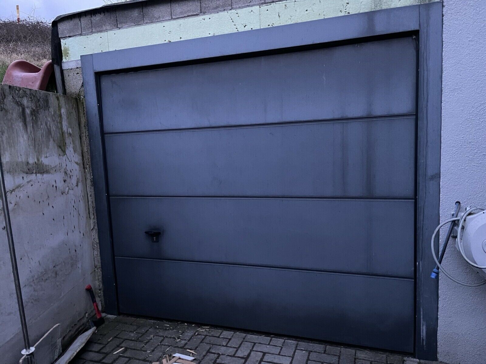

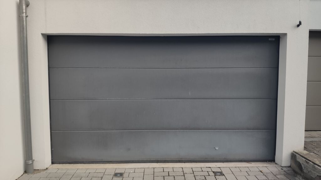

I looked online for some example pictures. These are definitely extreme cases and certainly not ideal examples, but they help illustrate what I mean by uneven fading.
As mentioned, this is quite extreme, but these kinds of discoloration patterns worry me. The lower door is probably DB703, powder-coated, and less than 10 years old 😱.
