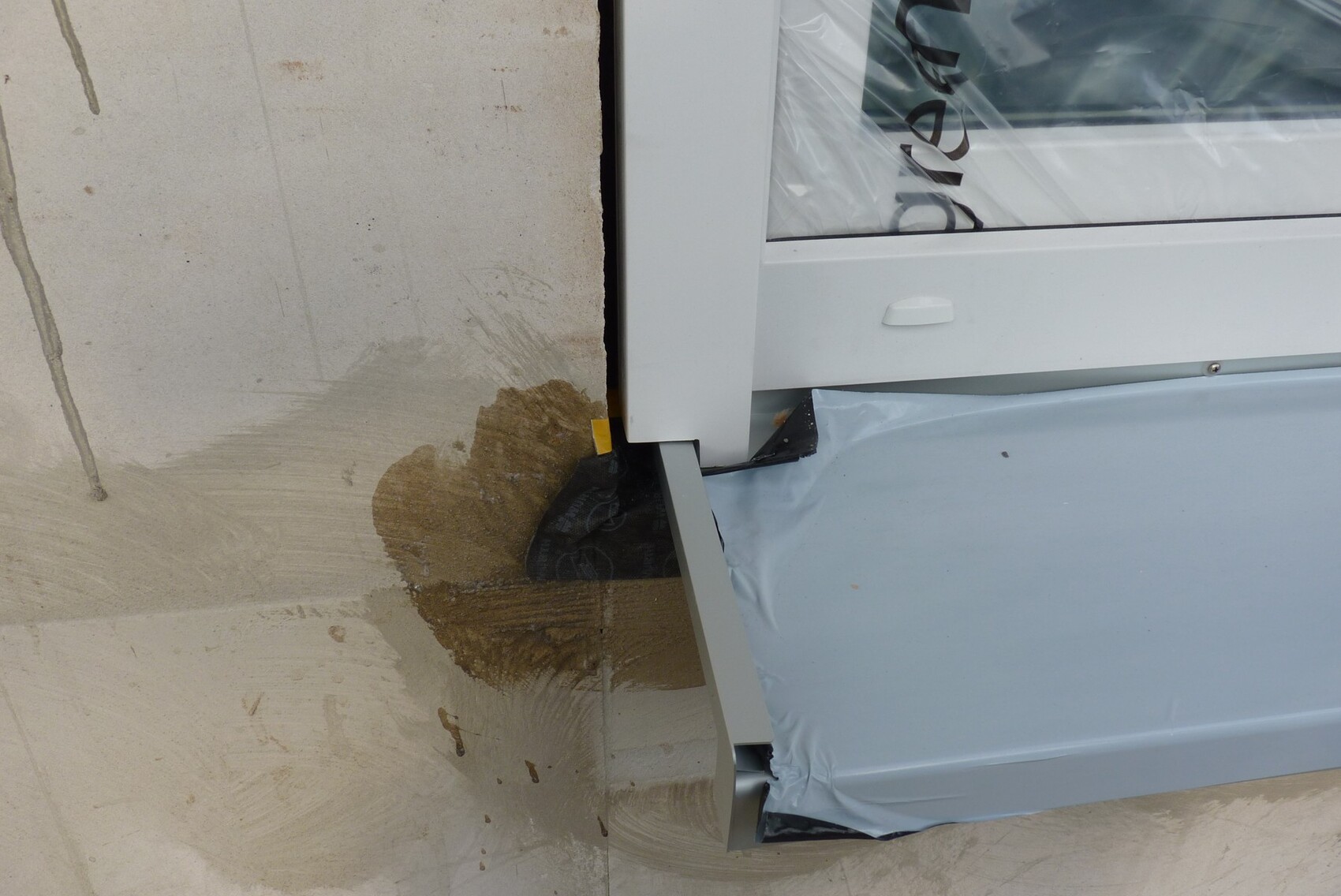

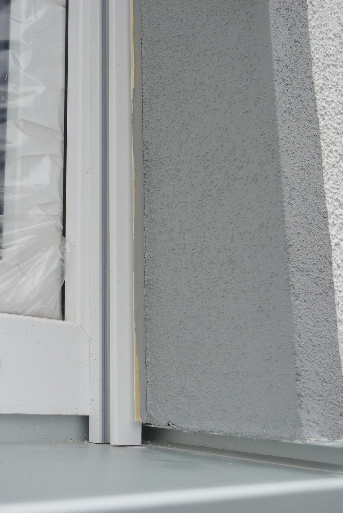

alter002922 Dec 2016 17:31I probably ended up dealing with an amateur group at the window company. As I was correctly informed, there is no seal between the roller shutter guide rail and the window sill. Yesterday, a technician finally came and wanted to fix this (6 weeks after the windows were installed). However, by now the plasterers have completed their work, so the window sill can obviously no longer be moved. Therefore, the technician was unable to install the seal. Today, I received the following proposed solution from the technician: "we will apply the seal you mentioned between the aluminum side parts of the sill and the roller shutter guide rails using sprayable sealant." Does anyone know if this complies with technical standards or if it is poor workmanship? By the way, I can only strongly advise against this company. Anyone looking for windows should keep well clear of the area around Kronau.
alter002929 Dec 2016 10:54Yesterday, the manager of a window company (which I was originally considering, but redtatoo strongly recommended Bechtold) visited our construction site. It turned out that the dimensions of the window sills are not correct. The distance from the drip edge to the raw plaster is less than 2 cm (about 1 inch). From the finished plaster, it should be at least 3 to 5 cm (1 to 2 inches). However, Mr. Bechtold will probably have an excuse ready for this as well. And the moral of the story: you shouldn’t rely on recommendations you find on the internet.
