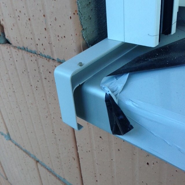

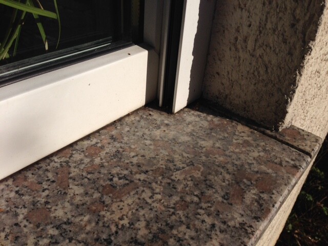

Hello everyone, does anyone know if it meets standard construction practices when the guide rail for the roller shutters does not extend all the way down to the windowsill? In our current house, it looks like the way shown in picture 7005. To me, this appears to be a proper job, and the other way looks like poor workmanship. Of course, I could be mistaken.

I’m not an expert, but the installation in the old house seems better to me. In my case (not a new build), the roller shutter guide rails also end just before the windowsills (like in your right picture). The way it looks in the left picture, I would be concerned that the bottom slat of the shutters might get jammed. In my opinion, a small gap is necessary (for water drainage, expansion due to heat), but no more than 5–10mm (0.2–0.4 inches). It’s hard for me to judge from the photo, but I think the gap in your case is larger (2–3cm (0.8–1.2 inches)?).
RobsonMKK28 Nov 2016 15:45
This is quite normal for metal window sills here at the house. They all end about 1.5 cm (0.6 inches) before the windowsill. As far as I understand, this has nothing to do with poor workmanship.
29 Nov 2016 11:42
This is not shoddy workmanship. This is how it is meant to be.

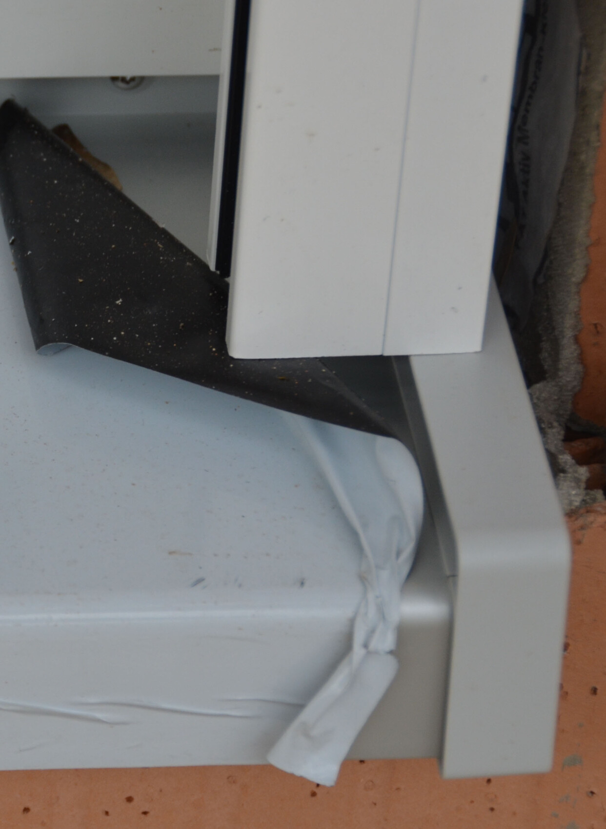

Today I met with a representative of the architect who is overseeing our new build. He brought guidelines for the installation of the windows. According to these, the distance between the roller shutter guide rail and the window sill should not exceed 8 mm (0.3 inches). In our case, it is 15 mm (0.6 inches). The photo shows how this looks on one of the windows.
Close-up of a metal window frame with tape on a brick wall.
Alex85
30 Nov 2016 10:11
Then you can argue about where the windowsill officially begins. After all, the guide rail isn’t just hanging in midair.
How did the architect’s employee assess the situation?
