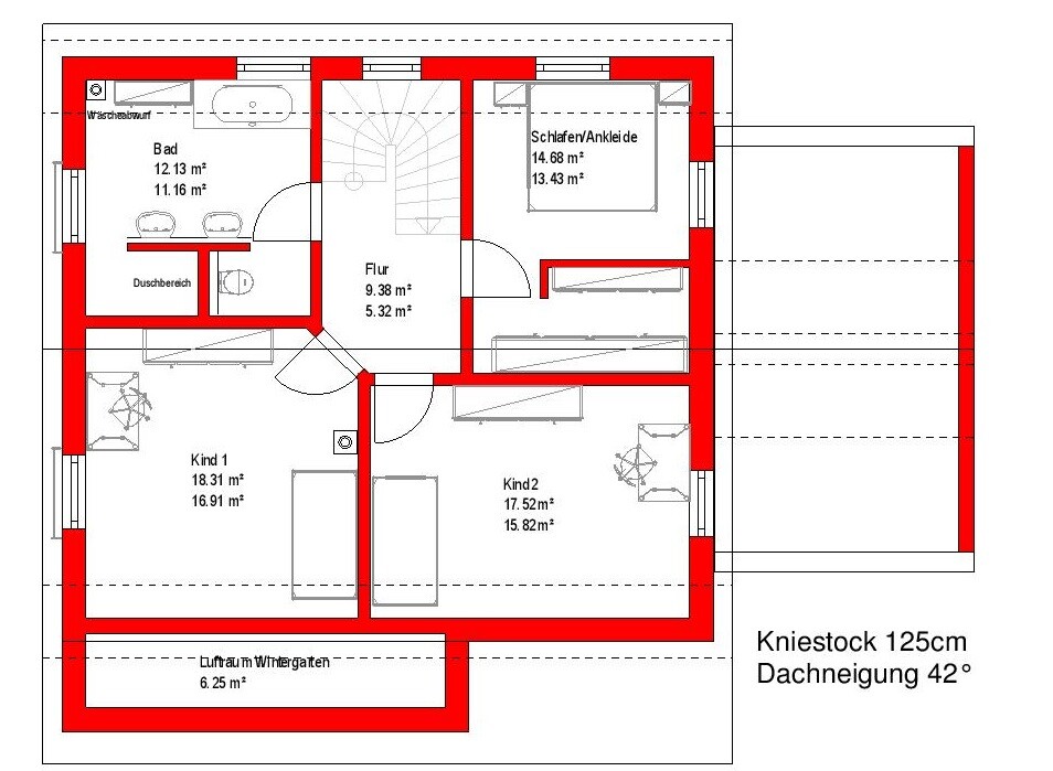

The guest WC window is planned to face north, and the floor-to-ceiling window in the upstairs bathroom will definitely be removed.

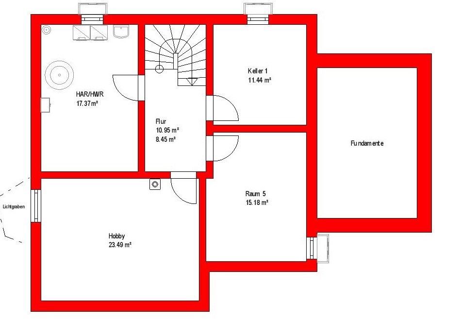

For this reason, the office will be moved to the 15m² (160 sq ft) basement room, as it is rarely used. However, I have serious concerns that the basement will become too dark. Since there will be a terrace on the south side, no light wells can be installed there. The large basement room is actually intended for social gatherings. The light well will still serve as an outdoor staircase. This means there will be no additional windows in that room, and the future office in the basement will also be quite dark because the garage restricts the window size.

The same applies to the bedroom. There is a window facing east, but it is directly under the garage roof. The narrow window on the north side will be removed as we do not like it. I think a skylight is necessary here. What do you think? Should we also consider adding skylights to the south-facing children’s rooms?

A house is being planned, and then an extension (conservatory) is added below because there isn’t enough space due to the office, and from the planner’s perspective, it is considered finished… Then the use of the rooms is rearranged. The annex remains because no further redesign takes place. Whether a utility room on the ground floor requires its 8 sqm (86 sq ft) despite having a basement is not considered.
The living room windows are blocked by furniture, so they could be fixed at ground level, but the terrace is planned across the entire front. Why? The practical exits to the terrace would be a corner door and dining area. This offers many design options for the other half of the house, including the elimination of some light wells.
I don’t see you having parties in the large basement room; due to the stairs leading to the garden, it is very likely that everything that doesn’t fit in the garage will be stored there.
Basically, the concept should be established BEFORE planning. Here, I don’t see one. There are also a great many planning errors incorporated: for example, the rules for window calculation have not been applied.

- You will never be able to place a bathtub in front of the knee wall window in the bathroom, or a bed in front of it in the bedroom. The knee wall windows sit right at floor level. I would skip these. They don’t add anything but visual distraction and limit your furniture layout too much.
- The children’s rooms will definitely be too dark. Either larger windows (which is not possible in one of the rooms) or an additional skylight, but please with a roller shutter.

I don’t see you having parties in the large basement room; most likely everything that doesn’t fit in the garage will be stored there due to the stairway leading to the garden.
For certain celebrations like New Year’s Eve, the room will definitely be used. Our old kitchen will also be installed there right away.

Yes, but in the future, you will also have a basement! The original office was in the nice, bright west side, now the space requirements are mixed up, with the utility room going to the west and the office moving into the dark basement.
May I ask who came up with this idea? Was the wardrobe originally missing, and now the builder or a lazy planner looked for a replacement, seeing the room swap as a solution?

You don’t seem to understand what I meant: if you plan an exterior staircase there, that room will automatically become a storage room – whether you want it or not. Sooner or later, you will be storing outdoor equipment there.

Child’s room 2: 17.5 m² (188 sq ft). Minimum 1.75 m² (19 sq ft), actual: (1.0 x 0.9 m) 1.2 m² (13 sq ft). That is too small.
The east-facing sun will likely not reach the school-age child’s room. Intuition suggests that a children’s room this size should have 2 to 3 m² (22–32 sq ft) of window area (about 2 m² for a south or west-facing room, 3 m² for east-facing).

If I were your planner, I would advise against the exterior staircase or at least include it in the design in a way that protects it from rain. Changing the garage roof would also be beneficial.
