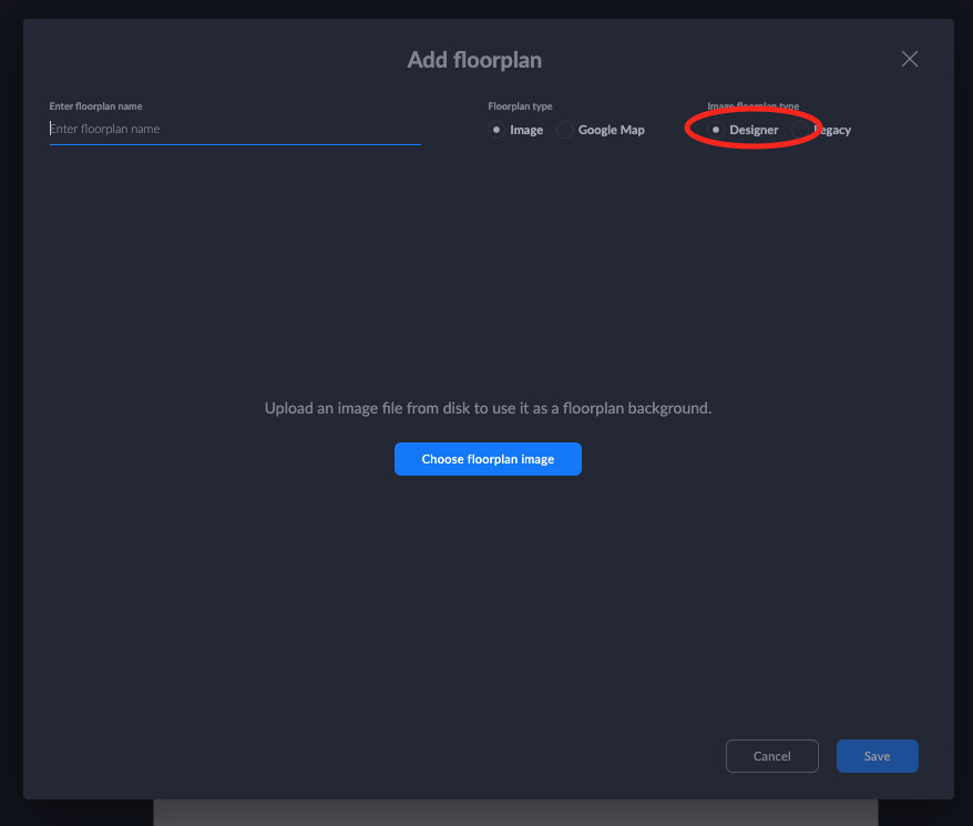

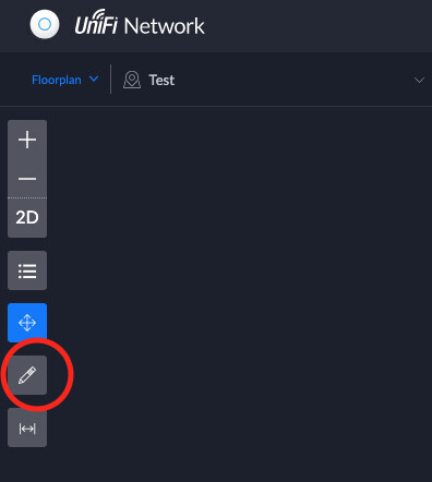

I can't check it myself, but you can find, for example, the following suggested solution if you use your preferred search engine: Thanks, I had already found that too, but this option doesn’t appear anywhere... :/
matte1987 schrieb:
Thanks, I had already found that as well, but this option doesn’t appear anywhere... :/Strange. I just tested it here in the office using the controller, and I do see this option. When I select it, I am then able to choose the 2D mode and draw walls. (Controller version 5.11.46)

opalau schrieb:
Curious. I just tested it here in the office on the controller, and I do have that option. When I select it, I can then also choose the 2D mode and draw walls. (Controller version 5.11.46)Since I had the controller software installed on my PC in the office before, which was always a bit annoying, I moved the installation to my NAS and also updated it from version 5.5.24 to the latest version 5.12.35.
Now the options appear for me.
