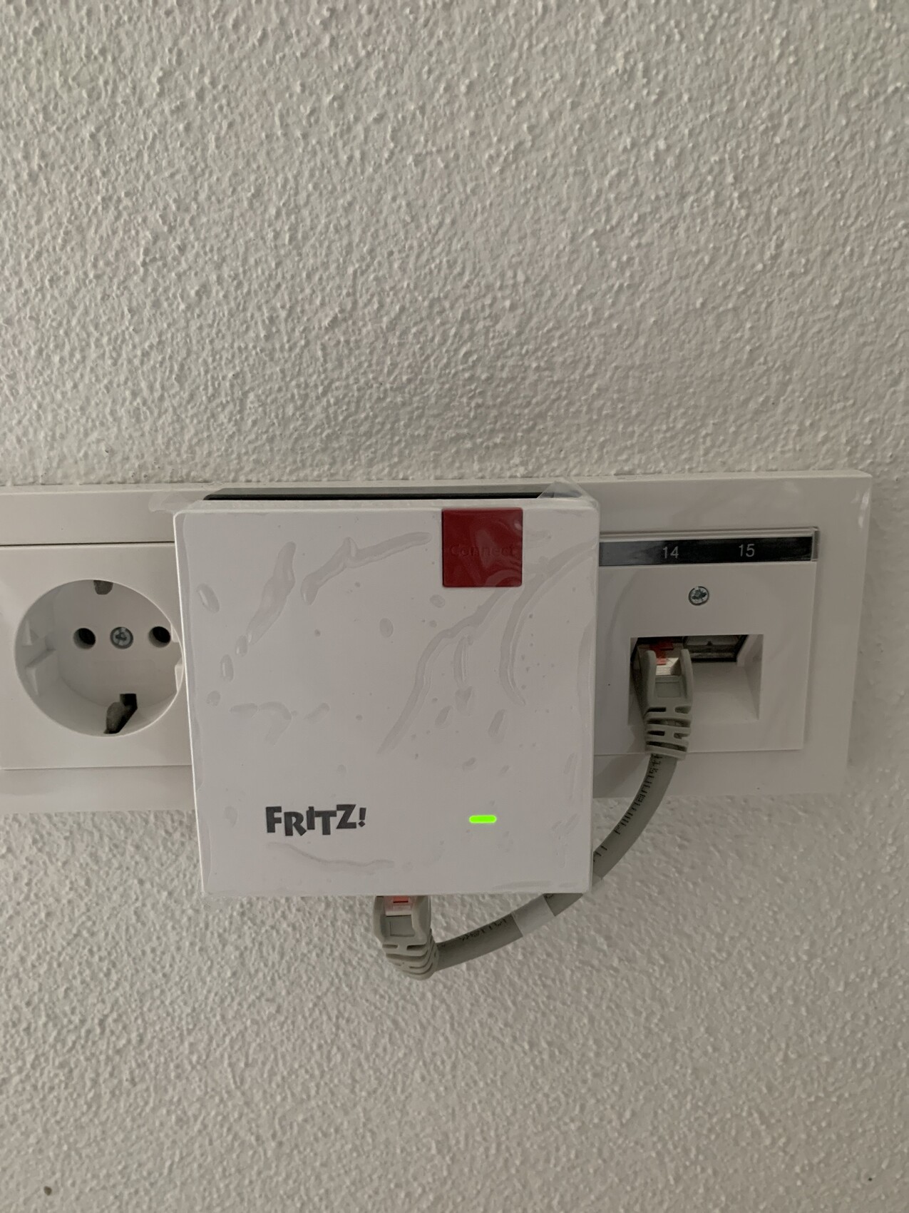

Allthewayup21 Jun 2024 20:17We also have a repeater (LAN) powered by a FRITZ!Box in the server cabinet, another router in the hallway on the ground floor (left over from the old house), and this repeater in the living room. This way, we also have Wi-Fi on the terrace and in the garden.
What is the issue, since you said you don’t want a device plugged into a power outlet? Then the only option really is an access point powered via PoE. But I assume that’s not available?
