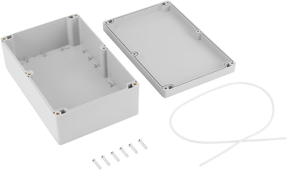

I am looking for a way to mount a UniFi FlexHD outdoors.
BUT: It would be within possible reach of hands AND located in a pedestrian zone (to illuminate the outdoor area of a restaurant), so it would need to be secured against theft. Additionally, the cable installation must come from outside (impossible through the facade), and the connection to the patch cable must also be protected against weather conditions.
My idea: To enclose the access point including the patch module, etc., in a visually appealing, sturdy plastic enclosure. Has anyone done something like this and could share information about a suitable enclosure?
Mount it high enough so that it cannot be reached directly. This also applies to the cable or the metal cable duct.
The access point can be screwed onto the bracket.
Boxes can cause problems with moisture and similar issues. Therefore, adequate ventilation must be ensured.
Since everything will be surface-mounted, a box is probably the neatest solution.
There is also the AC Mesh Professional. It is quite large, but the bracket is much more robust and the cable entries are sealed.
Here, you could attach a connector directly to the installation cable.

You could attach a connector directly to the installation cable there.If the house electrician installs the cable and does not follow the specifications, I have to accept whatever is there ;-)Above it, there is also a canopy (solid stone) projecting far enough that a higher-placed cable would be unappealingly visible. That’s why I can understand the electrician... I will try a box like the one shown below.
The damage (theft, vandalism) would be at most about 200 € (approximately 220 USD). And this is not a socially problematic area 😎
I just need to check if it looks acceptable (or not too ugly).
230 × 150 × 85 mm (9 × 6 × 3.3 inches), I will install the cable entry myself with a gland. I will report back later.
