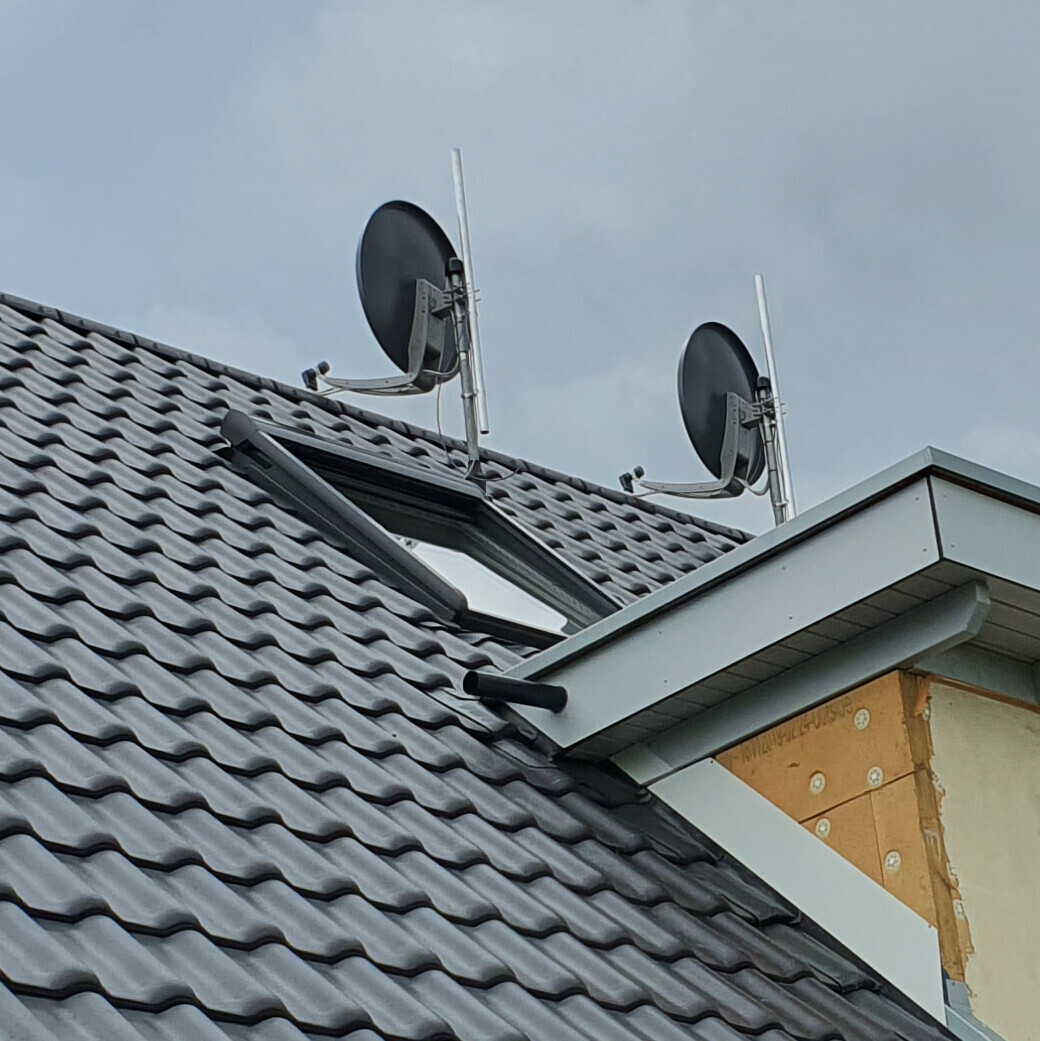

By the way, we are now installing two FlexHD units outdoors on a pipe attached in parallel to the antenna mast, which extends beyond the dish. This will also cover the seating areas at the front of the property. Close to the house (in the radio shadow of the roof and balcony), the terrace is served by a UAP Pro from inside the house.
I will probably be able to hide the installation cable and patch cable waterproof inside this pipe (under a cap). Nevertheless, I ordered 1 meter (3 feet) of Cellpack heat shrink tubing with adhesive to connect the Keystone module and patch cable waterproof. I don’t want to have to climb onto the roof regularly 😀
There is still space on the (adjustable) pipe for a weather station, which might be installed next year.
