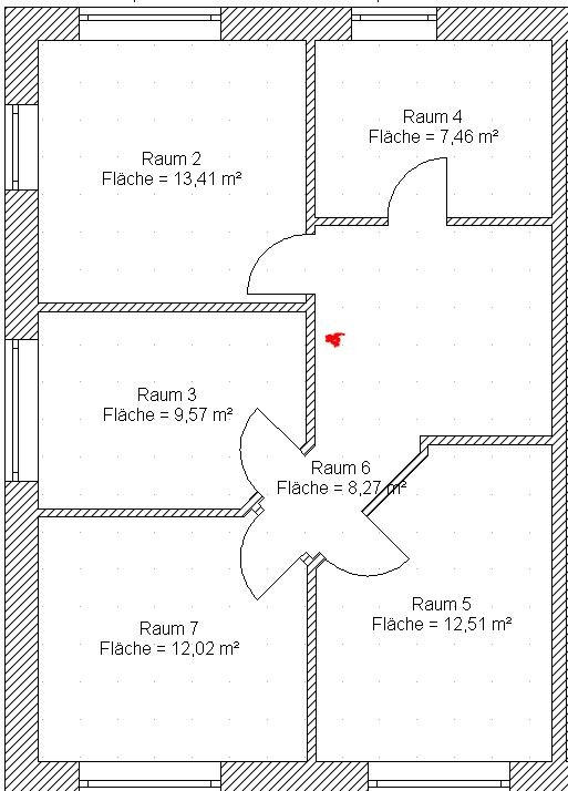

Yes, the access point is planned for the ceiling (let's see what the electrician quotes *cough*). See the attached floor plan (access point position in red). The drywall is between rooms 3 and 7. Rooms 2, 3, 5, and 7 are the open-plan rooms (bedrooms, office).

rick201813 Aug 2020 17:52
You just need an electrical back box where the LAN cable comes out. Attach a keystone jack to the LAN cable, connect the access point with a short patch cable, and mount the access point on the box. Clean, simple, and better than using a connector outlet.
I have another question about your floor plan. The drywall partition between rooms 3 and 7 is clear. Are there no walls between the other rooms, or is it as shown in the plan?
Given the size, you should at least have 2.4 GHz coverage everywhere. It also depends on your performance expectations. I would probably use two access points...

Yes, between all other rooms there are 11.5cm (4.5 inches) Poroton blocks. Room 6 is the hallway plus stairs.
I’m initially assuming light traffic, so no very large data streams or the need for low latency for gaming or similar. That’s what the network outlets are for. If that changes, then eventually a second access point would need to be considered.
Is the access point’s position okay? The drywall partition will be added at the very end, so I can’t measure it beforehand.
rick201813 Aug 2020 18:08
I would prefer a clean solution with two access points mounted on the ceiling.
But since you don’t have high demands, it will be sufficient.
I would position the access point a little lower to make it more central.
