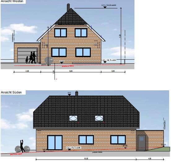

Knallkörper
16 May 2017 10:40
I have at least two views. At the moment, we are still waiting for revised drawings. The roof overhangs are not quite right yet, and we also have a few Velux windows in the attic, which is used as storage.

16 May 2017 10:47
Knallkörper schrieb:
I have an older floor plan here, unfortunately with the spot lighting layout, so it's a bit confusing. The kitchen and furniture were just roughly placed by the architect.
An example that clearly shows how designing in a longer layout works better. You can also see from the exterior view that wide windows don’t have to be squeezed into a narrow space.
Stairs fit better than in a square layout (not shown here), and it offers more flexibility in the living area. (Whereas with a square footprint, you usually have to shift things in both directions.)
Best regards in brief
