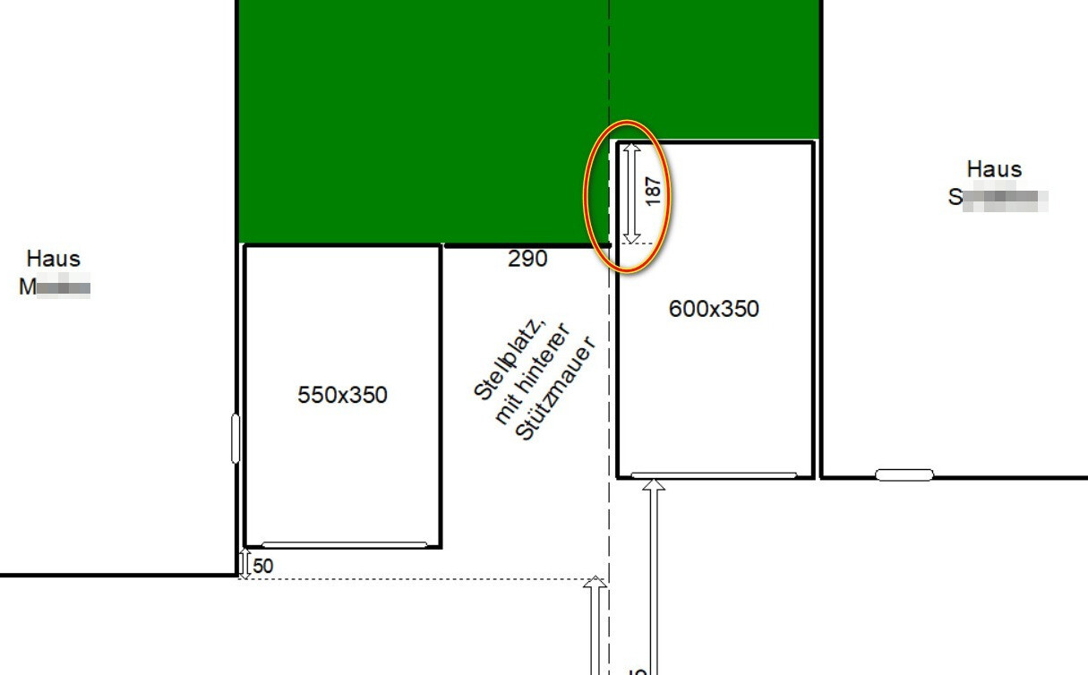

we have built and now there is some uncertainty about who is responsible for the costs of the necessary retaining walls (L-shaped concrete blocks) in the area of the garages and parking space.
For your information, there are two houses. The driveway area and house area for both houses have been excavated and are now at (let’s say) 0 meters (0 feet) elevation.
This is correct.
The area for the two garages and the parking space between the garages is also at 0 meters (0 feet).
Garage A is retaining earth at the back and will be backfilled with soil.
The adjacent parking space area A will have retaining walls at the rear, so that the garden area can be restored to the elevation shown in the building plan (let's say: 270 cm (106 inches)).
Neighbor A will pay for these retaining walls.
What is unclear is the area marked in red.
Retaining walls are also needed there, because the sidewall of Garage B is not earth-retaining and must be protected from soil pressure.
Neighbor A argues:
B must pay because the original elevation, as shown in the development plan (in the garden area), must be restored, and soil must therefore be replaced along the 2-meter (6.5 feet) area of the Garage B sidewall.
Neighbor B argues:
Neighbor A must pay for the retaining walls on the sidewall of their garage (2 meters / 6.5 feet) so that soil does not press against and damage their garage wall.
The replaced soil would damage Neighbor B’s garage.
What is the correct interpretation of the elevations in the development plan?
Does A have to bear the costs so that this elevation can be restored,
or does B have to pay because the red-marked area must be brought back to the elevation in the development plan at their expense?

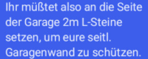

And, a small addition, I informed the neighbor kindly via messenger in December 2022 that 2-meter (6.6 feet) L-shaped retaining walls are necessary there, so it was not a surprise. However, maybe he never responded to my message due to certain intentions...
This completely contradicts his lawyer’s statement that they had "mutually agreed" on the new height level (meaning the "lower" level) as the new standard...

I can only repeat that it was actually clear to everyone that soil would be added there again, which is why both garages are designed to resist earth pressure (at the back), and our L-shaped concrete blocks are used at the parking space, with the always 2m (6.5 feet) L-shaped blocks on the sidewall of his garage shown in the drawings (which I also sent to him)….
