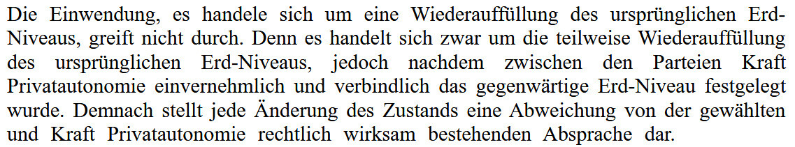

Received new "information" from the neighbor and their lawyer...
> ... after the soil was previously removed by mutual agreement ...
Sounds good, but actually only the necessary excavation for the garage foundations and space for the parking spot was done.
What is especially unclear to me is where we "formally and mutually agreed on the current ground level."
The soil was excavated accordingly, but no "agreement" between us regarding a "new height" or anything similar was discussed or made...
