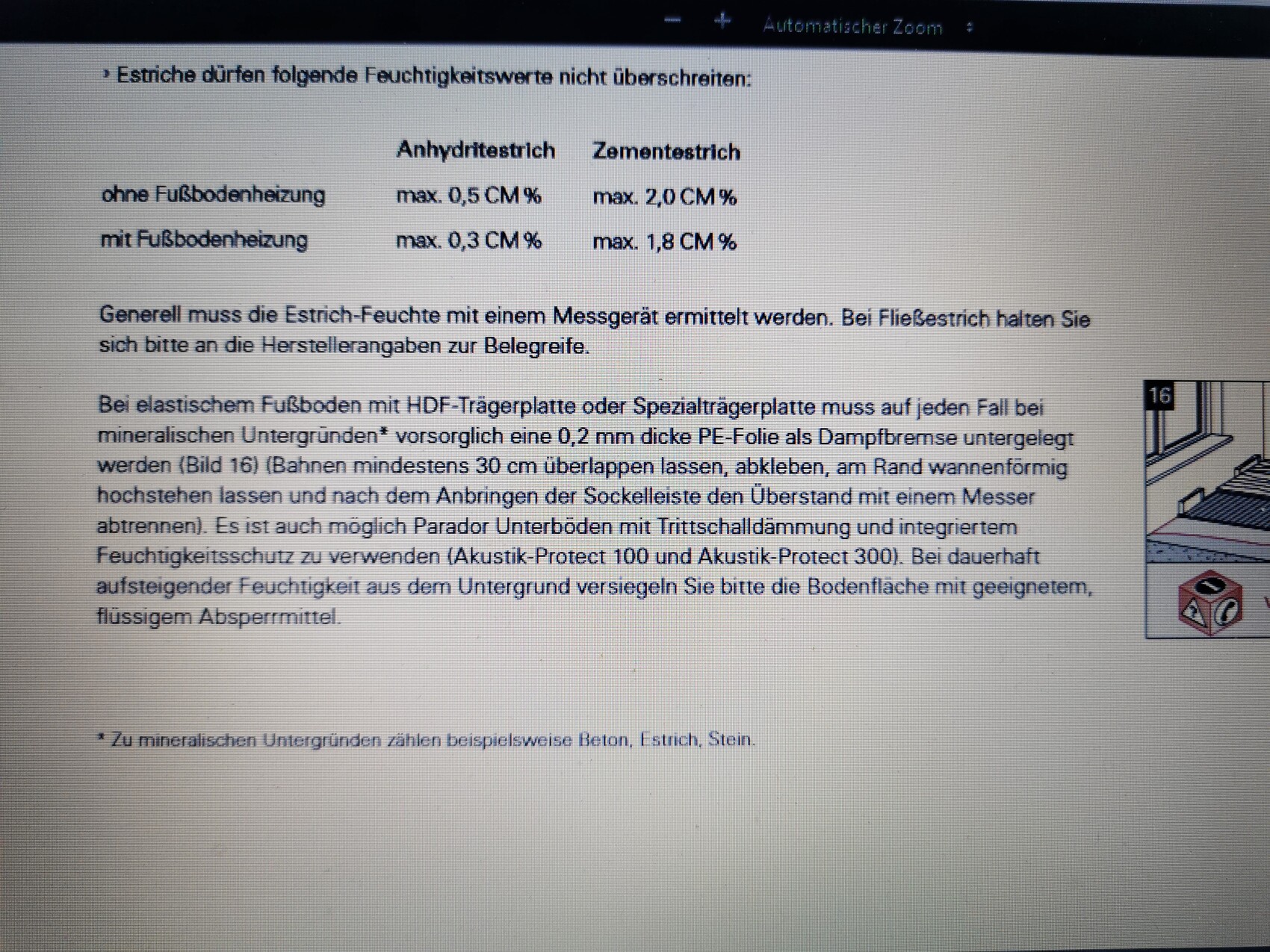

Wolfgang 40426 Mar 2020 15:55Hello,
Thank you for the quick response. I was almost expecting such an answer.
However, it is still quite frustrating that in all 3 installation videos, they use a 0.2mm (0.008 inch) PE film (also in the Parador video). According to the installation instructions, this is the standard recommendation, and the Acoustic Protect layer is optional.
Unfortunately, I will probably have to remove everything again.
This thread is also useful for other users.
In summary: either install with Acoustic Protect or, for rooms smaller than 16 m² (172 sq ft), bonding is also possible (according to Parador phone support)
