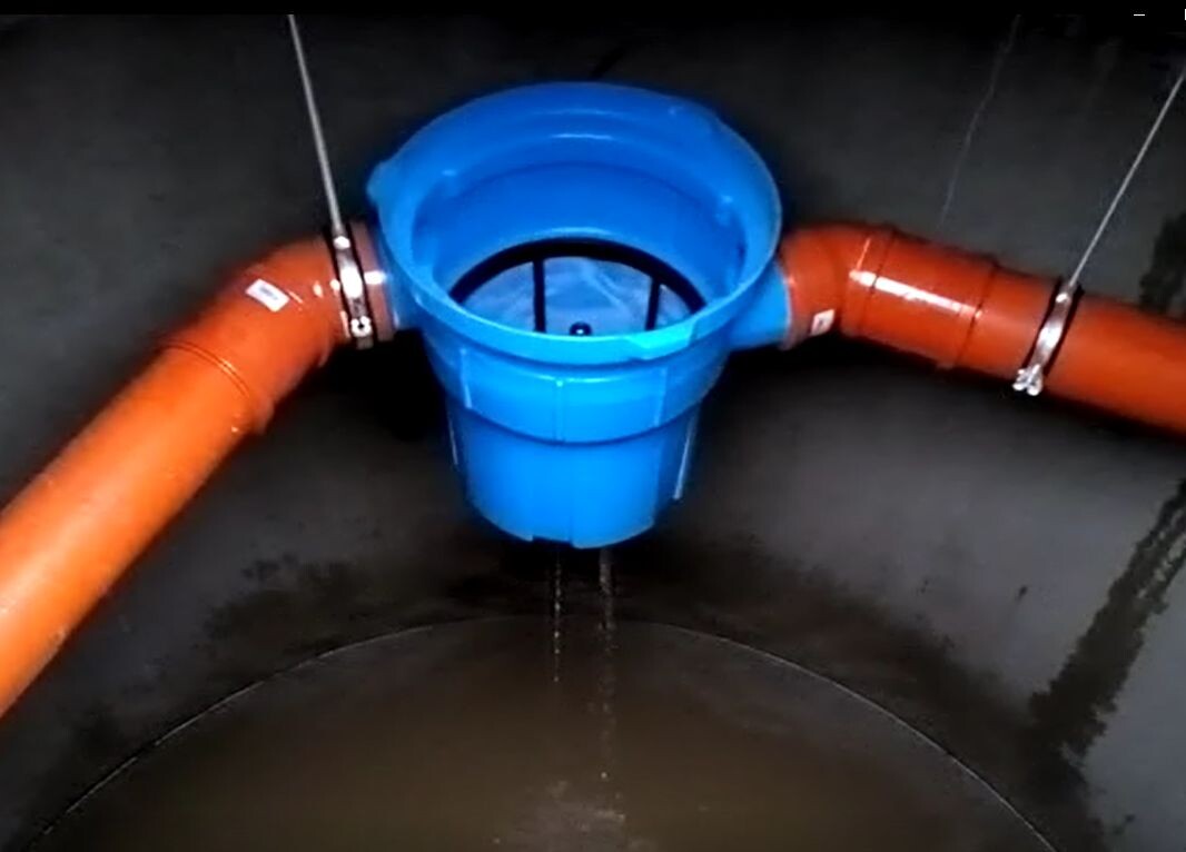

I also use a pry bar like that and check the system every couple of months. Our filter looks like this.
I attached a kind of fork to the end of a long rod. With this, I pull out the filter once in spring and once in autumn/winter and rinse it clean. The water from the cistern is crystal clear. All downpipes in our system have two filters installed: one at the top in the gutter and one near the inlet to the pipes. It works very well. I clean them twice a year as well.
