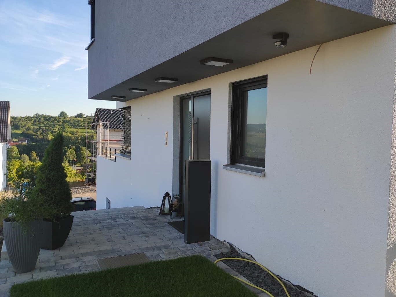

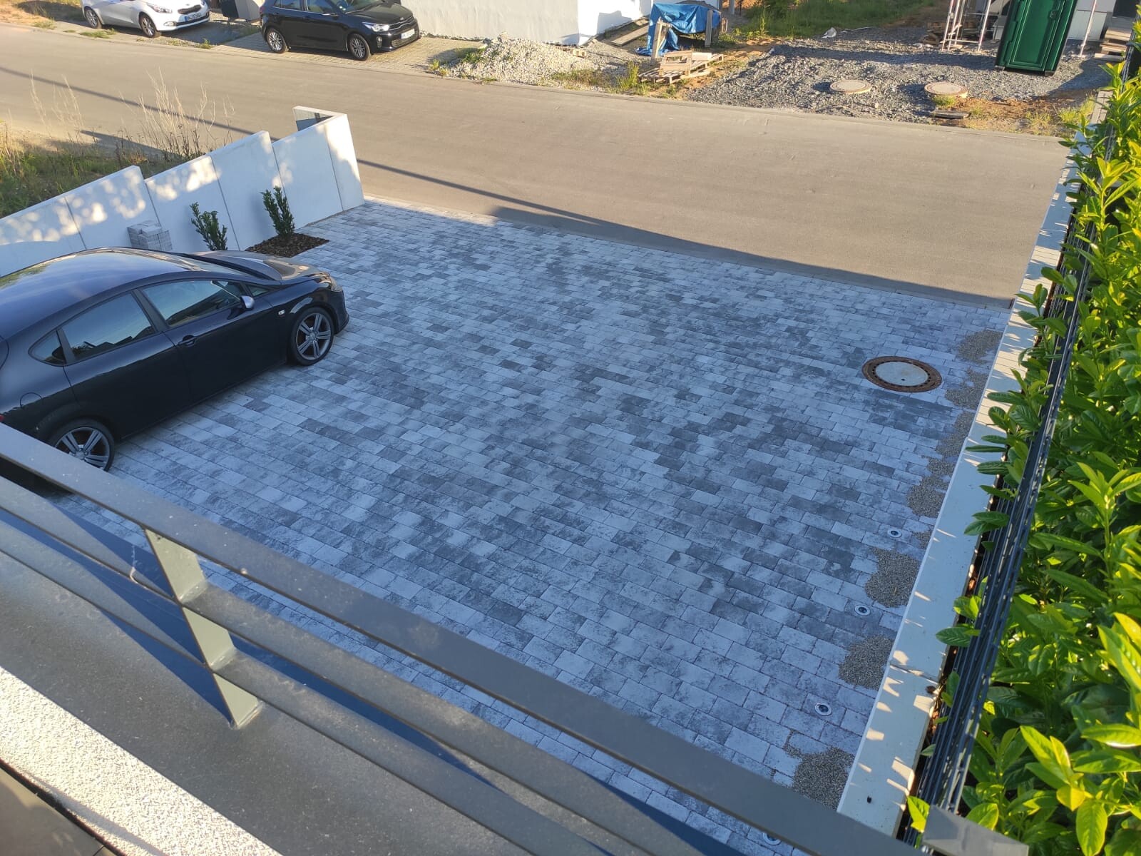

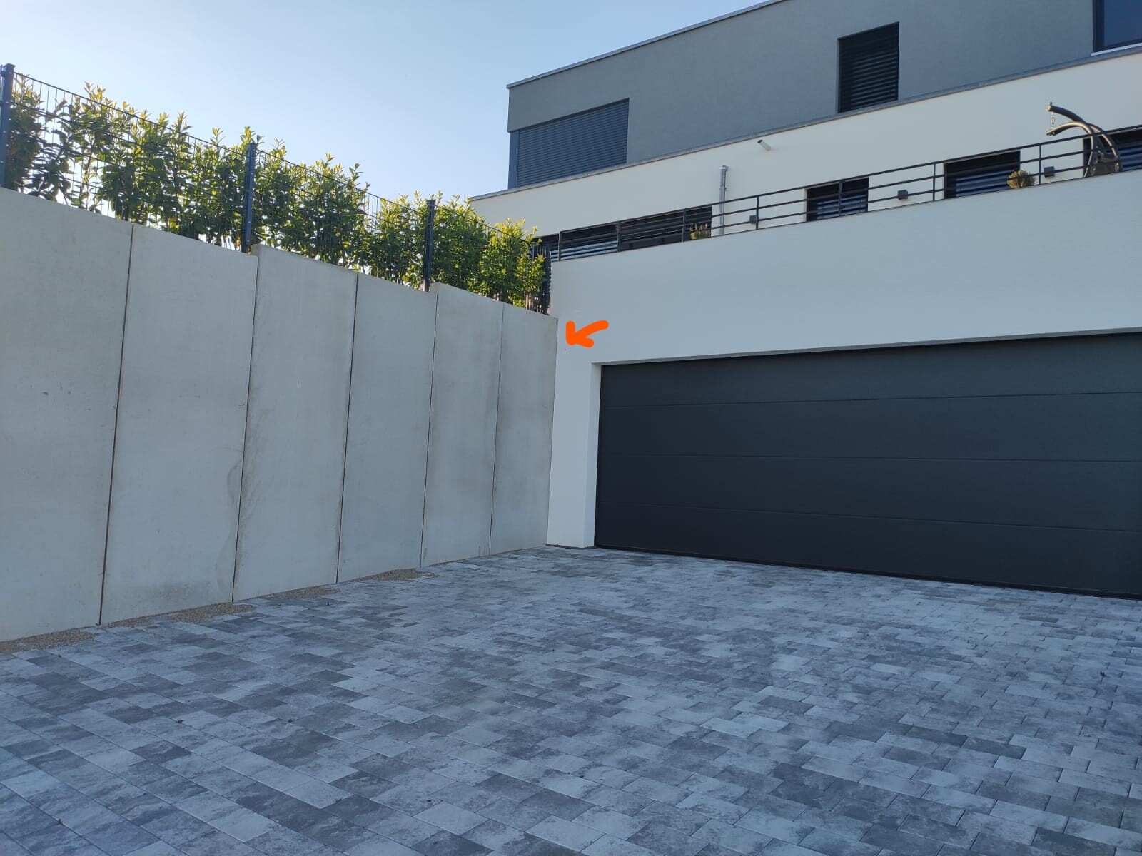

We are looking for an IP camera for our driveway and entrance area. The Dahua 5442 series sounds very promising. Therefore, I have planned an IP-B5442E-ZE for the driveway area. It will be mounted in a corner at about 2.50m (8 feet) height and should cover the driveway at a 90° angle. The range required is only 10m (33 feet). Is the bullet shape suitable for this, or would an eyeball model be better?

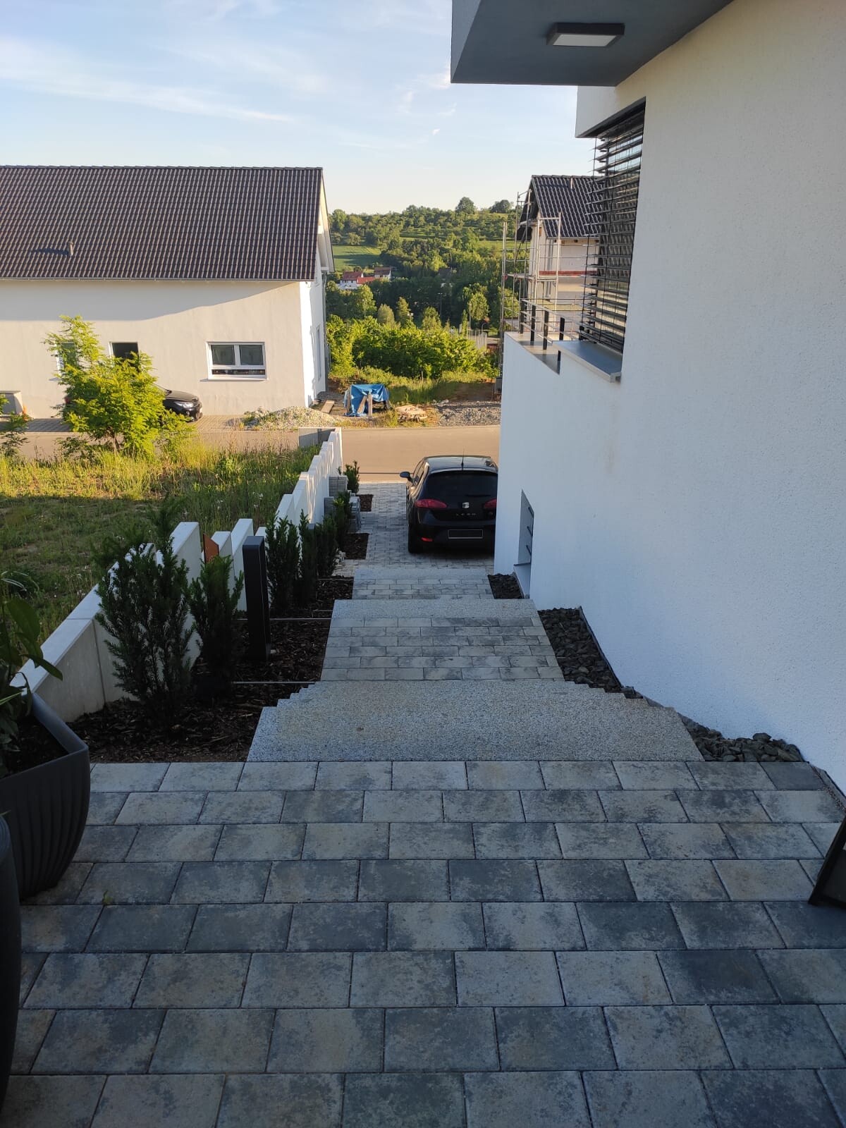

The entrance area is much more complex. Here, at least 180° need to be covered. In addition, there are several steps leading down quite a bit. The area behind the house should also be visible if possible. Is the IPC-HDPW5442G-Z suitable for this? Or how would you best cover this area? Unfortunately, I have only installed Simplex CAT cable as you can see in the photo.
